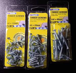

    After the spate of recent horror stories about stock kit screws breaking I decided to replace mine with something sturdier. Real Parts was out of stock of a few sizes that I needed, so I went to the dread green shed:

    As near as I can measure, and recognizing that since I haven't drilled pilot holes I have more leeway, these should do for pickguard/jack, bridge, and neck. I know they are zinc plated not nickel or chrome but they should be a lot sturdier. Plus a pack of 50 was the same price as ~8 screws from Real Parts.
    Other progress since last post has mostly been in the pedal building area, but I have filled the chipped lacquer on the neck (not perfectly though, but enough to stop it worsening) and applied a bit more CA to some fretboard spots that needed it.
    Not ideal screws, as they aren't the normal dome head countersunk type. Also more for softwood rather than hardwood with those coarse threads.
    Hmm, I matched them to the ones that came with the kit, and the thread pitch looked quite similar. Admittedly I didn't measure the pitch as the battery in my digital calipers is flat. Or by "coarse" are you referring to the thread depth (outer to inner radius) rather than pitch?
    It's a basswood body if that helps, which I think is quite a lot softer than ash or alder. Oh yeah, except for the maple neck
    I agree there is no dome head, but isn't that more for appearance than structural integrity? And to prevent sharp edges if the screw isn't perfectly straight?

    I'm using similar for the bridge on the 'Mustang' The size is 5G 15mm.
    Probably not the ideal, but geez luxury after the cheddar cheese one's they replaced.
