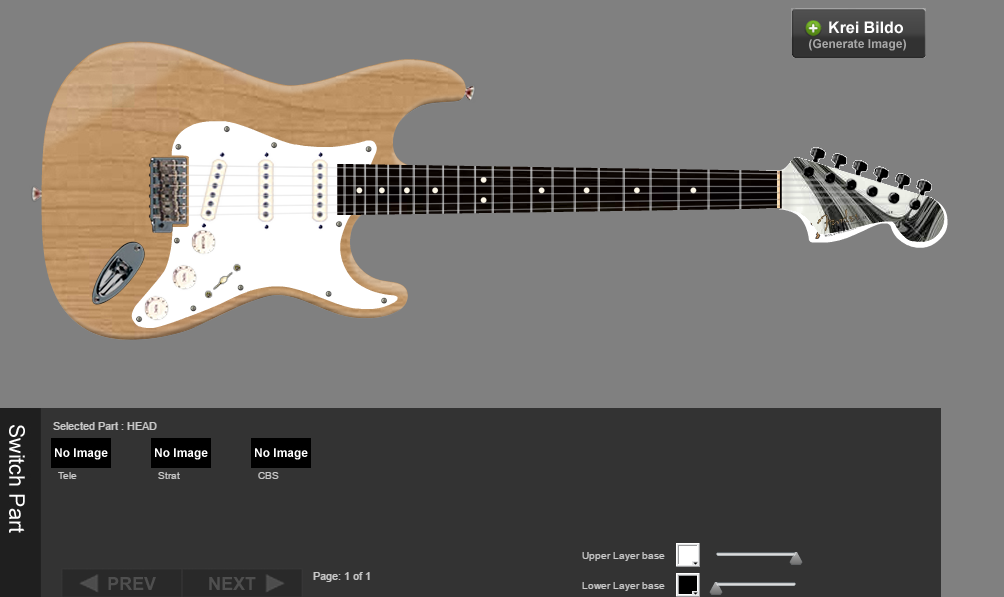

    I've also had a little extra thought for an idea with the headstock. I'm thinking I might make it tiered, example below
    Buut, I was thinking swirling the top tier, and just leaving the bottom tier plain white. And also using the CBS and modern Strat headstock sizes as the tiers. Mockup example below:
Name:	cbs w + inline.png
    It doesn't look like it'd add much there, but with a slightly black-leaning swirl, and 3mm or so of depth I think it could add a nice little outline effect to the headstock.

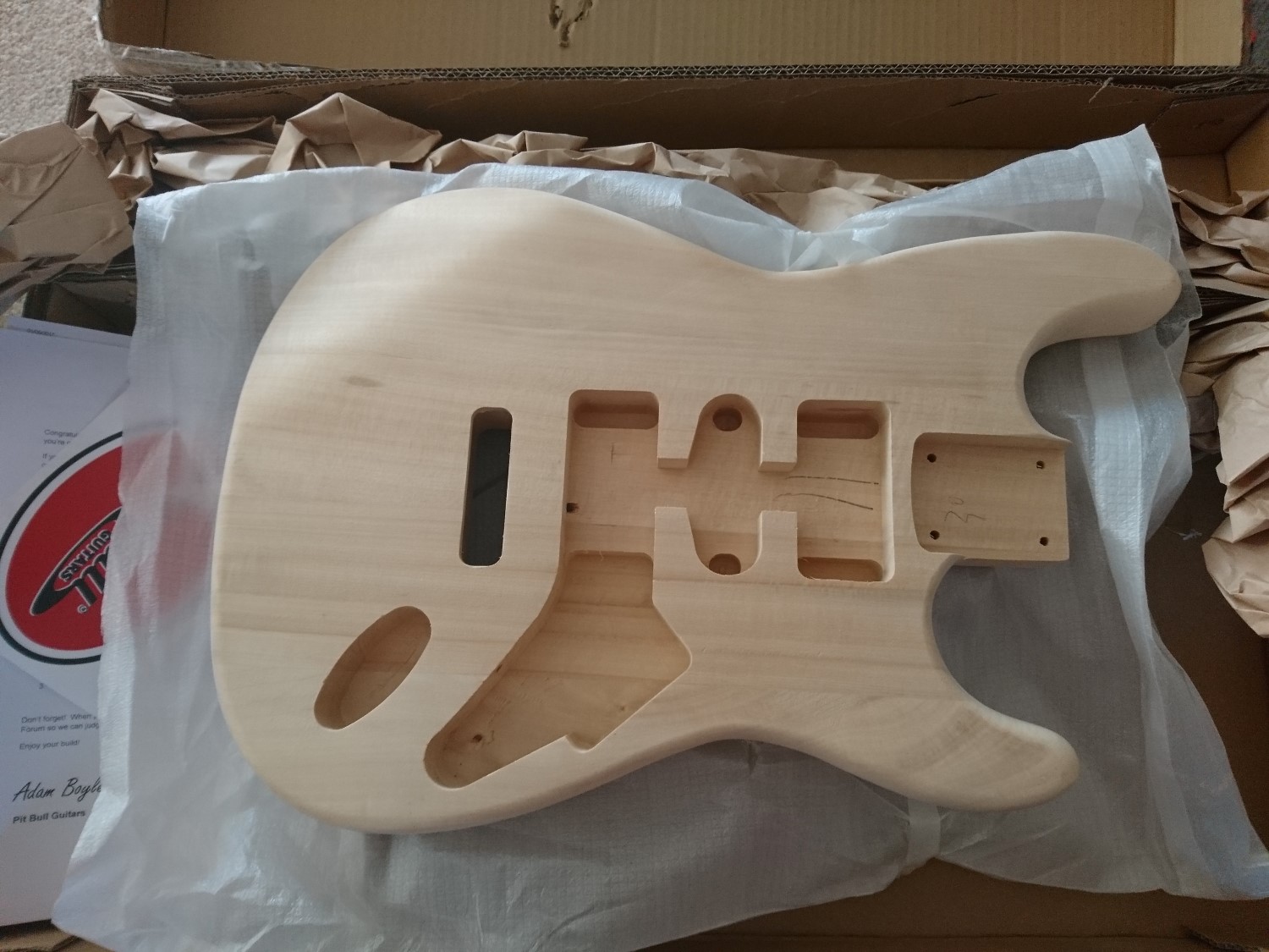

    Alrighty! Kit arrived today!
Name:	DSC_0226 (Custom).JPG
    I was intending to say something like "ha look at this no hardware" but for some reason it was packed with a hardware kit for an ES-3 kit (Gonna be sending that back when I can though)
Name:	DSC_0228 (Custom).JPG

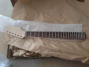

    Anyways, I opted for no hardware (because pretty much all I'd use stock is the tuners, so I'll just grab a set when I get my Floyd) and no loaded pickguard because I wanted a totally different material, and still haven't decided on pickups either
Name:	DSC_0227 (Custom).JPG
    I did opt for a 22 fret neck upgrade though. It feels a bit thin for my liking (I am only properly happy with a super fat neck admittedly) but I'm gonna try stacking a few veneers along the back of the neck to fatten it up (and will swirl the whole neck to cover it up)

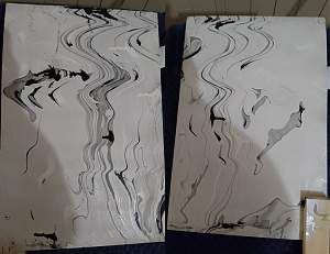

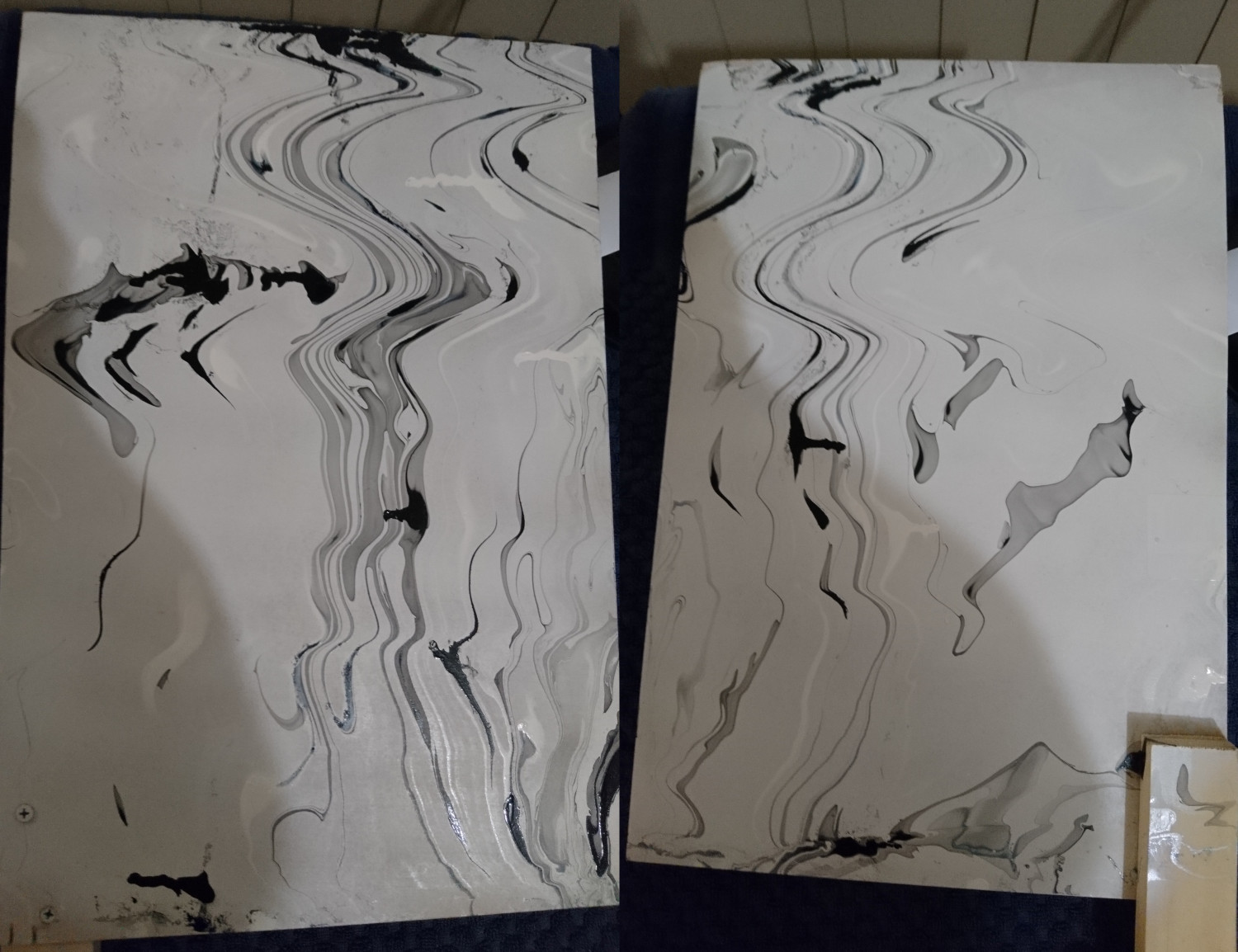

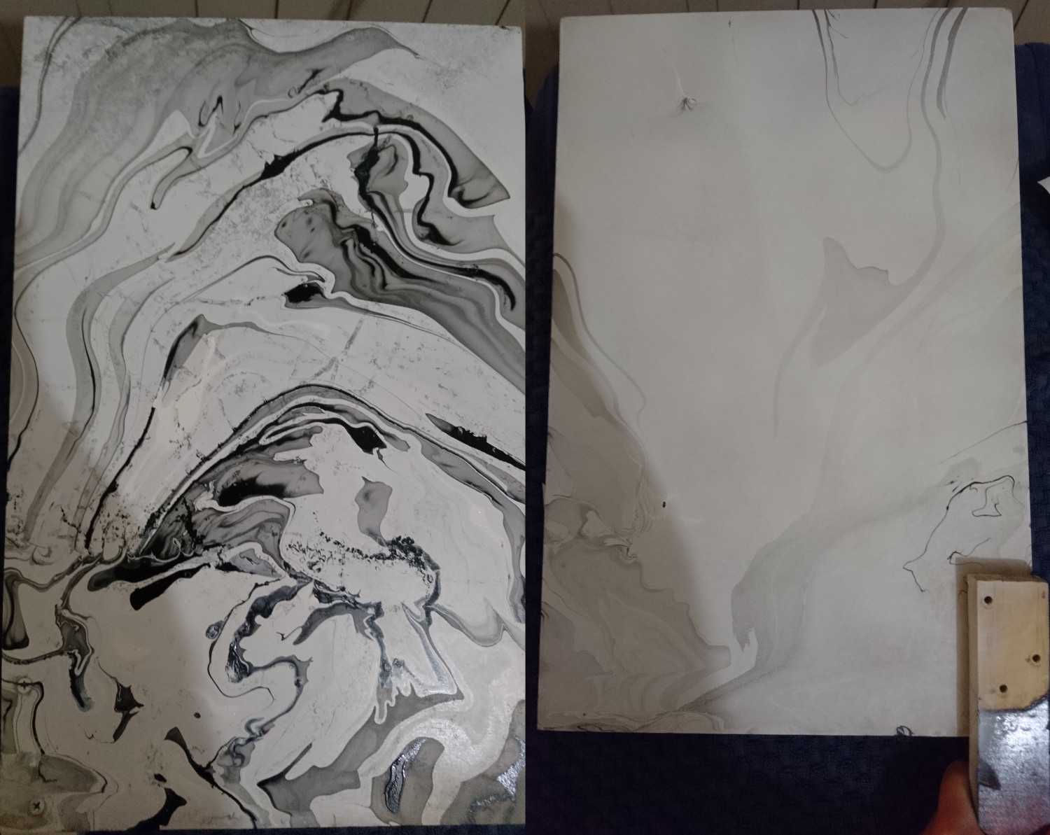

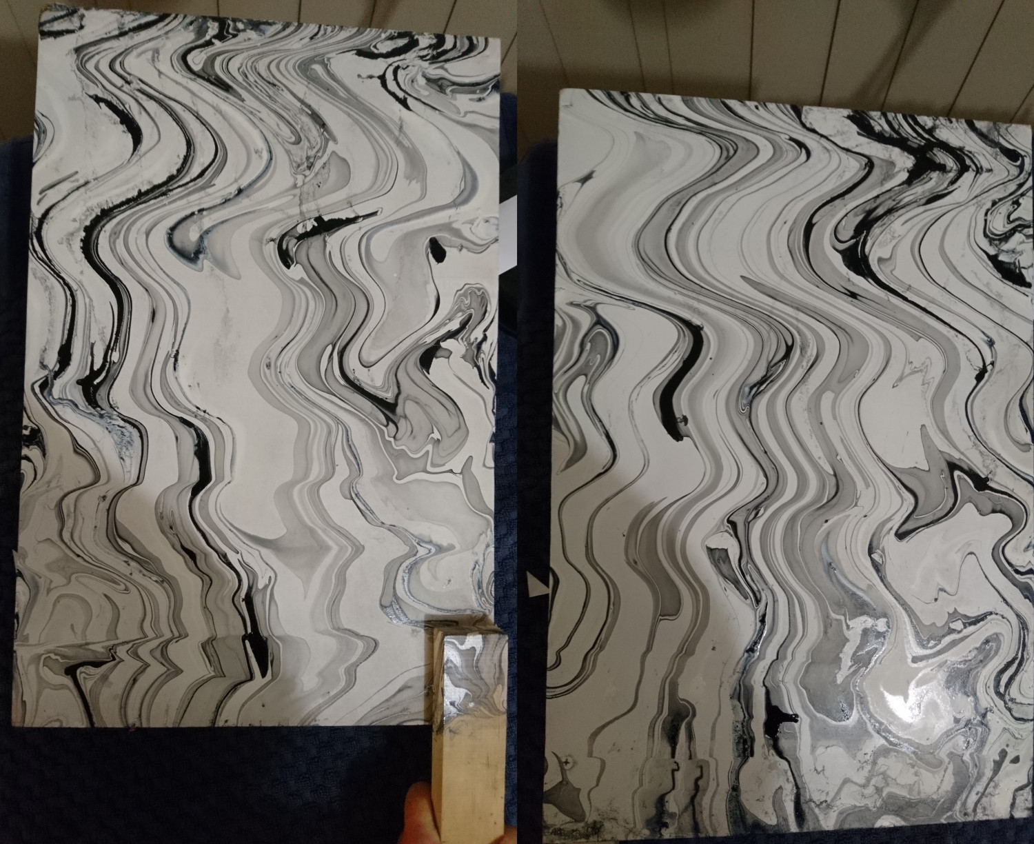

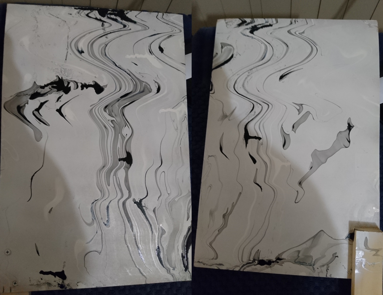

    So today was test day. I had a couple of false starts because I had originally planned to use Magic Marble paints, since they seemed pretty foolproof, but they ended up lost in my house then the paint separated, and using them to swirl just didn't work.
    So we went for the one that most people go for, Humbrol Enamel and Borax.
    And here is the results of my three test runs. On each test, the Left side is the one that was angled face-down in the water:
Name:	Test 1 (Custom).jpg
Name:	Test 2 (Custom).jpg
Name:	Test 3 (Custom).jpg
    And an Imgur link for full size pics: https://imgur.com/a/BRIzGqM
    So one thing that happened a couple of times, the wispy black parts you see, particularly across the face-down side of test 1, and the handle end, face-up side of test 3, that was not clearing out the excess paint off the top of the surface properly before pulling it out of the water. I was just really lax with the first one because I was getting my bearings, and on the third it was because I just hadn't given myself quite enough water to work with properly.
    Nonetheless, particularly happy with the third one, I feel like I finally got the hang of how much black I actually want/have to use by that point, as well as a better feel for dropping it all in the water. How high, how much, how to distribute it.
    Unfortunately though, I used all the white I had for these tests. I'm not super surprised since they're only tiny tins, but unfortunate nonetheless. So gotta wait a little to order some more in.
