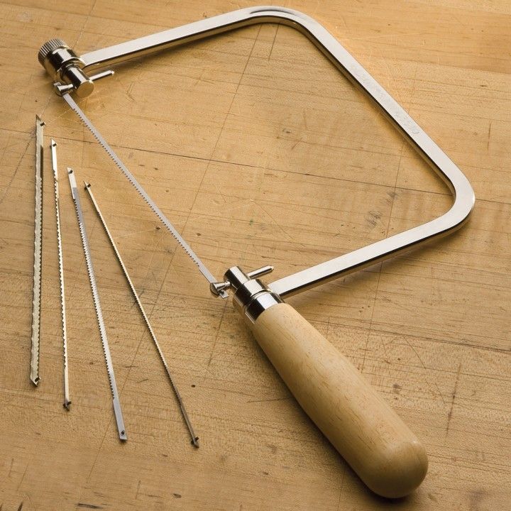

    What would be the best way to cut the headstock? was thinking kind of like a strat headstock.
  6. #16
    2,824
    Quote Originally Posted by S.W.A.M View Post
    This works well for me
  7. #17
    As long as it has a sharp blade.
