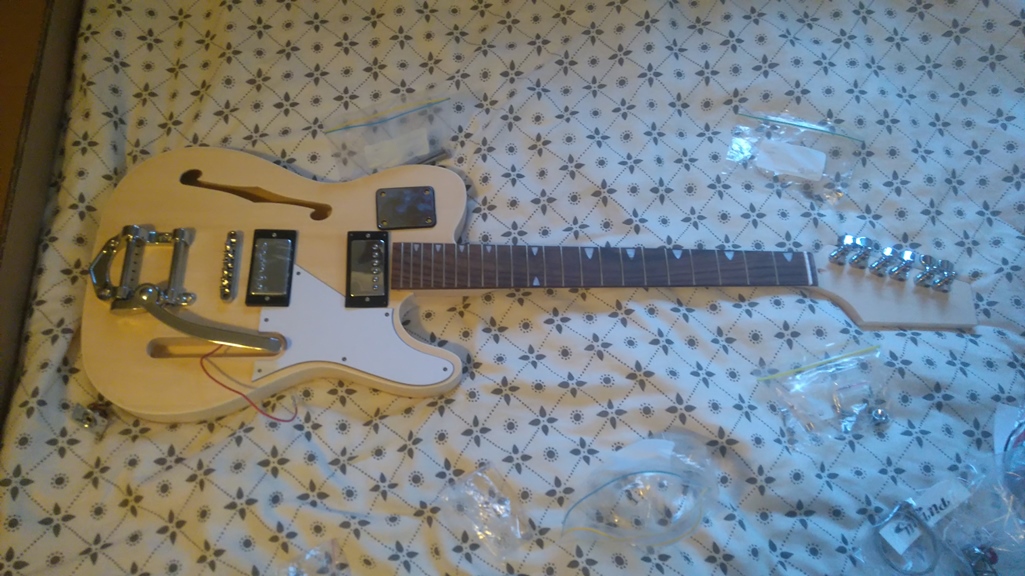

    So as a birthday present a bunch of my mates went in on this kit for me.. I may delay this one a bit in favour of finishing my Yb-4 however I've always wanted a guitar with a bigsby (the first guitar i wanted was a Gretsch streamliner) so I'm incredibly happy. I have a small issue though. When I was doing a mock-up build I realised the kit was missing the control panel. How should i go about getting this fixed?
    Anyway I'm thinking of doing the guitar in an uluru red body with an acacia neck (both dt obviously). Thoughts?

    So this is the mock up build.
    Hey Segway, email Adam at PBG and he should be able to send you out a control plate with switch and volume/tone knob/pots. Have you got a jack plate and jack ?

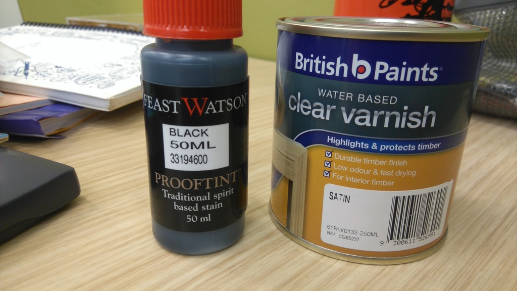

    Picked up the missing control plate from the post office today. Finally the kit is ready. On the walk back home thought about the guitar and totally changed my plans as far as staining. I'm thinking of doing a weathered look body and head-stock top (i saw that it's possible to do a chemical stain with vinegar and steel-wool) and a walnut stain on the back and sides. I heave the following feast Watson walnut stain
    Would this be good. As I said I've seen the weathered chemical stain with SW and vinegar, Has anyone done this and can give me any pointers? Lastly what final coat should I use (not a massive budget btw)? Thanks in advance
    Hey Segway,I have used FW prooftint stains and had good success with them. Walnut is a nice shade of brown. Have never tried the weathered look with vinegar and steel wool. Maybe you could do the whole body in the FW and just sand back the top a bit to make it look weathered. For the final coat you could use DT final coat if you have any left. Otherwise (DB will shoot me for this haha) tru oil or FW do a wipe on poly, otherwise a rattle can clear coat.
