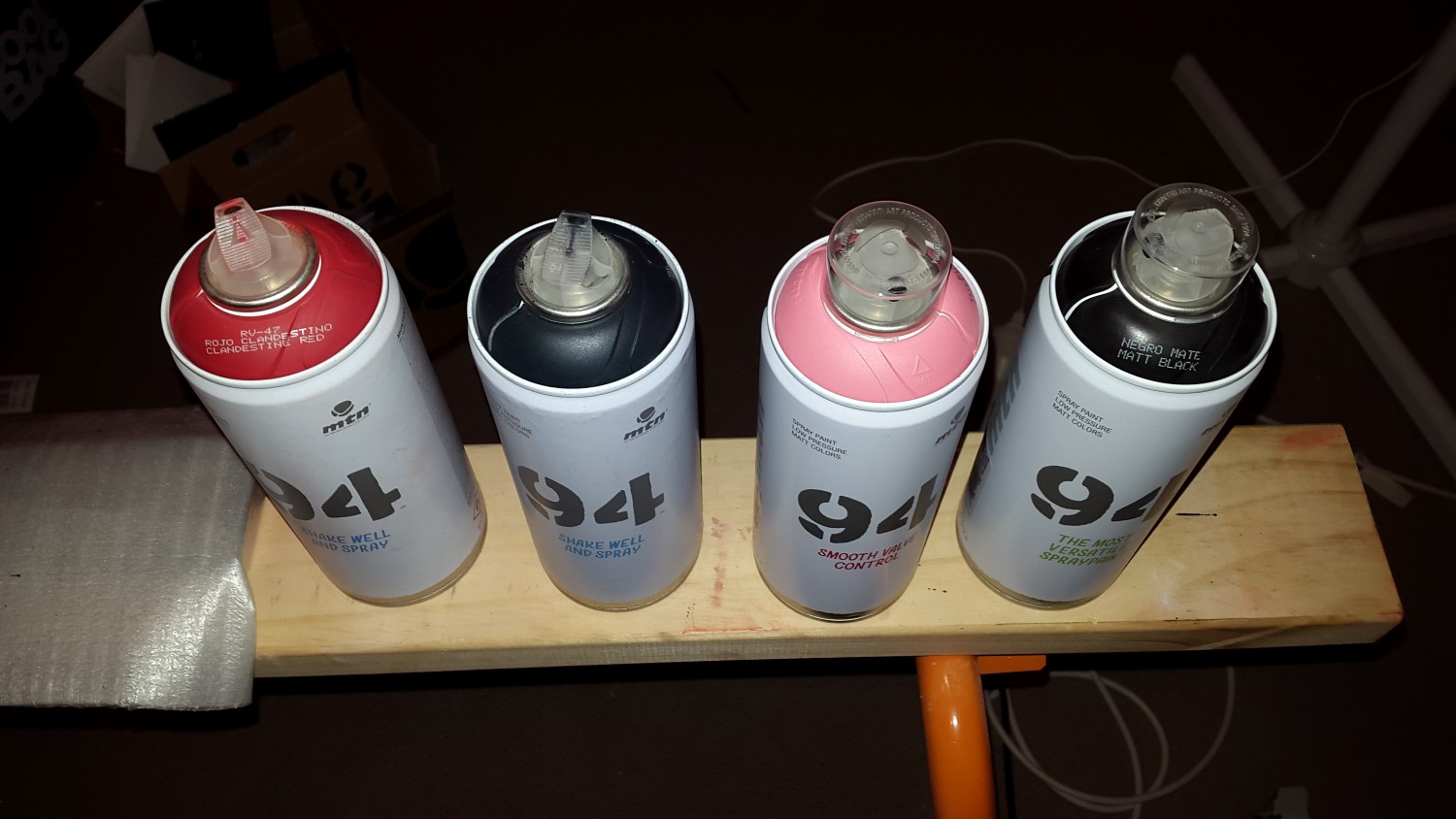

    Now the paints I'm using were recommended by Gavin on the forums (thanks for that man, they're working well so far). I'm using White Knight Rustguard primer, MTN94 colours, and I can't remember the clear because I haven't had to buy it yet, but that's ok.
    The exact colours are Clandestine Red, Metropolis Grey, Tutti Frutti, and Black.

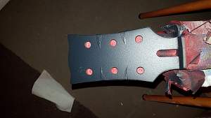

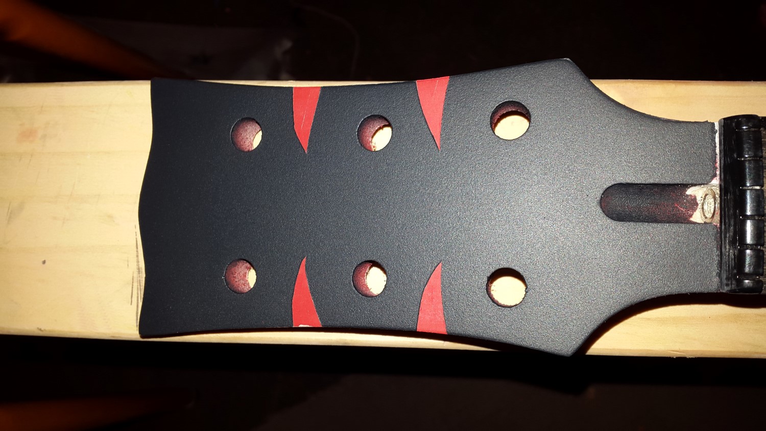

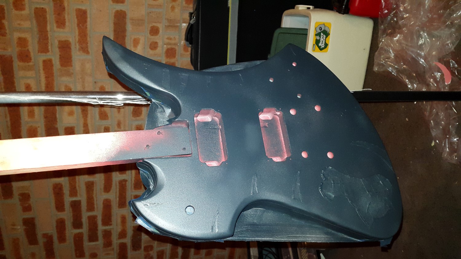

    Thankfully, I actually did a decent job! I was half expecting bleeding everywhere because I've never done this before and my finesse with all of this little tricky stuff is... not really there at all. (Admittedly I'm still very worried about the white that I won't be unmasking as yet so that worry's gonna be staying a good few more days.

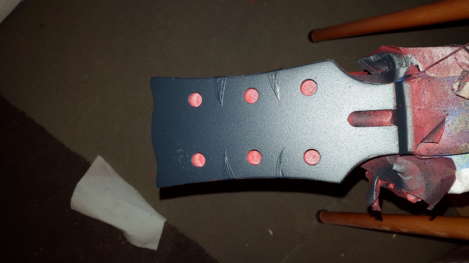

    The headstock came up fairly nicely, aside from one little nick in the top left marking, but that will get touched up fairly easily. Naturally will have to sand back a bit to clean up those edges too.
Name:	028 Headstock Unmasked (Custom).jpg

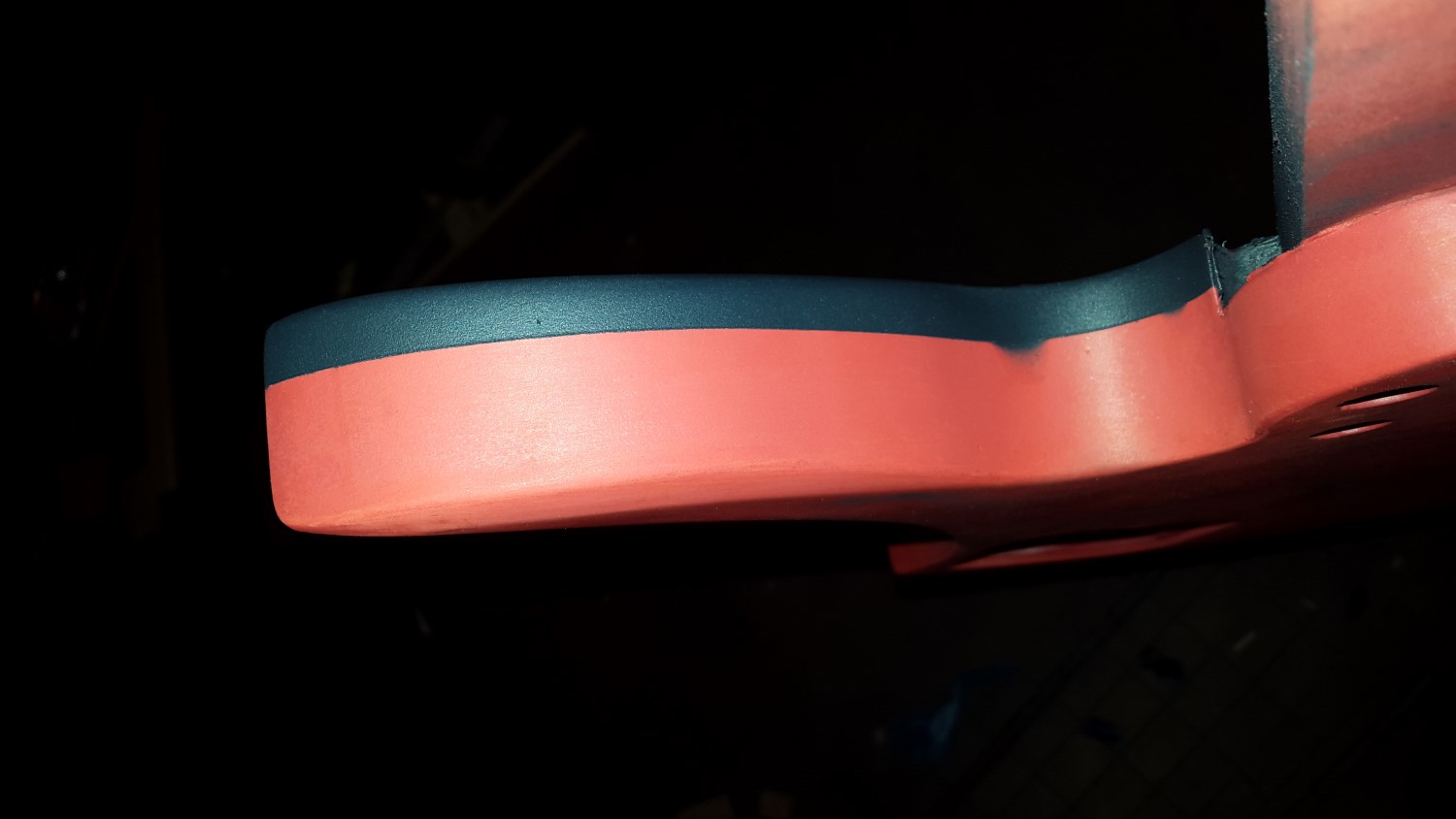

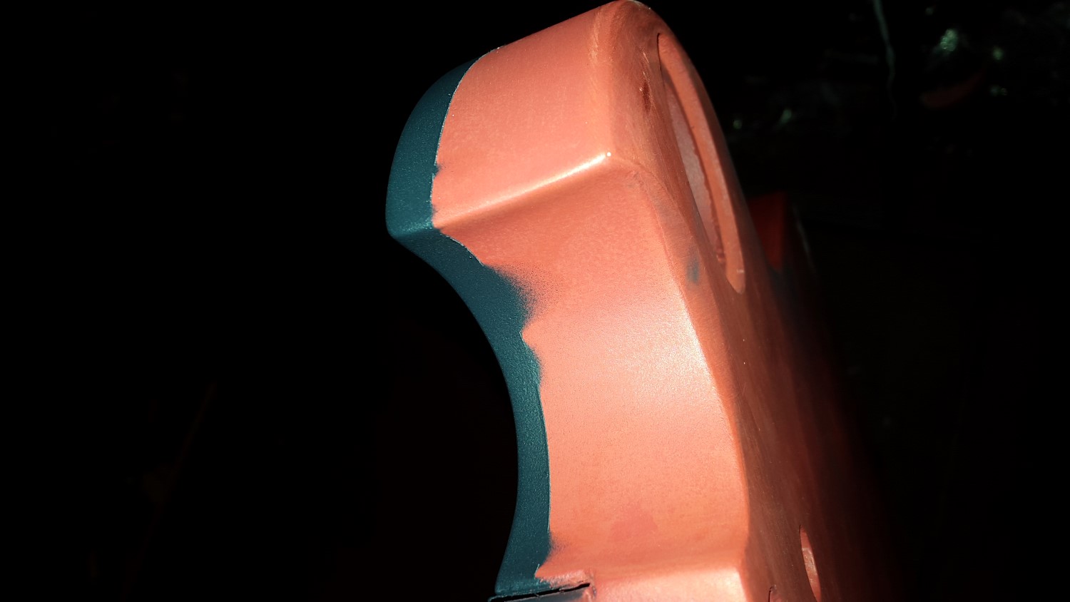

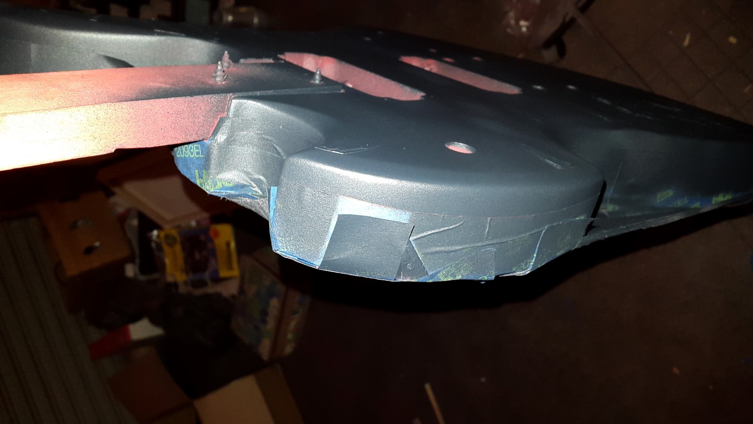

    The sides of the body ended with a bunch of bleeding, but that doesn't matter at all because I'll end up going over it with the black soon.
Name:	030 Bleeding on sides (Custom).jpg
Name:	031 And again (Custom).jpg

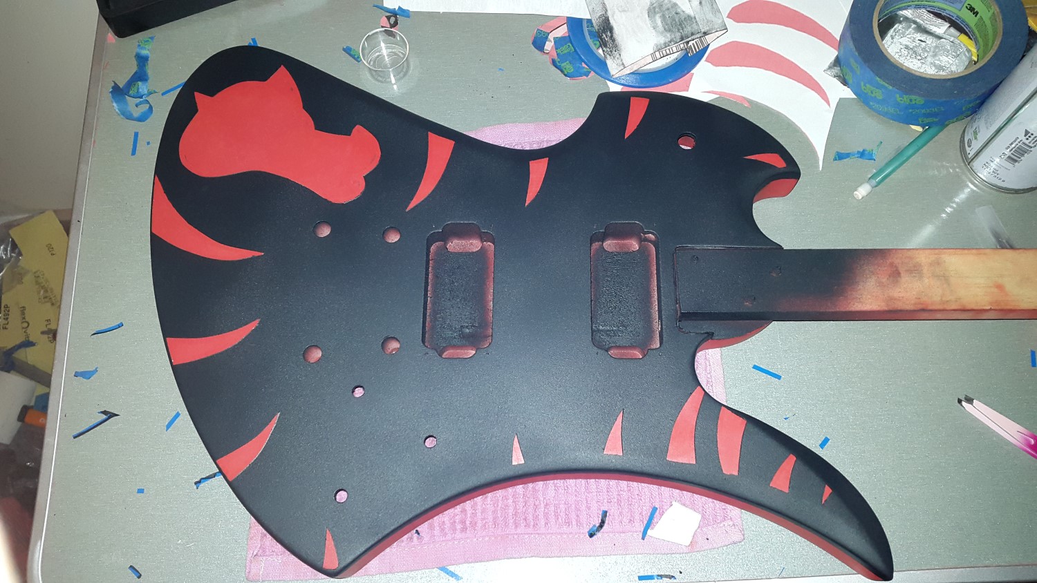

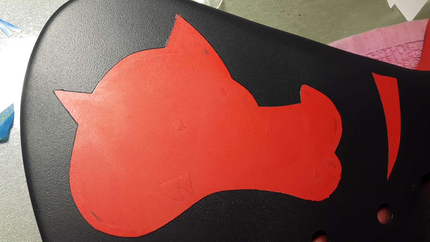

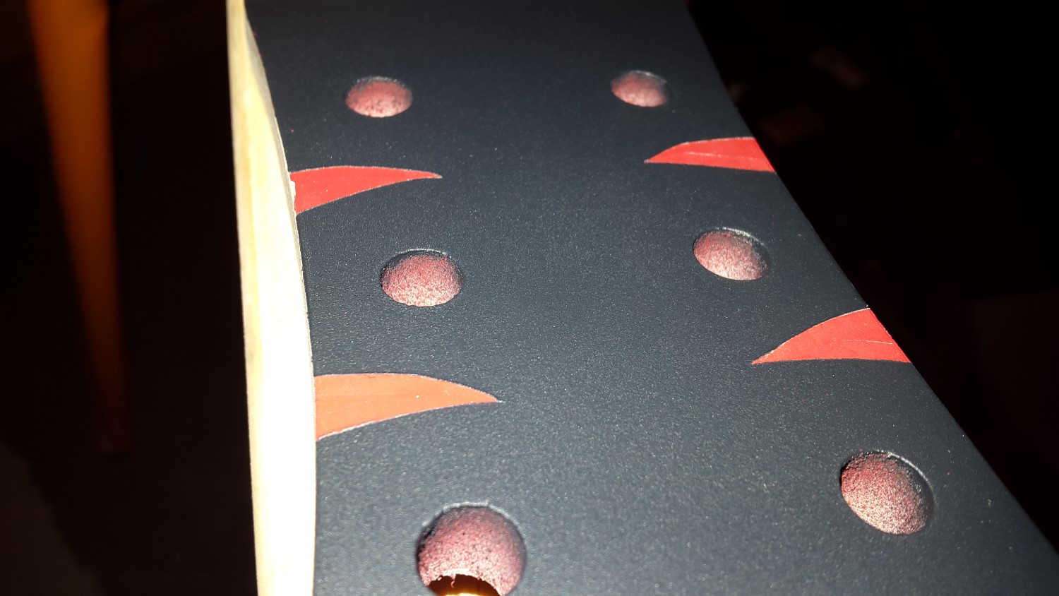

    Now for the body markings...
  6. #16
    This is the part that I was super worried about. But it ended up pretty nice, very little bleeding.
Name:	032 Revealed head (Custom).jpg

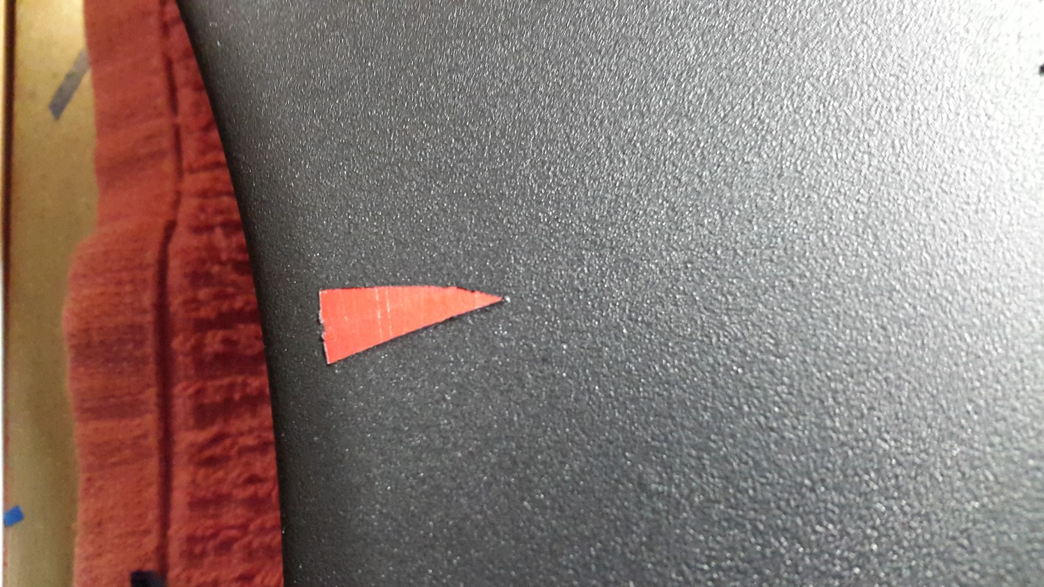

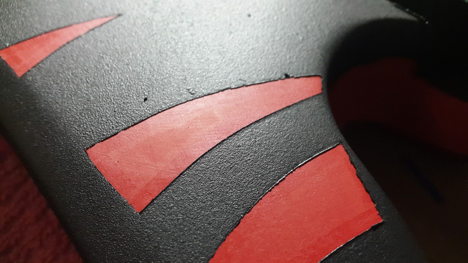

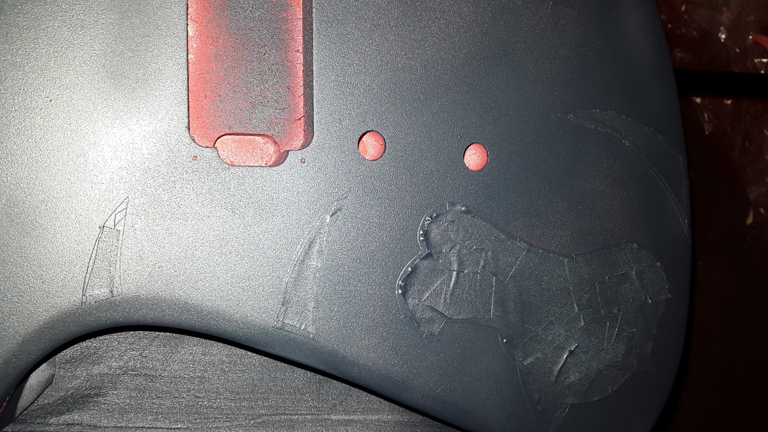

    There was only one of the other marks on the body that bled at all, and well the picture barely even shows it, it is quite minor.
Name:	033 Bleeeeeeddd (Custom).jpg
    Again, will have to sand it all back to even up the edges.
Name:	034 The edges (Custom).jpg
    Overall though, quite happy with it.
Name:	035 Everything! (Custom).jpg
    So next I'm going to go sand it down then decide where to go from there. it's most likely going to be doing the Pink, then all of the black in a couple of days, and then touchups after that's all done.

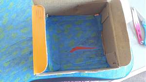

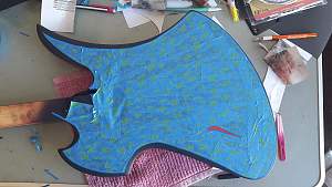

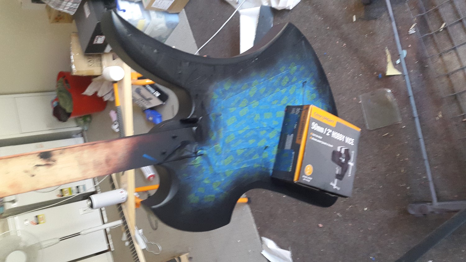

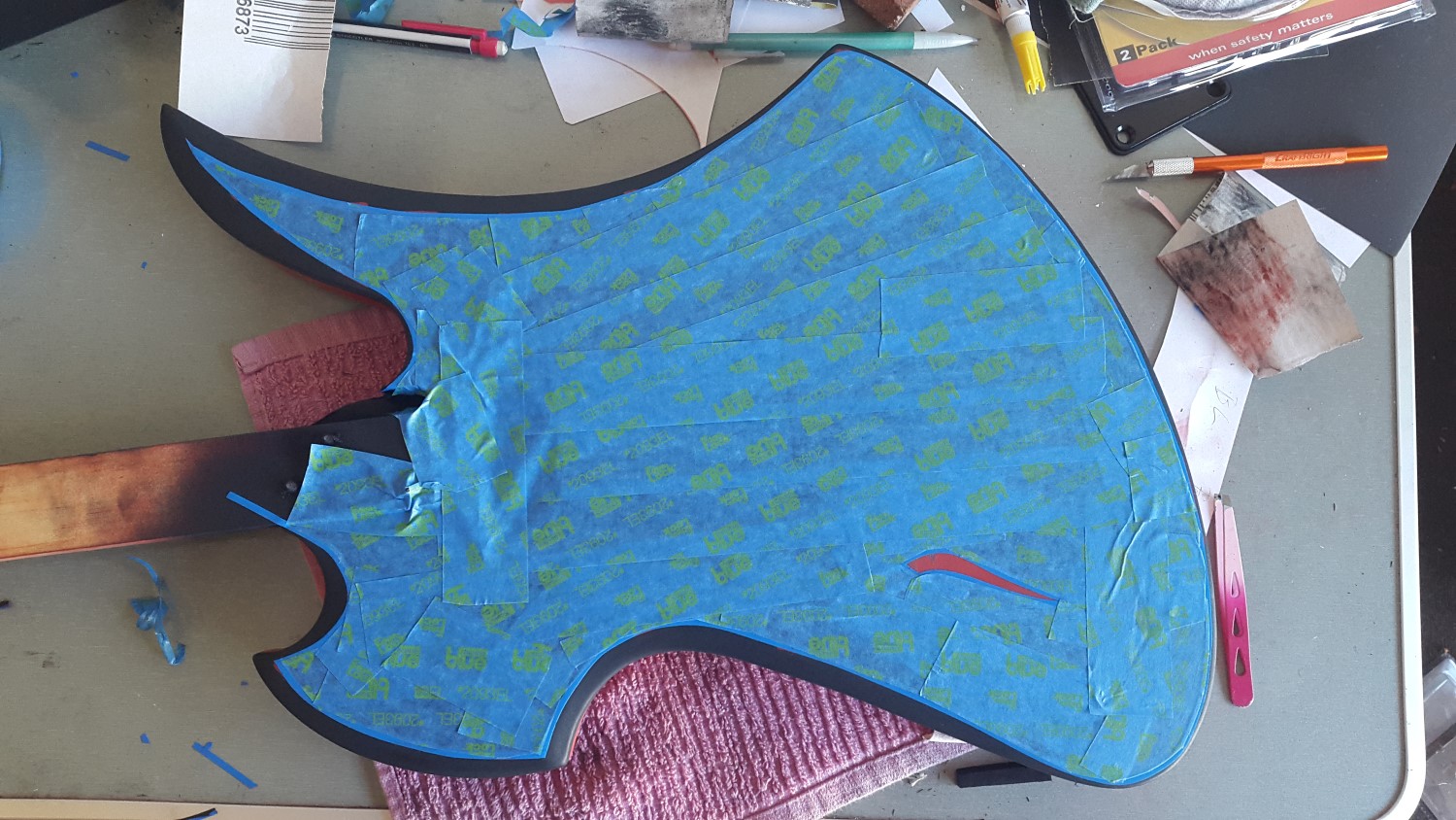

    Today, sanded down the grey, and decided I would mask off both the pink bits plus the back and sides, and paint them at the same time, then do the black details soon.
Name:	036 Masked again (Custom).jpg

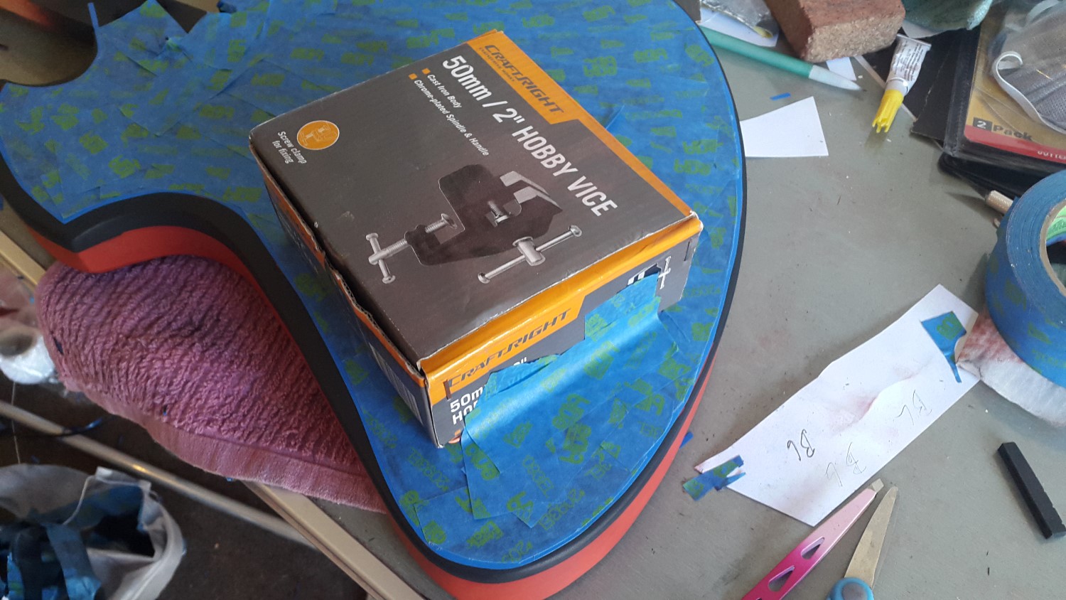

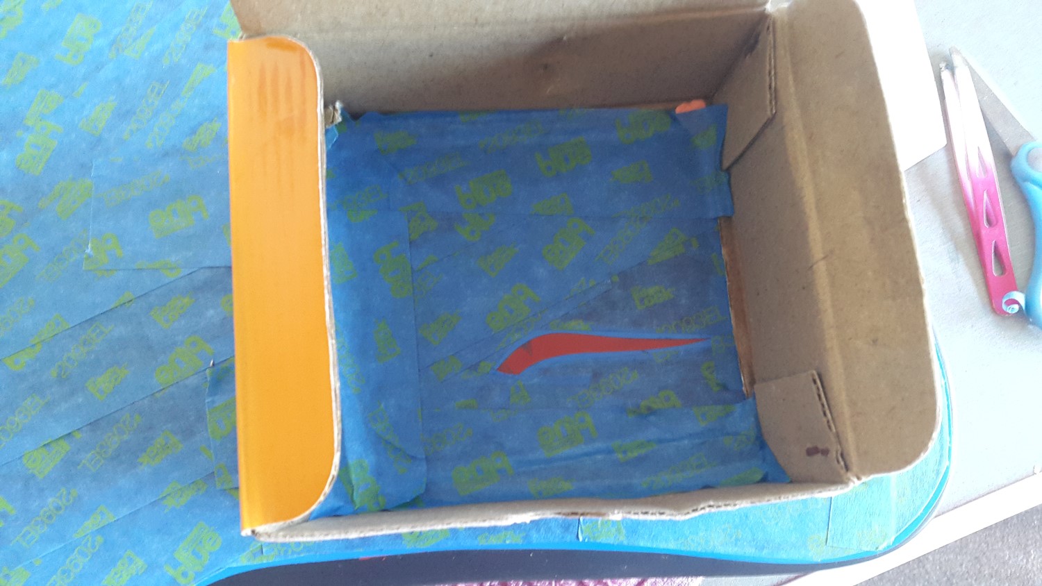

    In order to make sure I got no overspray on to either part, I cut the bottom out of a box I had around, taped it on and sealed it off a bit.
Name:	037 Whats in da box (Custom).jpg
Name:	038 oh its just masking (Custom).jpg
    And blurry picture of it all hanging up post painting.
Name:	039 nice and blurry (Custom).jpg
    So it'll be a few days before I rip that all off, then time for the tricky details.
