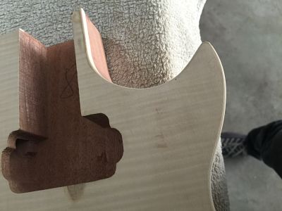

    on another note i cam across this on my my kit this morning, not sure whether its apart of the grain, a glue spot or just a dirty spot. can someone please help me identify it and maybe an action to get rid of it if possible?

    That mark below the neck pup cavity looks like glue. Could have been left when the cap was glued on. Try and lightly sand it but you may have to incorporate this in the finish. The pup ring will cover a bit of it.

    To me it looks like a glue spot, try a wire brush to get it out!

    Kurt, don't use a wire brush on the cap as Pest suggested, good chance you will rip through it, remember the caps are only about 0.6mm thick
