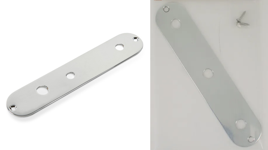

    It's fairly easy to get a regular sized control plate with three holes, either drilled for three knobs, or drilled for two knobs and a 3/way Gibson-style switch.
    You can also get an undrilled plate.
    That said, I saved the electroplating vid...will be thinking of an application for it...
  6. #16
    I understand they are easy to get in the US - but they're comparatively expensive and shipping is politely described as a "blatant rip off".
    Unfortunately buying a US part turns it into a $50 to $60 part.
    If from China, a control panel is $13 to $14 total cost.... unfortunately these are all two holes and a slot or plastic.... or not in chrome if they're blank.
  7. #17
    3,028
    Yikes! Will watch your nickle plating experiments with interest on your build diary ;-)
