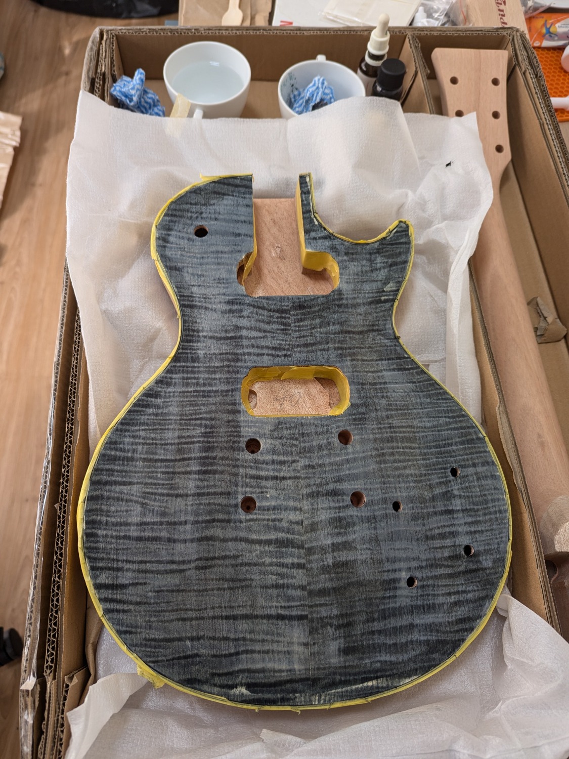

    So, I was a bit stubborn and decided not to follow your advice and went and stained the top black after watching the PRS fire red burst video. I used the ubeaut black stain in a 1:5 dilution in two coats. This was the result. Click image for larger version.

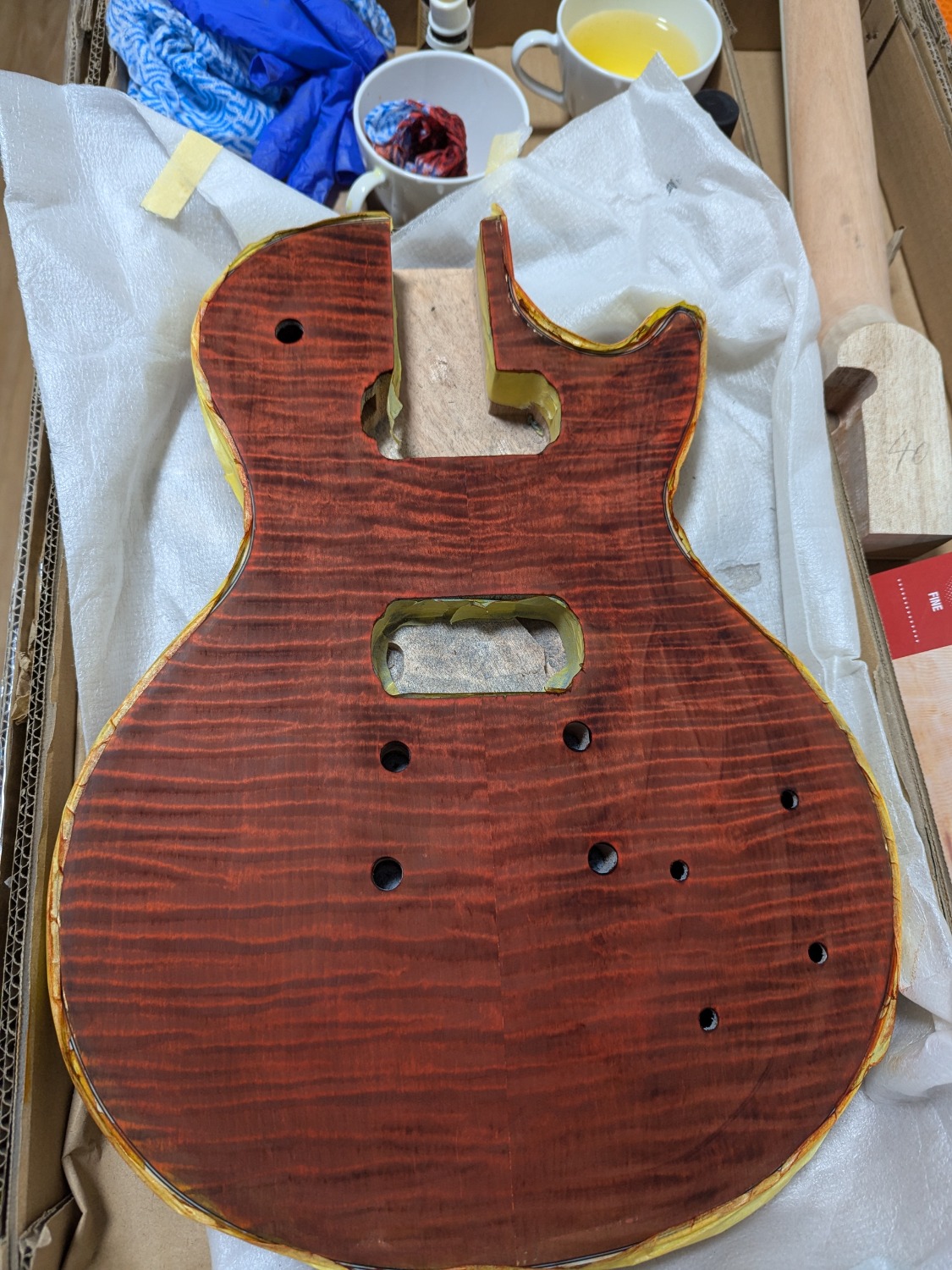

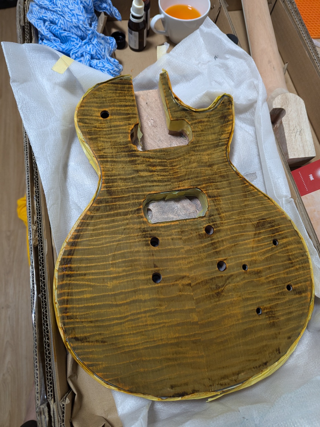

    I then tried to get most of the stain off with metho, then carefully lightly sanded it back with 240, 400, and green Scotch Brite pads. I was quite conservative and stopped when I started to see some streaks of bare wood and it was grayish. Then I went with two coats of orange, then 1 coat of red (for now). I'm quite satisfied with how it's going I think, though it might be darker/blacker than I initially wanted?

    Looking at that video now...I am always happy to have my over-caution proved wrong ;-)
    FWIW you got a really cool color out of it. Not something I have seen before on this style of guitar, which makes it all the better.

    My main takeaway as of now is: don't over sand. The body looked quite black/gray in the beginning, and after the first coat of orange I thought I hadn't sanded enough and that it would turn out too dark.. I just kept on putting thin coats, with more concentrated dye and the black ended up fading more into the background. The last red coat ended up being basically 1:1 water and dye.

    The stained veneer looks great. Hopefully the clear coats will make it really pop.
    FWIW, I think the black would have looked great as the final colour, and the yellow (orange!) would have looked great, and the red!
