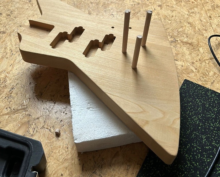

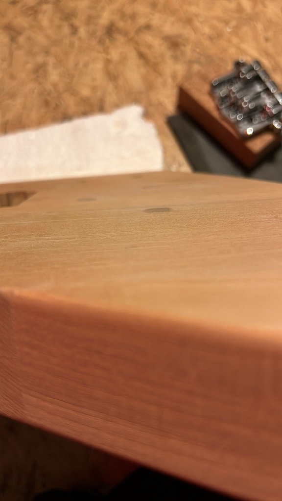

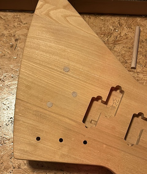

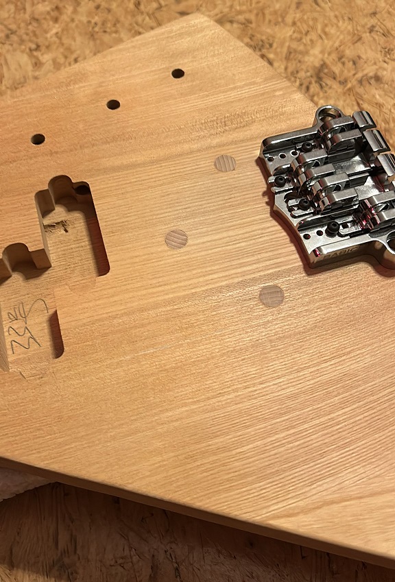

    I finally had the guts to fill the wrong bridge holes!

    I'm quite happy with the result of my first try :-)
    I first made some fitting dowels by putting by putting wooden bars in my drill and using a file while rotating until they were thin enough (the holes seemed not to be of metric measure so I couldn't find suitable dowels here).
    Then I glued those sticks into the wrong holes.
    Next day I cut them with the japanese saw (indeed a very interesting tool that I didn't know before!).
    And finally sandpaper.
    It wasn't as bad as expected! Thank you for the encouragement!!!

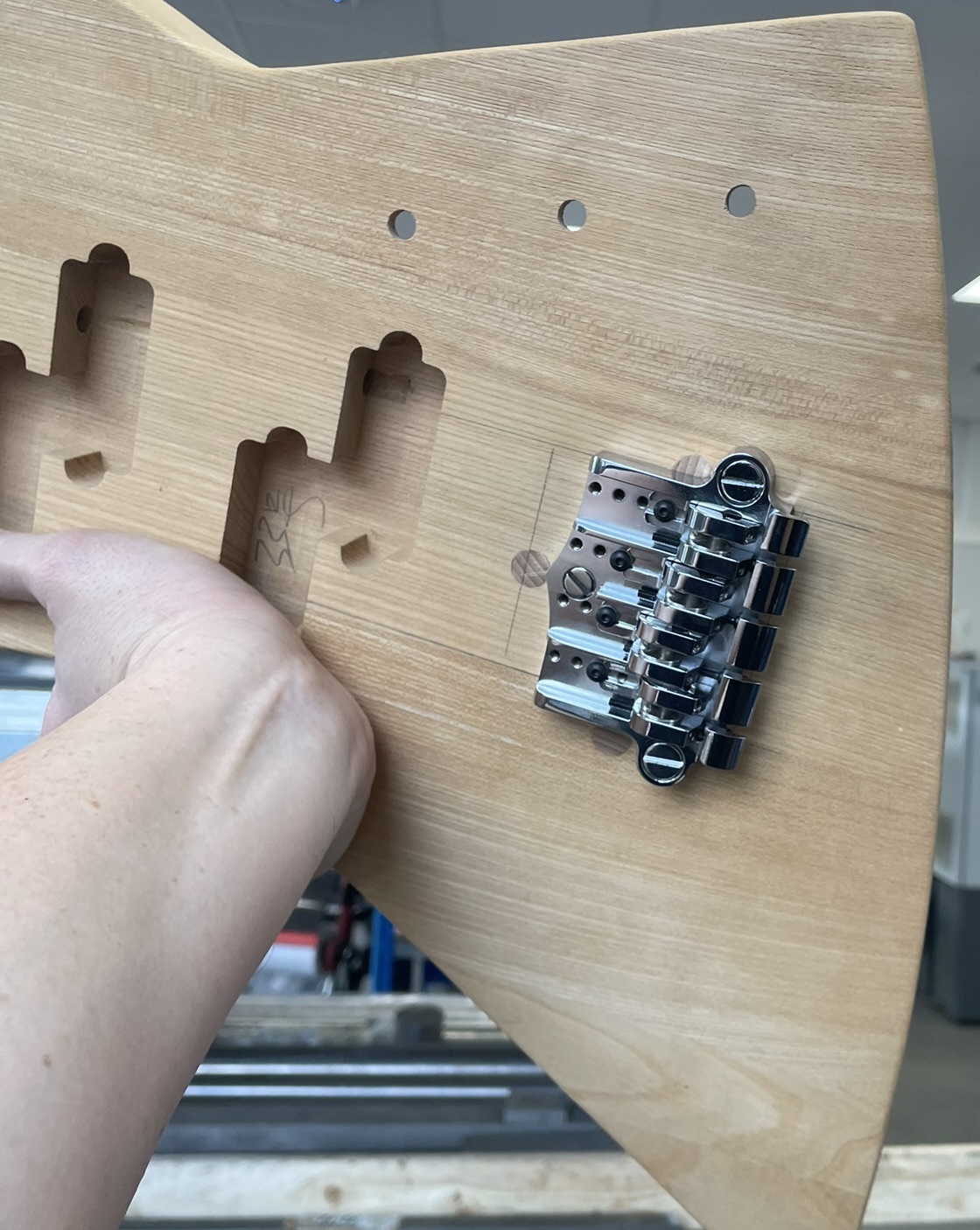

    Smile Update: Bridge Mounting
    Indeed, as fender3x suggested I wrote Baicz and got a nice answer!
    My Question:
    Is there a reason why the bridge shouldn't [...] be mountet with the screws through the whole body and sleeve nuts on the back? This seemed to me a very strong connection?
    The Answer:
    Hi Moritz yes that would be an incredible installation for sure! I'm confident I would improve the instrument! J Babicz

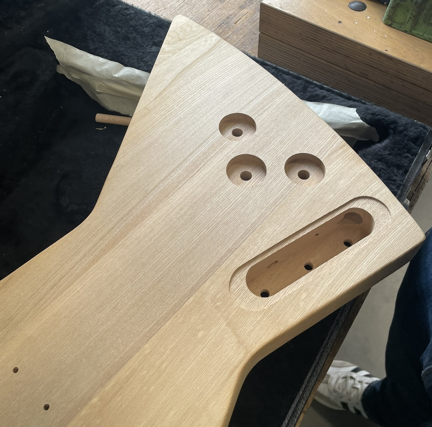

    So... i went for it. Checked suitable sleeve nuts and drills,...
    I learned what a Forstnerbohrer is, and looked for suitable sleeve nuts (found some intended to mount railings on boats).
    ...and finally had the guts to drill. Ok, to have a colleague helping me drilling
    Holes for nuts from the back:
Name:	IMG_4563 - Kopie.JPEG
    Holes filled with nuts back and front:
Name:	IMG_4566 - Kopie.JPEG
Name:	IMG_4564 - Kopie.JPEG
    And finally a mounted bridge:
Name:	IMG_4568 - Kopie.JPEG
    So I guess I'm now ready for "mock build".
    Last remaining woodwork seems to me to predrill the holes for mounting the neck and one hole to establish an earth connection with the bridge.
    Thanks to everybody here encouraging me! Most likely the slowest project in this forum...
