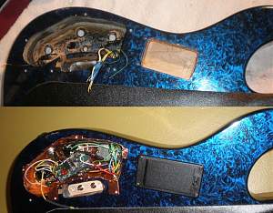

    Can you see inside the cavity using a torch through the f-holes?
    I would assume it is like the picture shown above (and I think the ES1 kit in the build diary referred to by WierdBits would be similar).

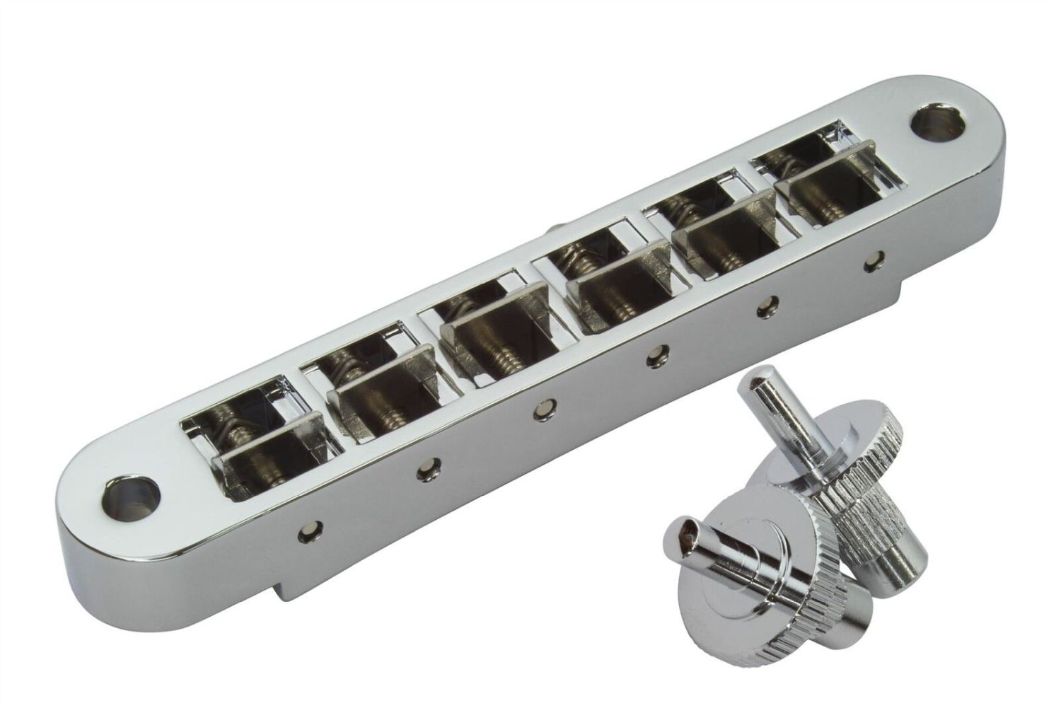

    Anyone knows the size of the Tune-o-matic posts/ studs that comes with the kit?. The piezo TOM bridge, I am ordering comes with post of 11mm. So if I know the diameter of the holes in the kit I can see if I need to enlarge the hole..

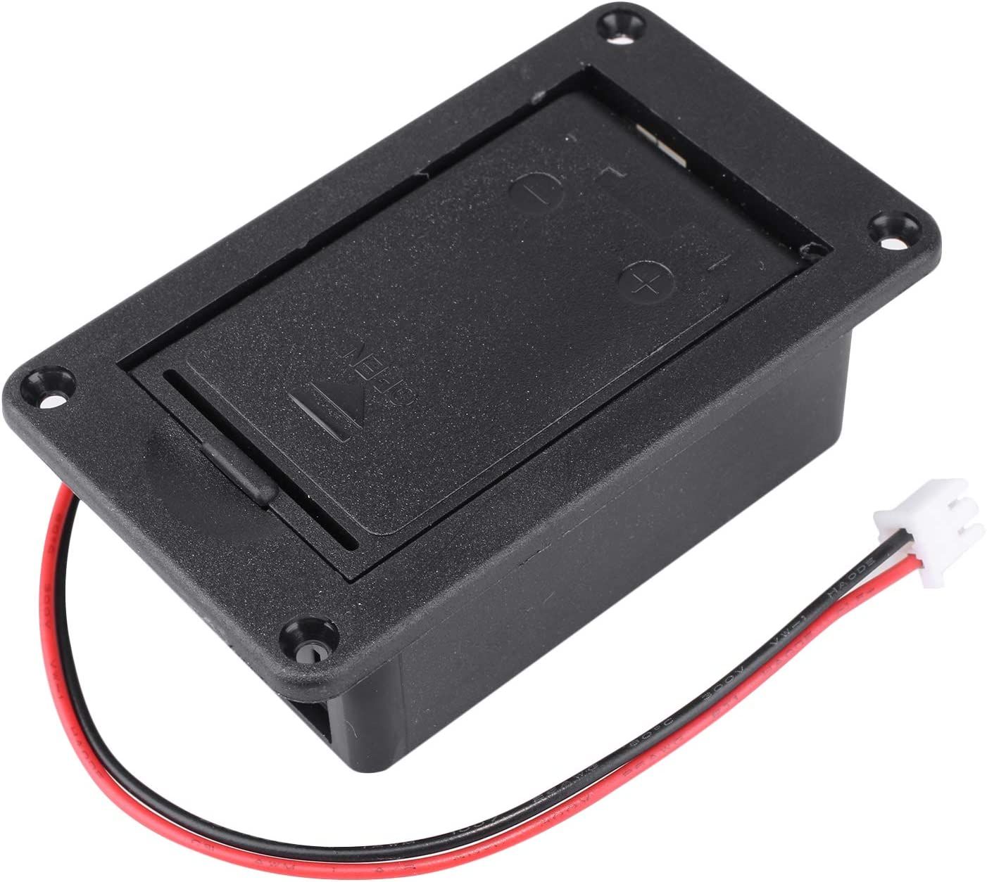

    If you use a battery box, I think they generally come with a lip so they can mount without being recessed. That's how mine was, in any case.
