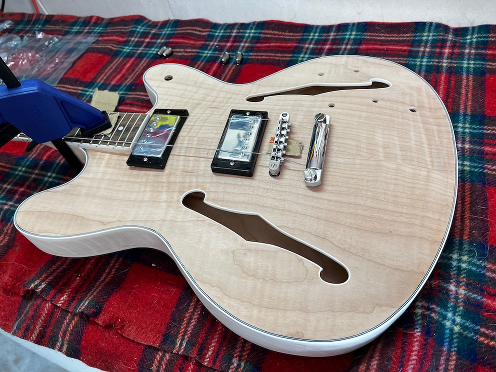

    Test Build

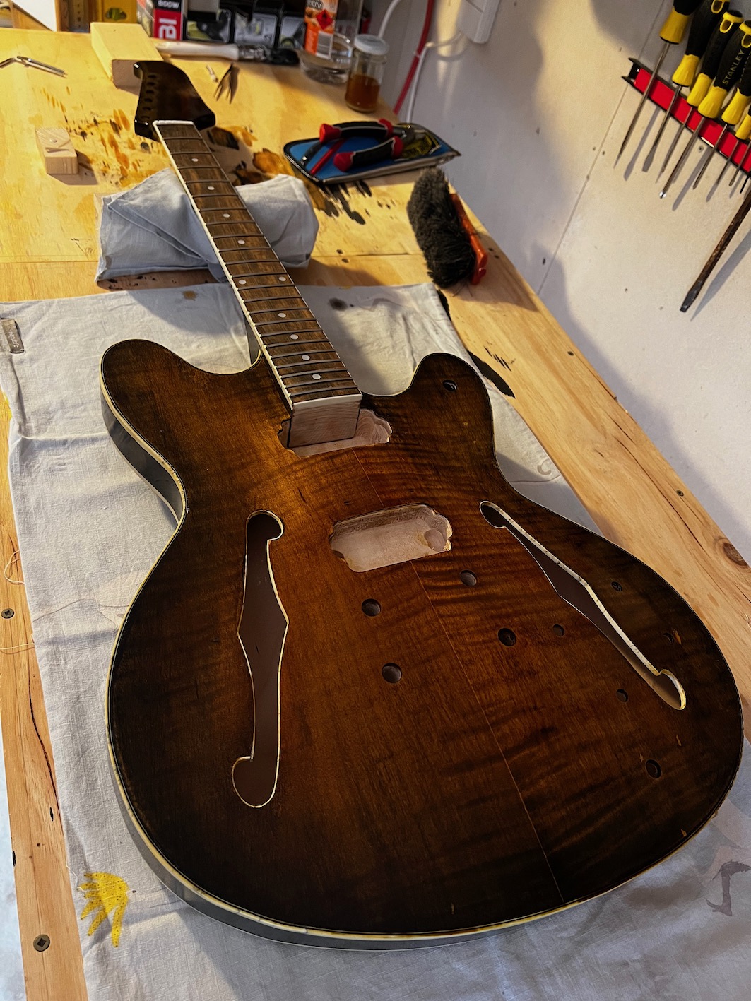

    I did the test build today and everything worked fine. I could position the neck to get the right scale length, the strings were evenly spaced down the length of the neck, and it was all a tight fit. No adjustments needed. Then it was onto sanding, sanding, sanding.

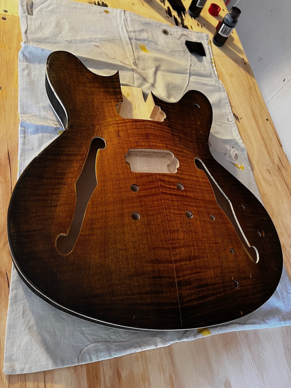

    Here's my attempt at a hand rubbed tobacco burst. I'm reasonably happy with it... perhaps a little darker than I was aiming for. The only other disappointment are the machine marks in the veneer. The instructions say not to sand the top, and I thought it looked pretty good, but then the stain brought out several marks. They're only obvious on close inspection though.

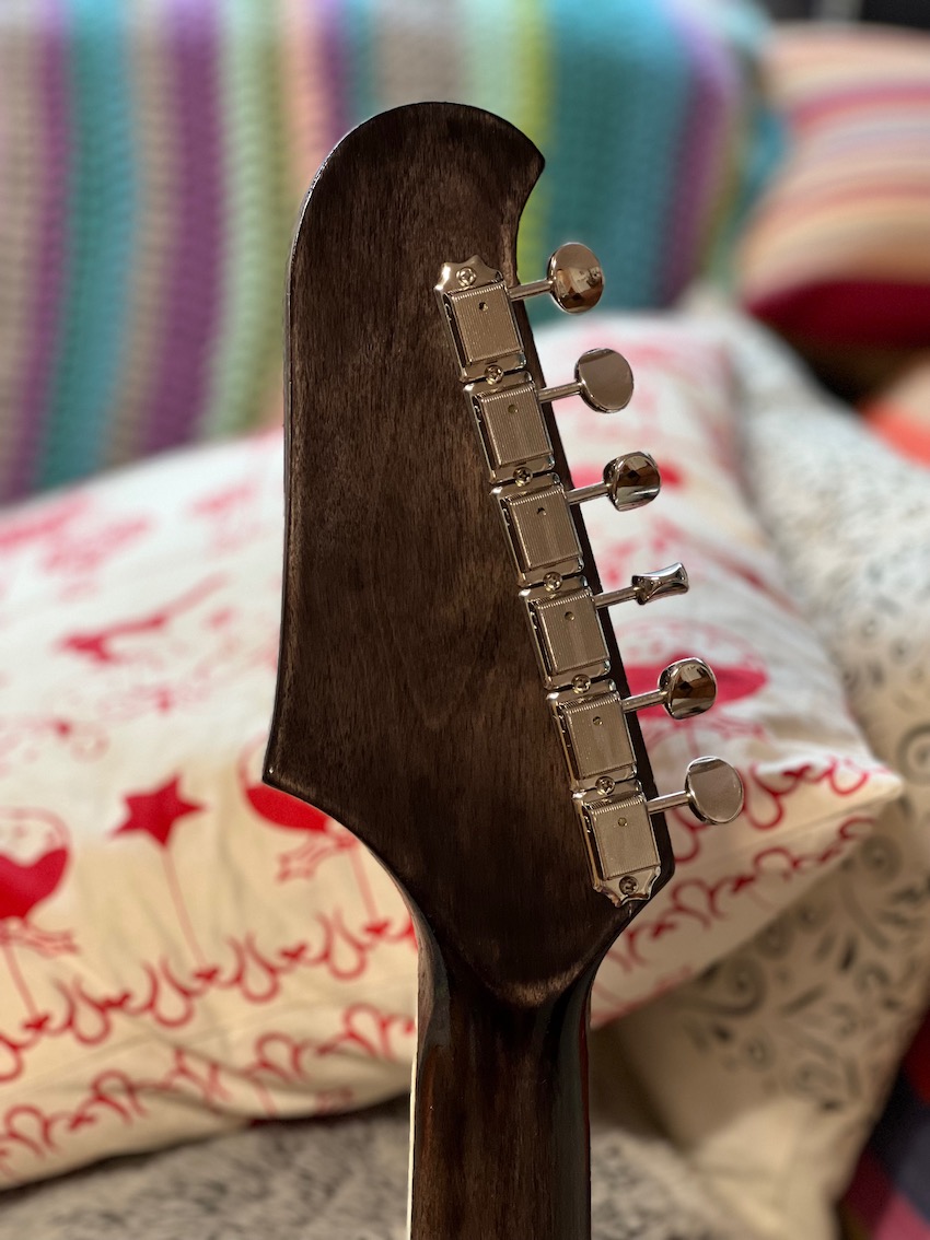

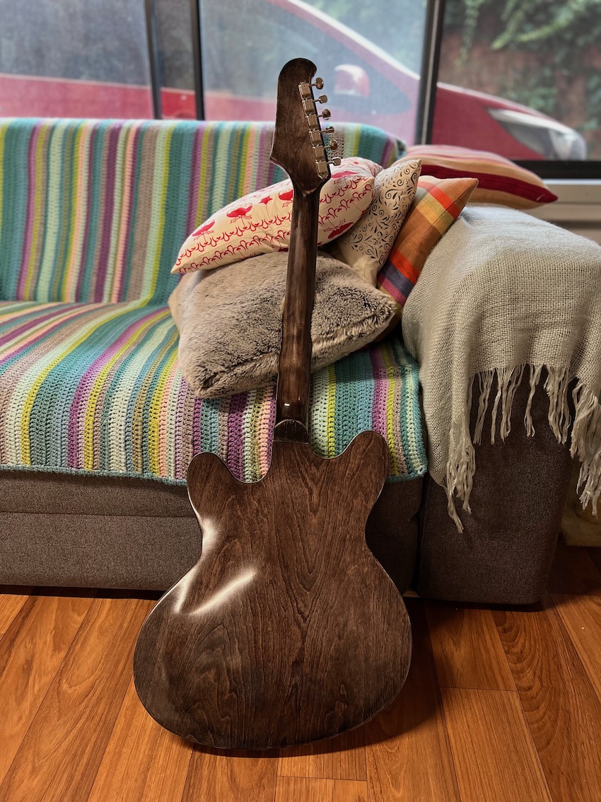

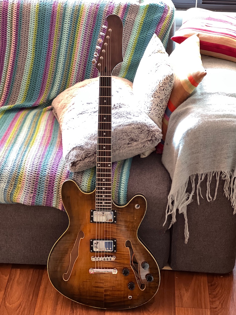

    Here is the finished guitar. I'm pretty happy with it. It's playing nicely, although I had to go back and revisit my fret levelling. I didn't realise how important this was when I was assembling it. But I guess, this is the point of building a kit... to learn the importance that "little" things contribute to the playability of a guitar!

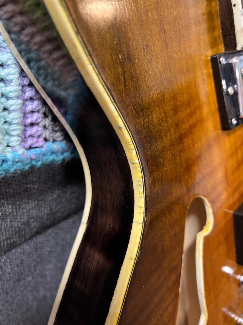

    I have two remaining bug bears. One I'll have to live with, the other I'll fix. The one that I have to live with - I got black stain on the binding and can't remove it. I masked the binding off, but the stain seeped into very fine cracks.
    The other issue, is a hum when I'm not touching the strings, which goes away when I touch any metal part of the guitar. I guess it's a grounding issue, but I can't find it where it's coming from... yet.
    Thanks to the many people who have posted on these forums. I found lots of helpful hints. A big call out to Gavin1393 for his excellent post on installing the pots into a 335. It saved a lot of frustration.

    On the Binding issue.. Did u try scraping with A razor?

    I did scrape the binding, but I couldn't move it from the fine cracks in the curves. Maybe I could have tried going deeper, but was nervous about scraping too hard.
