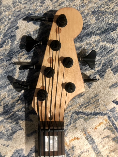

    But the angle that the strings jut off into is causing a lot of problems. I was sure, against the advice of Simon, that the *one bend* in the path of the string would not cause issues.
    But when there are 6 strings, high tension bass strings, tuggin' on that nut all in the same direction, well. It ain't great.

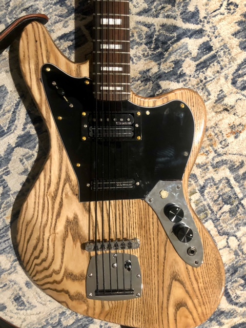

    In better news, I also received the Warman pickups I ordered for it and they are great. Really, really great. Pick guard looks BAAF (not sure about swearing on this forum, I typically speak like a sailor) and I'm very happy with everything happening on the body right now.

    Most of the issues with nuts is that they are badly cut or still far too rough. The nut slot should slope back from the fretboard side of the nut to ensure the fulcrum point is o the front edge of the nut, and I'd rub the slot with P400 and P800 grit paper to smooth it off as much as possible. Graphite in the slots also helps. My Flying V nut has quite severe splayed string angles on the two E strings and that stays in tune happily. Splayed string angles can exacerbate bad nut slots, but unless extreme, they shouldn't be an issue if the slot is correctly cut and smooth.
    Your main issue looks to be that all the strings are pulling the nut out of its slot towards the treble side, so it's going to need to be firmly glued in. Which is an issue as you'll probably want to remove it as some time in the future, so you don't want it too firmly glued in, or you'll never get it out again!

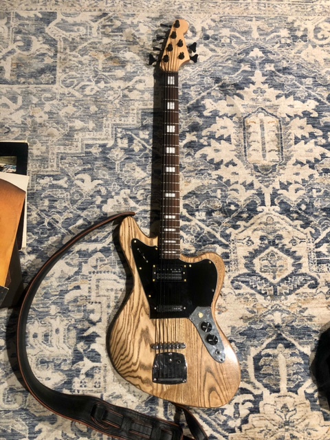

    She looks good though
    I'm proud I got the fender headstock style, not something that will easilty be reproducible with the 3-3 setup I'm planning. But maybe I will spend the next couple weeks thinking about that

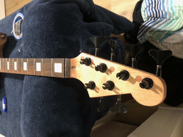

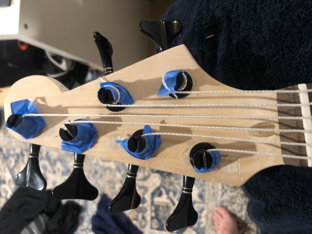

    Finally got the new neck after tracking it all over Asia. Looks to be in good shape! I opted for the paddle type headstock so I could go a 3+3 orientation without stuffing it into a Fender style headstock area.
    Bonus, this actually has a break angle at the nut! Which will solve another issue I was having.
    I sketched out a better string path and made my holes. Already lookin good
