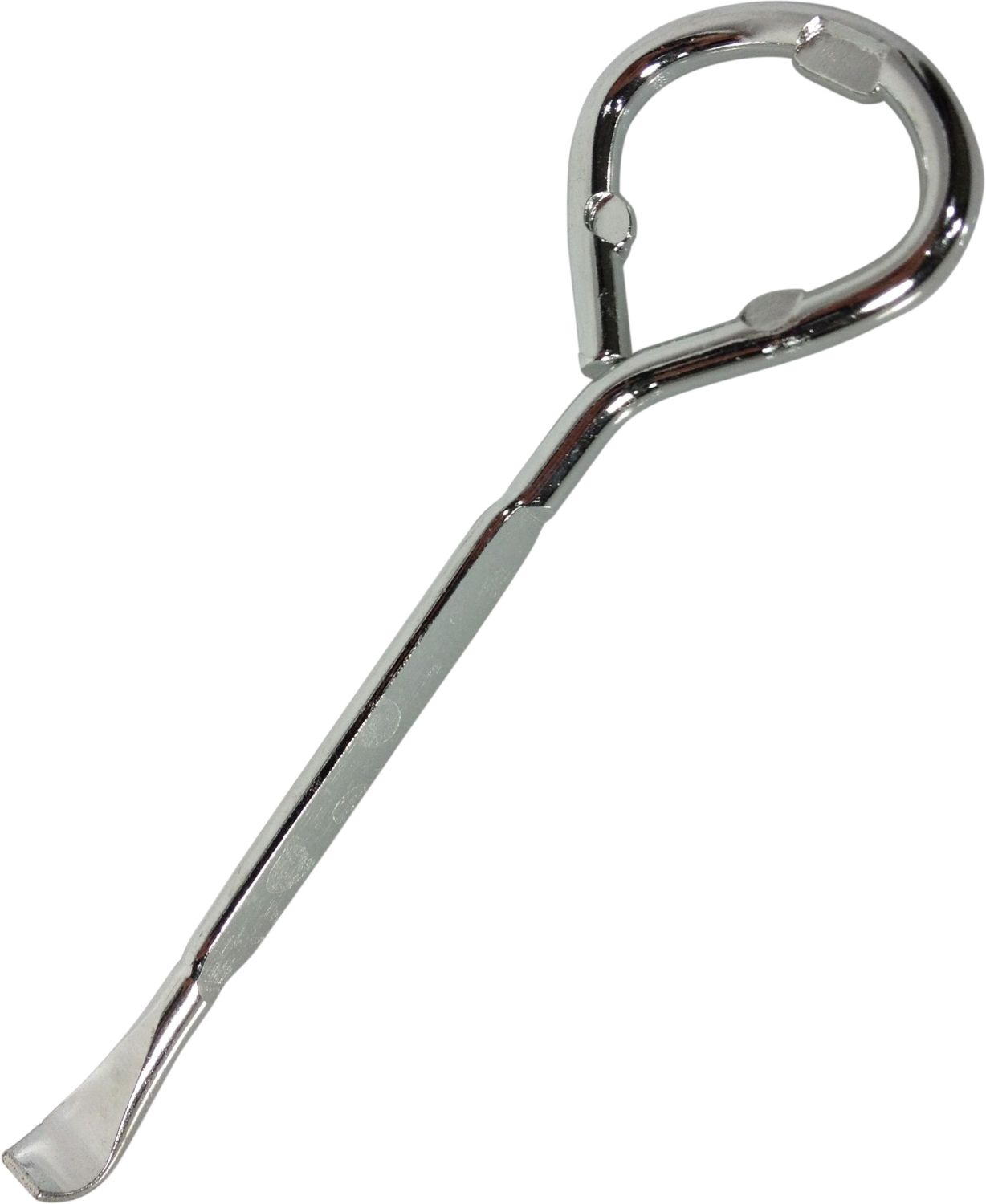

    ...what’s the best way to pull out those posts without ruining them?
    Using a bolt to pull the ferrule would be a great approach if the threaded ferrules were made of good quality steel. Unfortunately the kit ferrules are made with cheap pot metal, and will the threads won't put up with a lot of pulling, particularly if the bolt you use is harder than the threads. It may not strip the threads completely, but it can make it hard to screw the bridge mounting posts back in.
    What worked for me was to get one of these paint can openers.

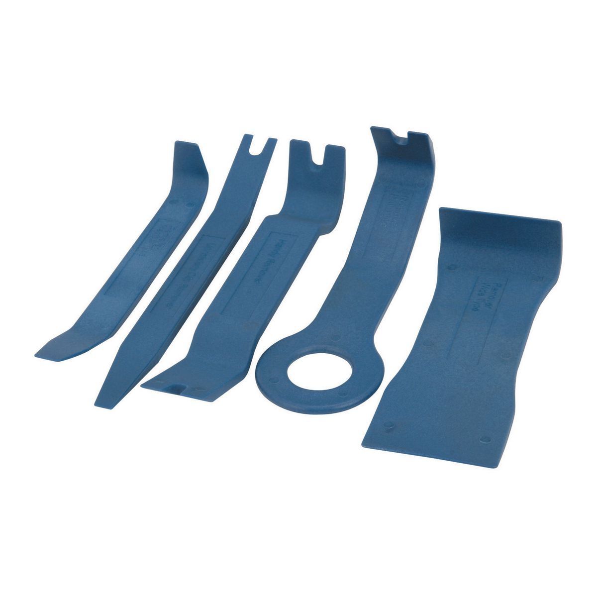

    I had to file the sides of the hook down a bit to get the hook to go through the center hole of the ferrule. Once I got the hook under the ferrule I could slowly work the ferrule up a bit. I also used auto interior panel removal tools to pry up the sides without damaging the finish. But mostly I just used the paint can opener.

    To do it without damaging anything, I found to be a rather slow process.
    Worked perfectly, thanks!
