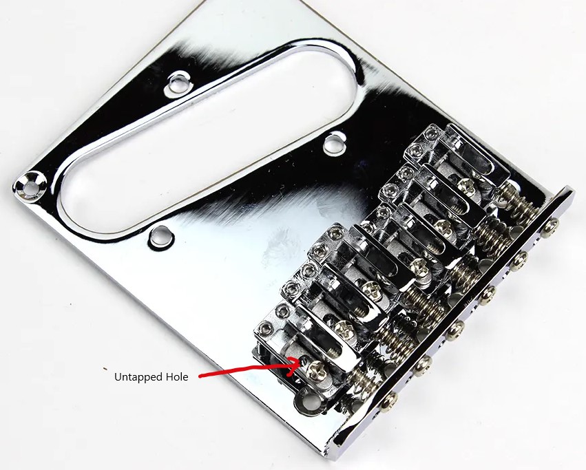

    Unless it's been remedied, the bridge is the weak point of these kits. It's copied the Gotoh 12-string bridge saddles, but the extra set of octave string saddle saddles should be able to be set forward for R/H guitar operation, and backwards for L/H guitar operation. But unlike the Gotoh, the kit bridge doesn't have the second set of holes tapped for the screw to do so, so is only fully adjustable for use on L/H guitars.

    The best you can do on a R/H guitar is have the two saddles in line with each other (which TBH is all you could do on the SG-style 12-string), though if you have some taps, you may be able to tap out the saddle holes to accept the screws, they are bound to be a metric size, maybe M2, M2.5 or M3.
    Alternatively you could fit a different nut (or make your own), and string it like a Rickenbacker with the thicker string of the octave pairs on the bass side, rather the treble side. This would then allow for full intonation with the bridge as-is, but if you can tap out the extra holes, then that would be a cheaper and far easier option than investing in nut files and making your own reverse slot nut. Even if you got a L/H 12-string nut, you'd probably find the slots were angled incorrectly, so you'd still need access to nut files to correct that.
