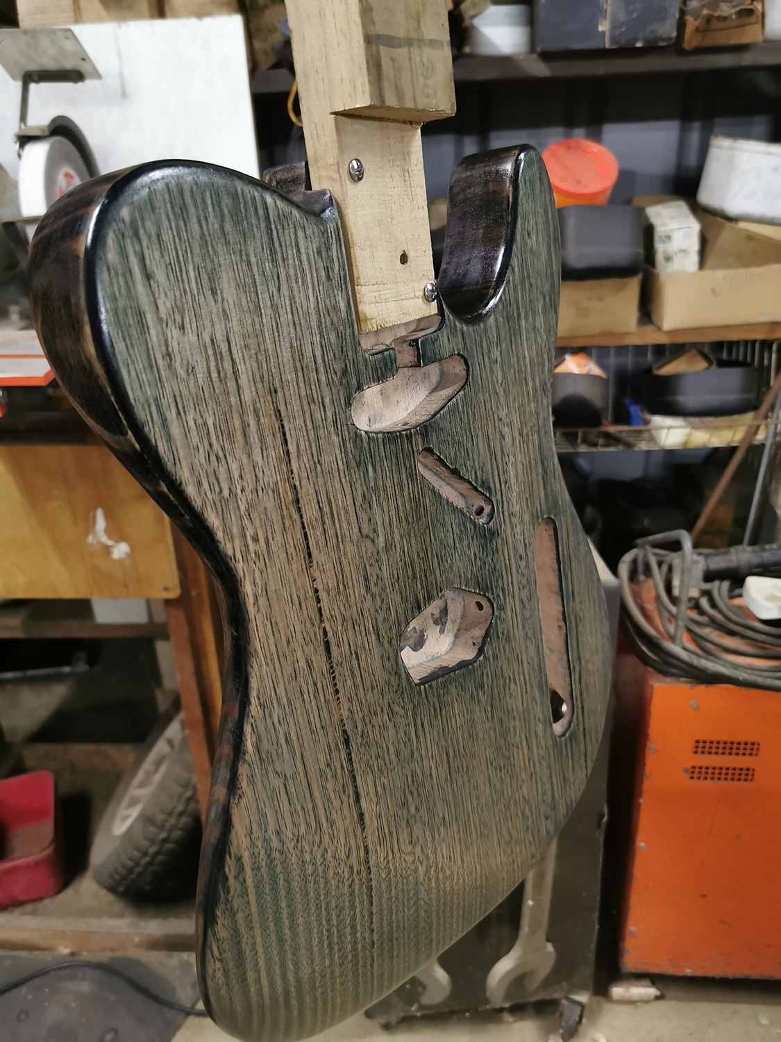

    Strongly considering sanding the whole thing back and starting over with a proper finish in mind.
    If you decide to do that, I would recommend giving it a good scrub with a brush (maybe brass bristle?) and naptha (shellite) after sanding.
    Being a very open-pored timber, you want be sure you get all the wax out of the grain as it may not play nice with whatever new finish you choose.
    Of course if you're going to do a solid colour, you could do coats of shellac first like mentioned before to be safe.
  8. #18
    Member ross.pearson's Avatar
    May 2021
    Lower Upper Woop Woop, WA
    211
    I've decided I'll try and take everything back to bare wood and have another crack at it. Nylon brush and mineral spirits to dissolve and remove as much wax as I can. I'll still go for the same effect, but with a black wash. I might even try for a burst effect.

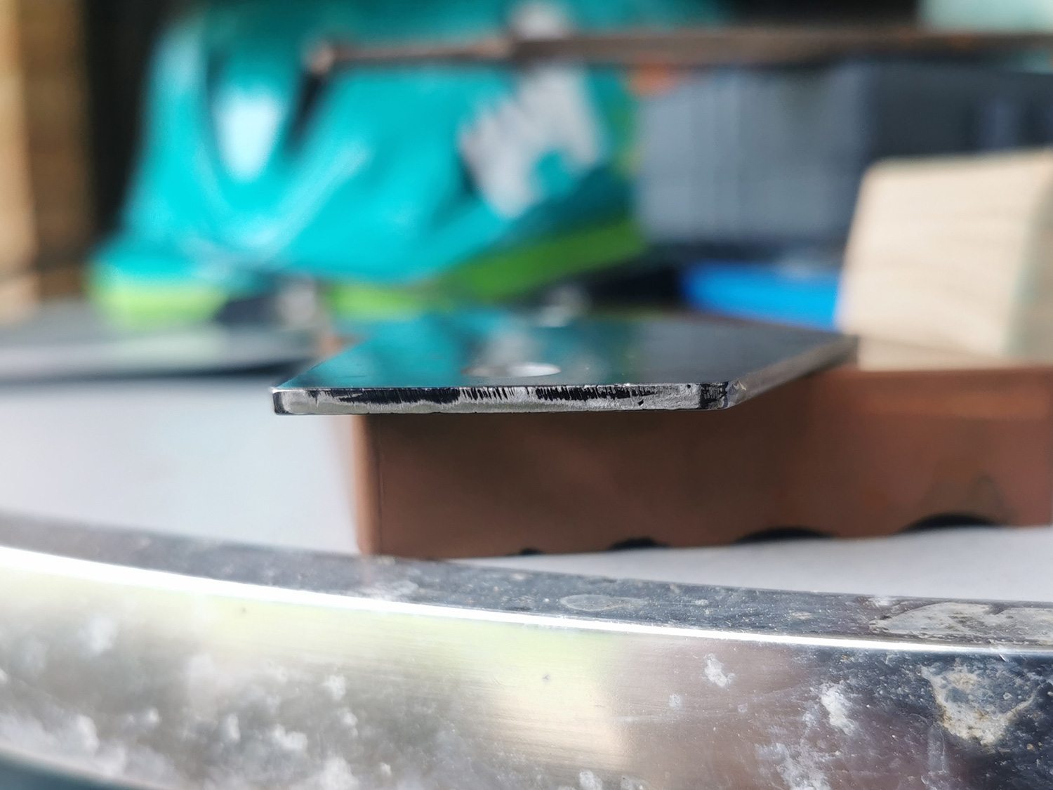

    In the meantime I had a lazy afternoon turning a cheap craftright engineers rule into a poor man's notched straight edge. Seems to work fine. I filed by hand because I didn't want to risk warping the ruler by putting too much heat into it with a grinder.
    Chainsaw blade sharpening file ate through the steel in seconds.

    The good news is it has an inbuilt handle!

    Nice MacGyvering.
  11. #20
    I love home-made tools, and nothing wrong with them in my book. Good on ya!
