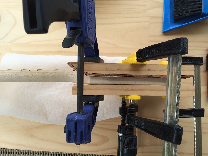

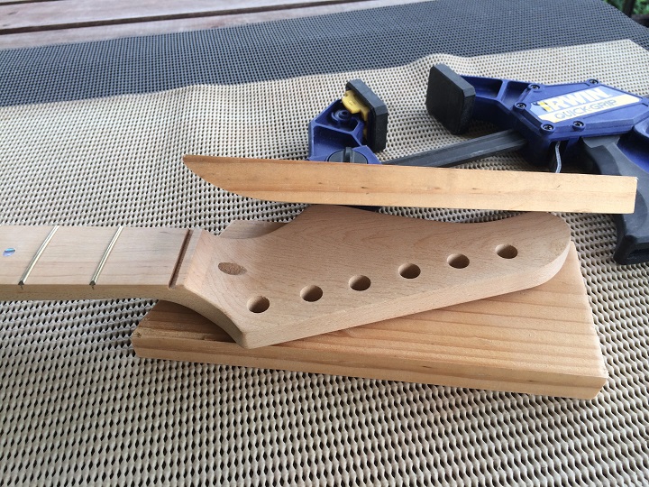

    I think mine was even thinner than that. The veneer has to shape/conform to the shape of the headstock where it transitions through the truss rod area up to the nut. I used a homemade caul (I think that's what they are called) to clamp the veneer in place after gluing.
    This is from an earlier TL build showing the caul.
    All clamped together
