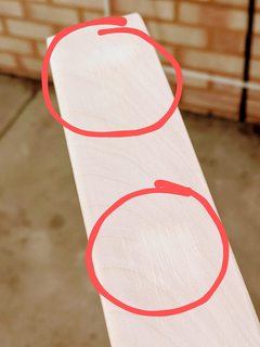

    I have a question about sanding if anyone could help me out:
    The Pit Bull instruction manual PDF on the website says not to sand beyond 220 grit, I have sanded to a very smooth 400 grit, it feels really nice but now im worried the stain won't take evenly.
    Also there still seems to be some machine marks on the edge of the body, what's the best way I can get rid of these?
    Can anyone lend some advice?
    Mentor dozymuppet's Avatar
    Jun 2020
    842
    Sand some more. And then when you're done, sand some more...
    You might need to go back down to 120, then back up the grains to work through the scratching.
    Regarding the staining, 400 is generally considered too fine for the stain to take evenly. It's probably ok for the veneer, but for the body I'd go back down the grit.
