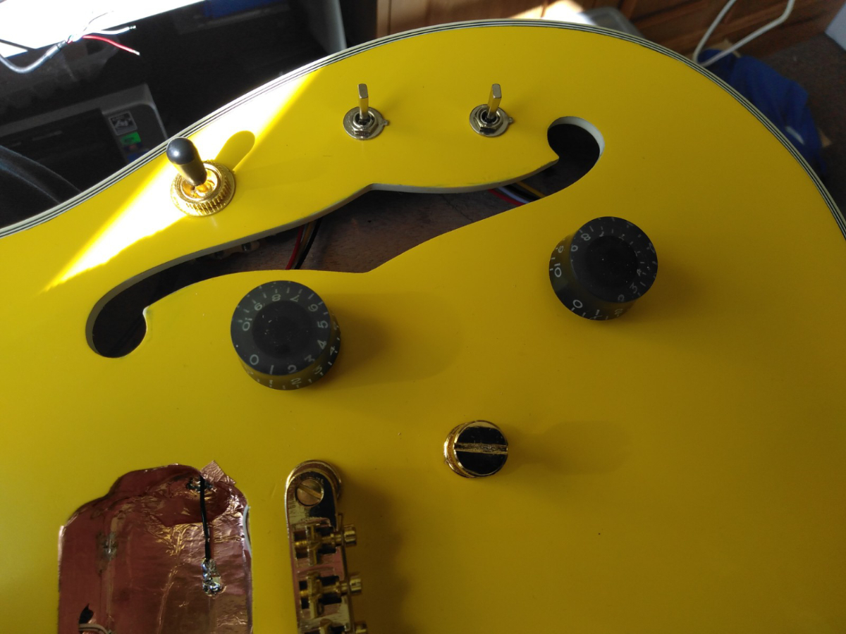

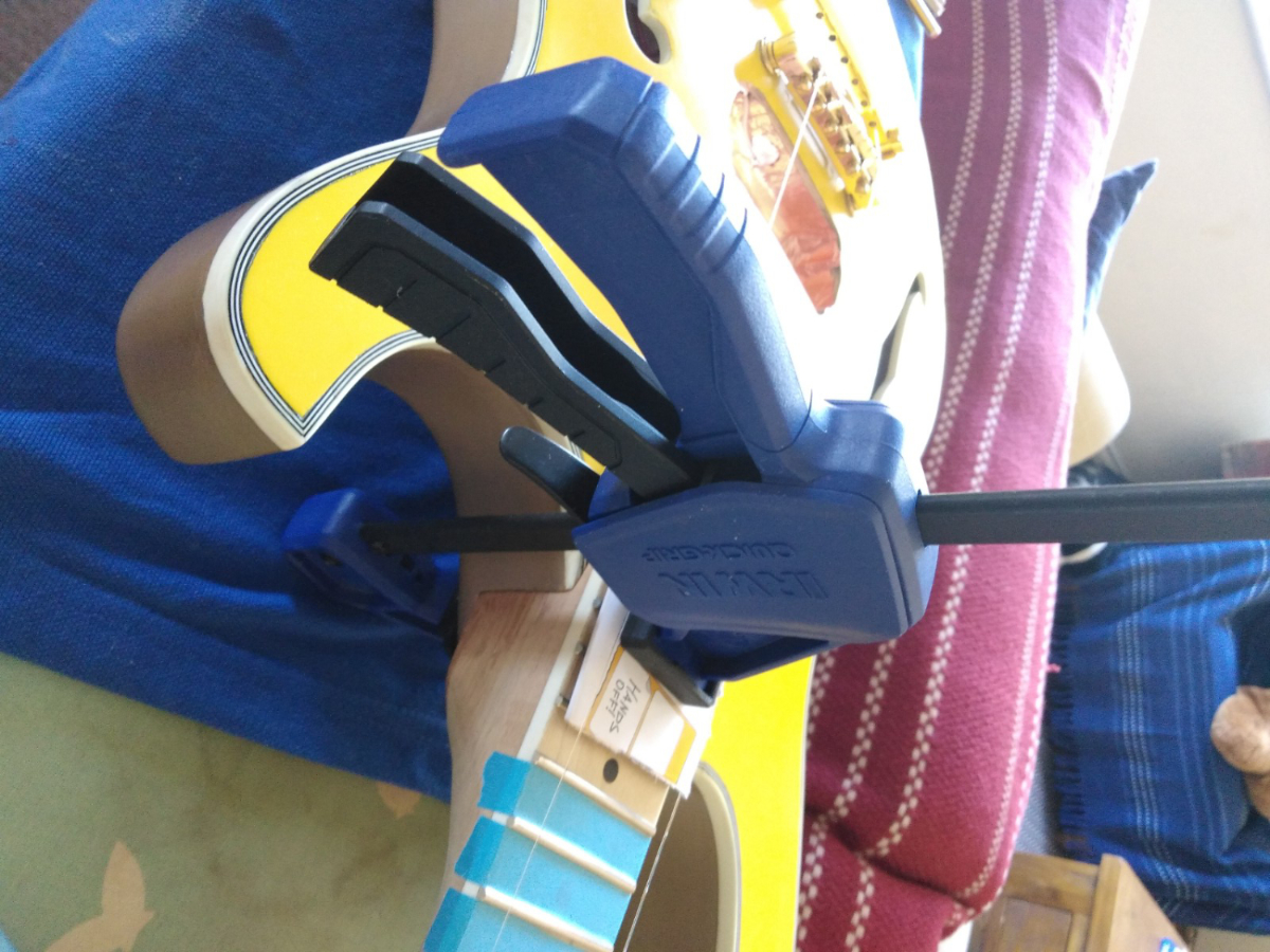

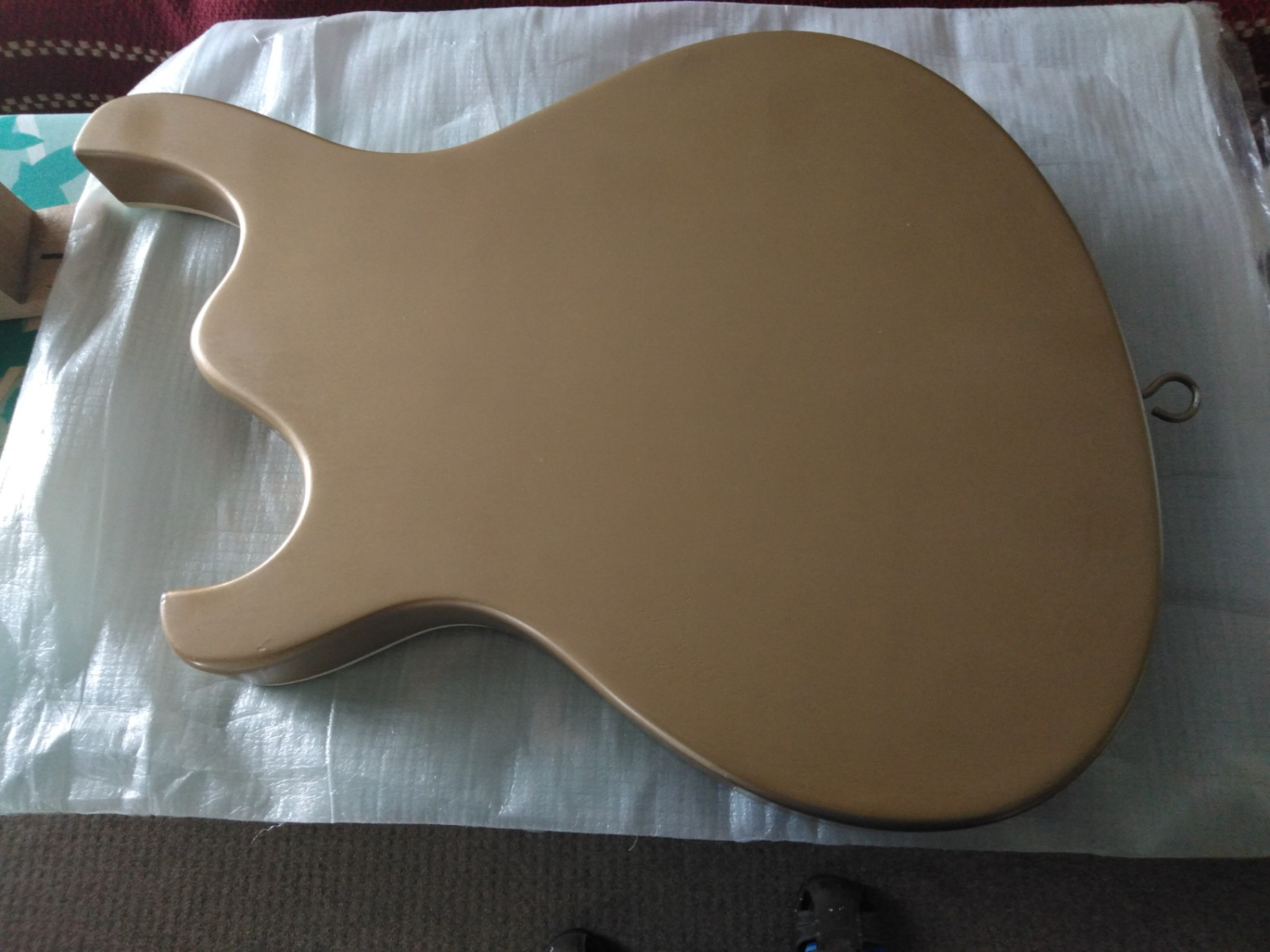

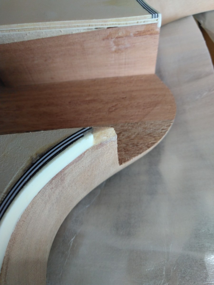

    It has been a week or so and No1 moves along slowly.
    Grain filled the back and sides with gold filler.
    My plan was to get a gold grain and oiled finish to them.
    Applied too much filler, sanded a lot down, got fed up and decided to
    paint the back/sides gold.
    Several coats of rattlecan gold later and it looks quite good.
    Will finish with lacquer once I have done the front staining.
    Revisited the scale length again, it seems that No1 has a 25" and No2 has a 24.75" scale length.
    As suggested before, the bridge pup routing is the clue really.
    How did I miss that ? It was so obvious.
    Onto the front and I need to think about the TOM holes.
    Decided to use the spacing from No2 (which has holes drilled) and go for a midway point on the bridge.
    Had read and thought about tear-out and bought a couple of new 12mm drill bits but still
    managed to get a bit of tear-out.
    Think it will be OK though (fingers crossed).
    Still need to drill the holes fully but need to work out how to do that.
    I have a battery drill with a level in the end, that may be a solution.
    The two dings in the binding where I dropped the body I will have to live with.
    That's it for now....cheers, FB.

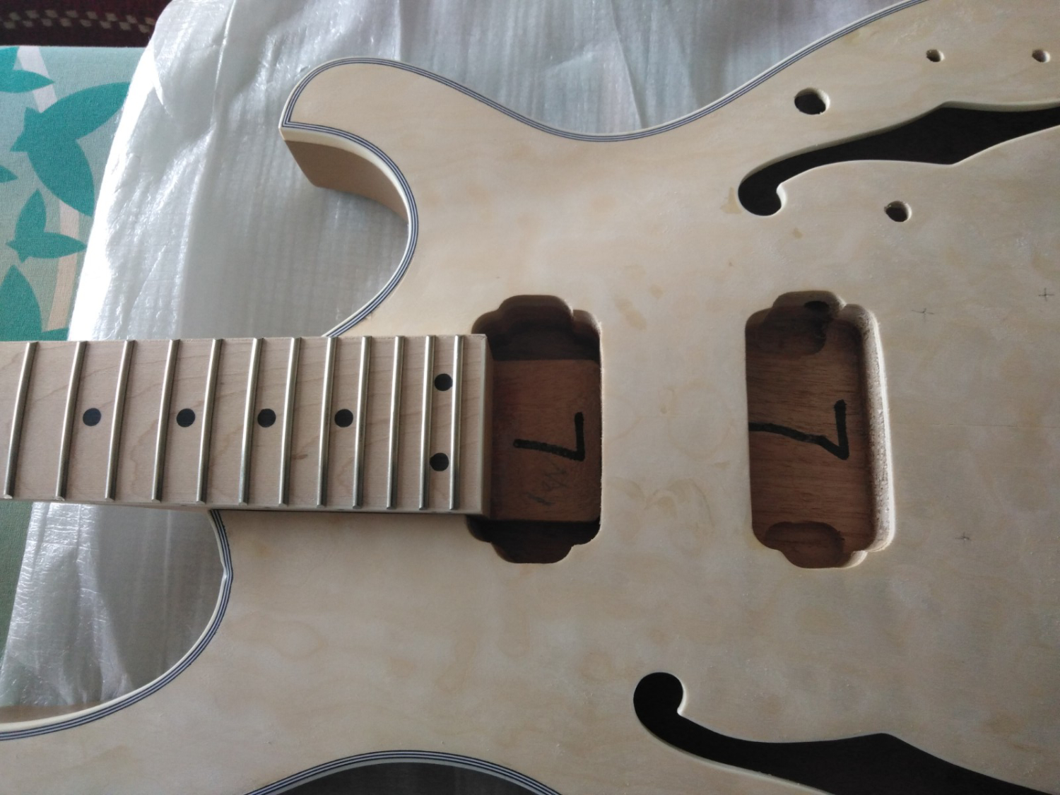

    Reading your last post, I'm unsure if you have drilled the bridge holes or not, but referring to your photo on the bottom left, you will need to move the neck away from the body a tad more to accommodate the pickup mounting ring.
    This shift should be taken into account when laying out and drilling the holes.

    McCreed,
    Yes, thank you, it took some time for the penny to drop about the pup mounting ring as I was so focused on the scale length.
    I think that I have the bridge in the right place, anyway the holes are drilled now haha.
    From what I can work out the bridge is the important one.

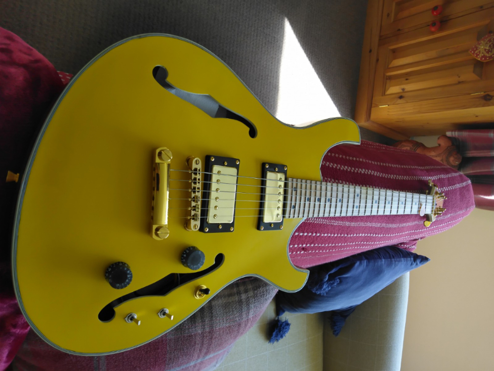

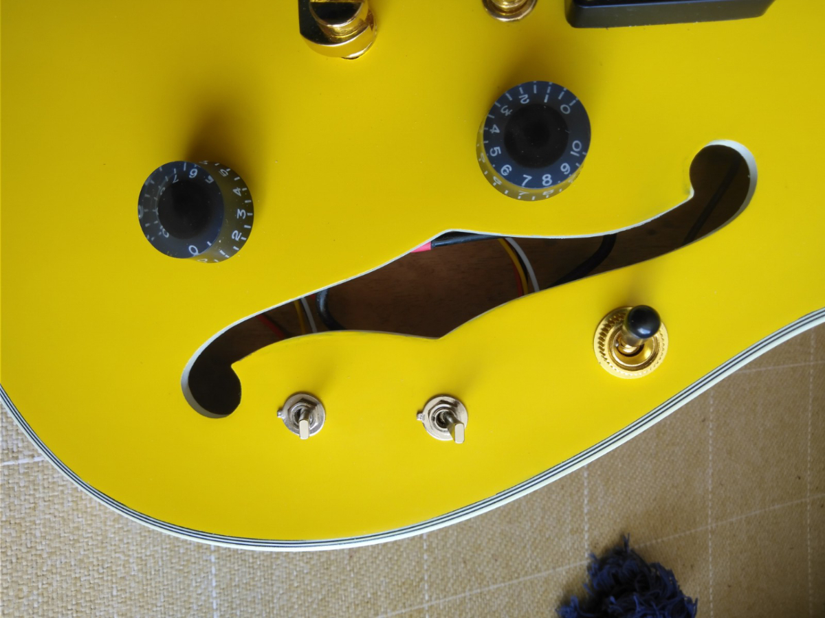

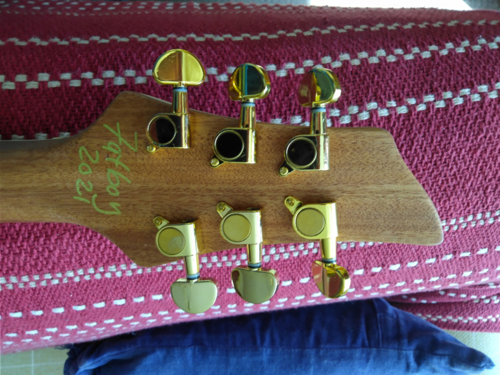

    Well it has been six weeks or more since I last haunted this place.
    No 1 is now finished, my biggest problem was the slightly bent neck and masking off the
    binding to spray the yellow. No problem. I thought, I will scrape the paint off.
    Noooooo ! I don't have the skills to do that.
    Watching Yootoob it seems a piece of piss, actually doing it there is a fine line between
    success and abject failure haha.
    No, the worst bit was finishing the top, polishing the lacquer, just putting some masking on while I
    sorted a recalcitrant fret or two and then pulling lacquer off with the tape.
    I was so pleased that I almost cried !
    Repaired the damage, it's so good that a blind man would be proud of it.
    Anyway, it is done now, the switching works fine so I have two humbuckers with the usual
    three way selector switch and each pup has a separate switch for : Series Humbucker, Parallel Humbucker
    and a single coil.
    Pics attached, onto No 2.......

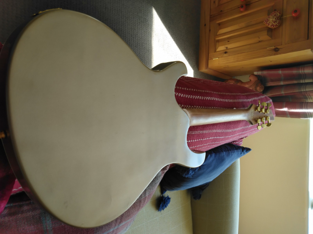

  8. #18
    Nov 2019
    Essex United Kingdom
    83
    Quote Originally Posted by Fatboy View Post
    and a single coil.
    More pics, so tedious posting pics.....actually I can't be arsed,.

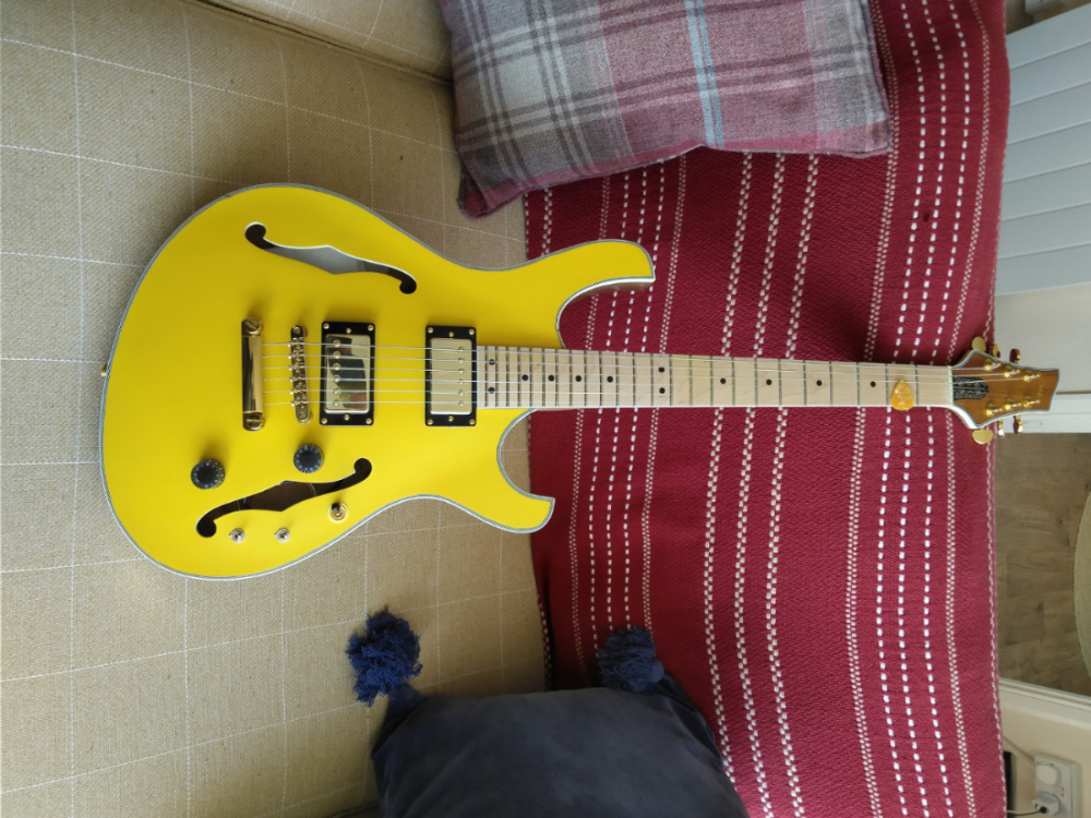

  9. #19
    Nov 2019
    83
    Getting tired doing this at the end of a long day.... hopefully the last that work....onto No 2....
