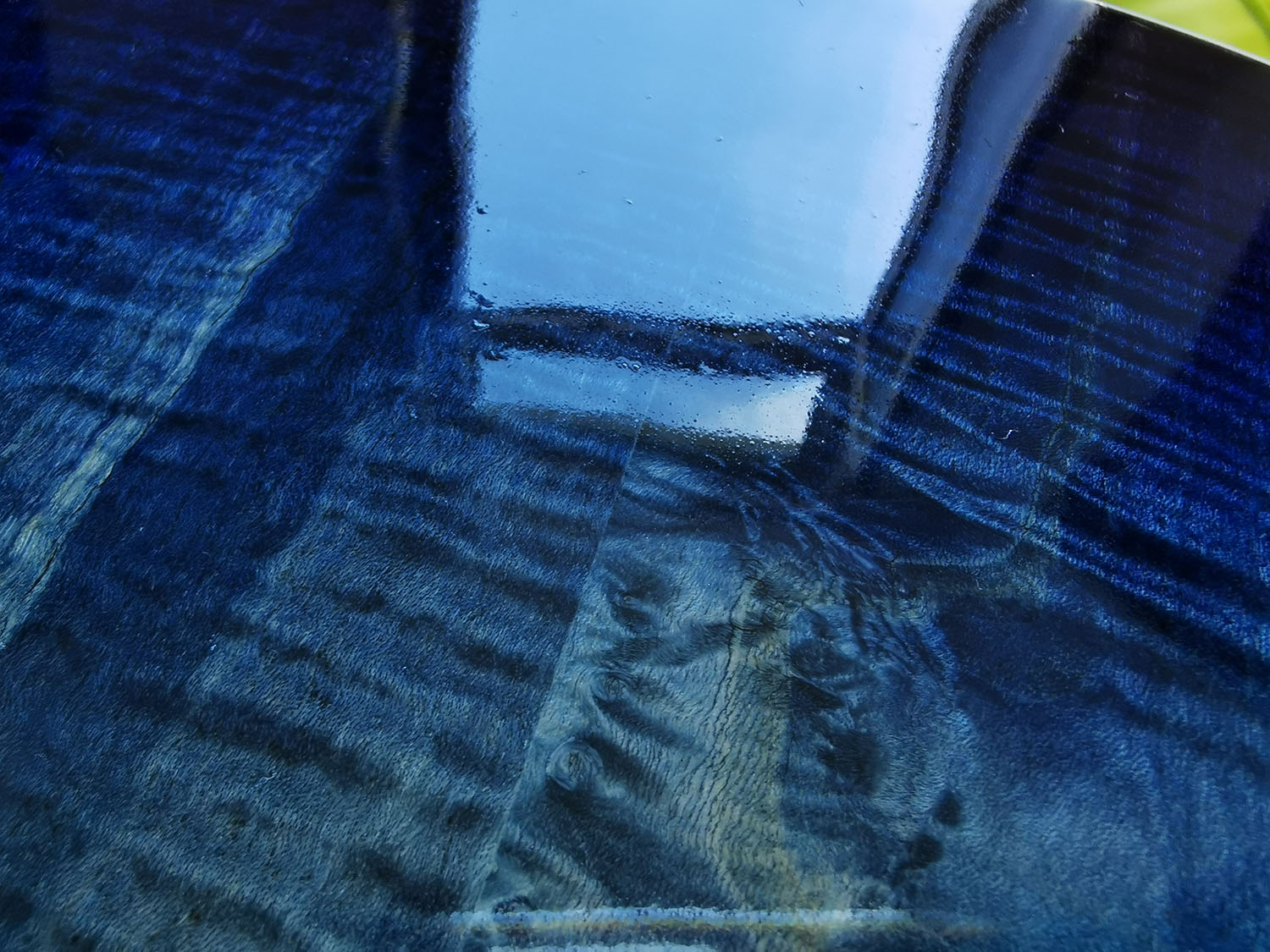

    Here is a close up of the dust problem. The thing is, when I apply the poly, it looks all great and smooth, but when it's dry, all the dust appears. It looks like it got already applied with the poly, because it's not sitting on top. This time, I took a lab grade cotton paper towel. It's guaranteed to be lint free, unless you really rub it to pieces of course. But still....
    I should probably just let go of the idea of getting a glass like mirror smooth surface. Because it's pretty obvious it's way above my skill level.

    I think that's pretty normal. When it's wet it looks perfectly smooth. When it dries it literally gets smaller as the solvent evaporates, and it shows more flaws. If it were me, I'd apply enough clear coat to be able to sand it pretty flat.

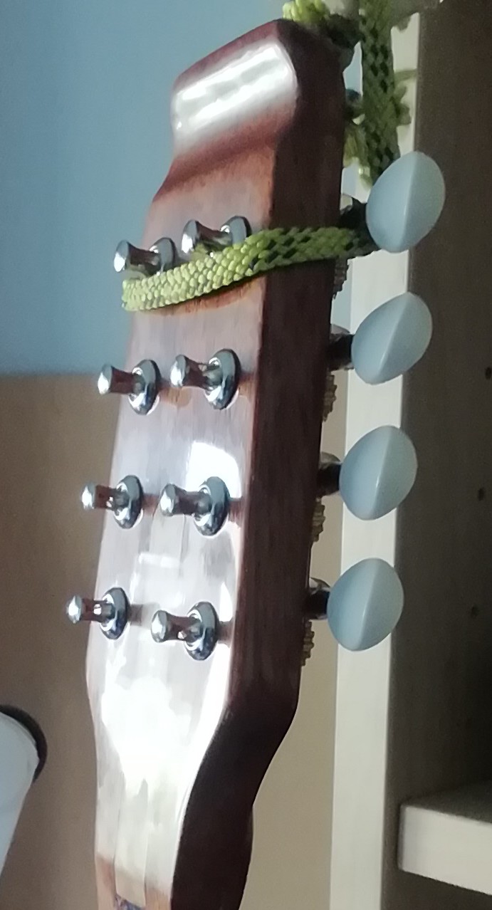

    You're nearly there. There was a lot more dust on this headstock before it got its last sand and burnish, and I think it's decent enough. It's just a question of getting a good feel for the sand through problem, and once you get that down you'll be needing to change that rapidly becoming inappropriate screen name...
