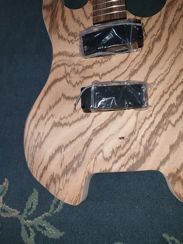

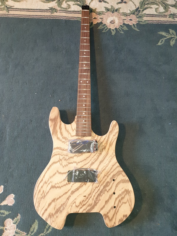

    I had looked over the pics from the original online posting and had a couple of concerns. The bottom left bout of the body had a slightly different shape to the right side, and a hole or gouge or something appeared on the fingerboard.
    Well upon arrival I see that the difference in roundness is due to the belly cut....phew.

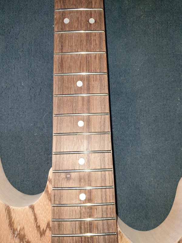

    The fingerboard mark is a knot.
    A really close inspection of the neck shows it to be to me a proper Rosewood fingerboard. I have a couple of the engineered ones and this looks nothing like it.

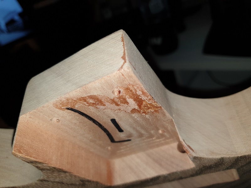

    The neck pocket has a split and a tear. The tear is along the bottom side of the neck pocket. It appears that the broken piece has been glued back in. I shall inspect further. The split appears to have been glued back together in the bottom of the neck pocket starting at the top down to the first neck screw hole.
    The veneer feels really thin and the edges of the pickup routs show no depth of wood at all. So, I am not really interested in sanding the top at all. I don't think I will even fill the timber, which it needs. But, I think I will spray a pile of the polyurethane by Cabots....then sand flat and repeat until it is sealed and level.
    The neck appears flat and not really having much in the way of grain to highlight. I am going to strip the headstock metal end off and put it away safe. I think then tape up the finger board and sand, pore fill, stain, oil, then wax. That gives a nice depth to wood and a satin smooth sheen.

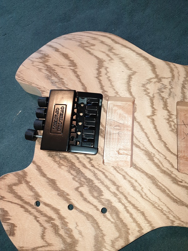

    and some more and the neck pocket....on the next post.
    more nice arrival piccies....and no headstock shape to cut and fine tune.

    The neck pocket.
    Neck pocket. I think this is doable and will go well.

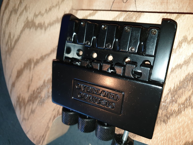

    The infamous 'Overlord of Music' bridge... it's where the forum title came from.
    Mentor ozzbike's Avatar
    Sunshine Coast, Queensland
    1,109
    Well that explains a few things. Ha ha.
    It is really heavy.
    Mentor blinddrew's Avatar
    Apr 2018
    York, Uk
    1,122
    Yeah, what it lacks in precision it makes up for in mass!
