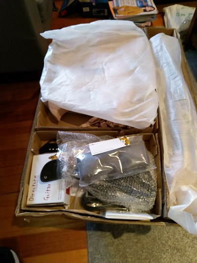

    Just got the kit, It's a factory second due to a chip on the bass-side horn and a bit of a mismatch of the halves, but that's fine. I like Junior-style guitars and P90s. You can't have one too fancy - wouldn't be a junior.

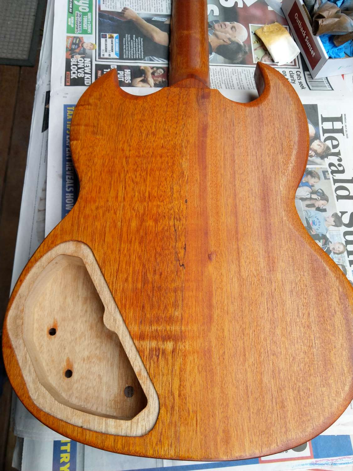

    I'm going to try the Dingo Tone brown finish on it.

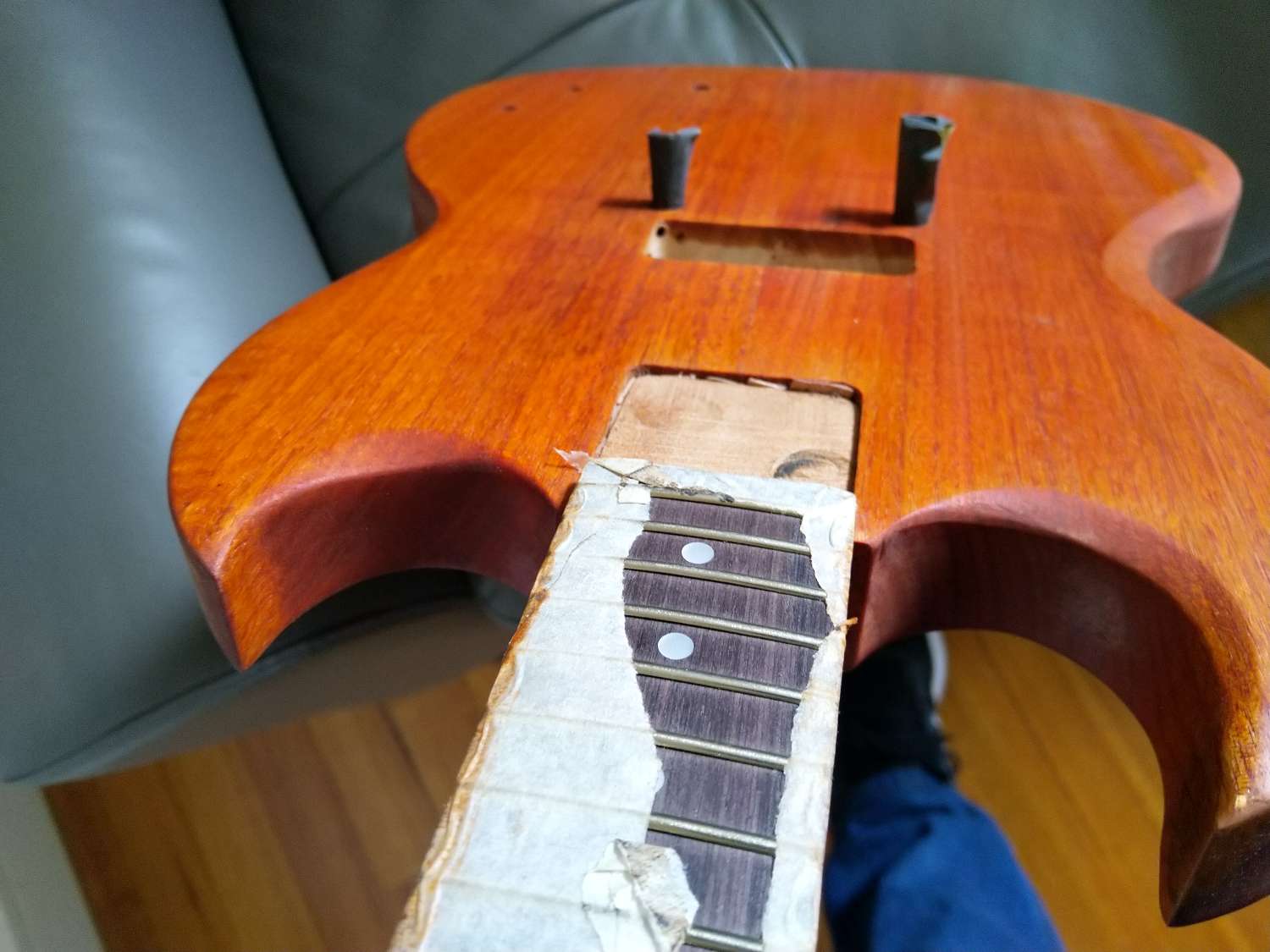

    So far, neck pocket is sloppy, but that's no biggie. The parts like bridge, Kluson style jade-tulip tuners and so forth seem good. Lightning bar bridge. I may cut a tortoiseshell pickguard but the kit one's not bad.

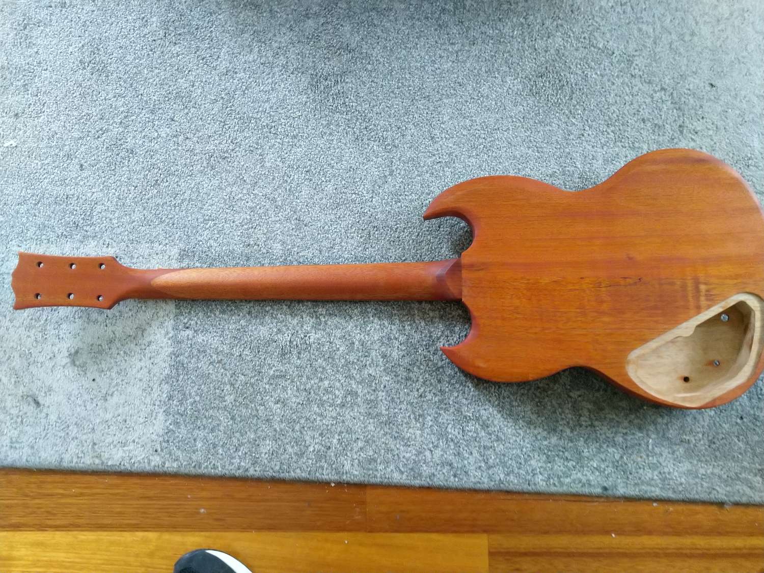

    I like the neck and profile, nice bit of rosewood it appears. Frets appear pretty good, but I'll do a light cut and crown.
    Cut the headstock to the open book shape while the putty's drying. Put a small ding in the body (d'oh!) so putty on that too.
