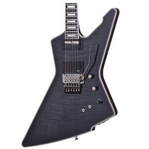

    Also, you could cut out even more like Schecter did. They also cut an equal amount from the bottom for aesthetics.
    https://guitar-compare.com/wp-conten...rets_Guide.png
