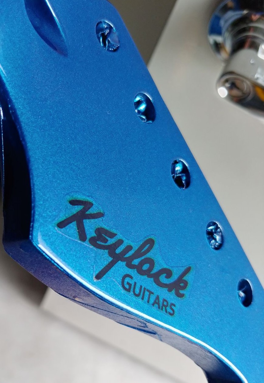

    I could either keep spraying clear coats until I have enough build up to W&D it back flat, or I could block it back, taking off the decal in the process then try again.
    I sprayed over the wrinkled sticker - about 5 coats of clear - and the sticker flattened out perfectly. No more wrinkles. Hopefully it will stay flat while the clear dries.
    Can't believe it.
    ....but it didn't. The wrinkles came back, although not as bad as before. Perhaps the answer is to keep spraying clear coats until it does not come back at all.
    Another problem surfaced. The black ink on the inkjet decal bled a little.
    Here is the first photo of the head with bad wrinkles:

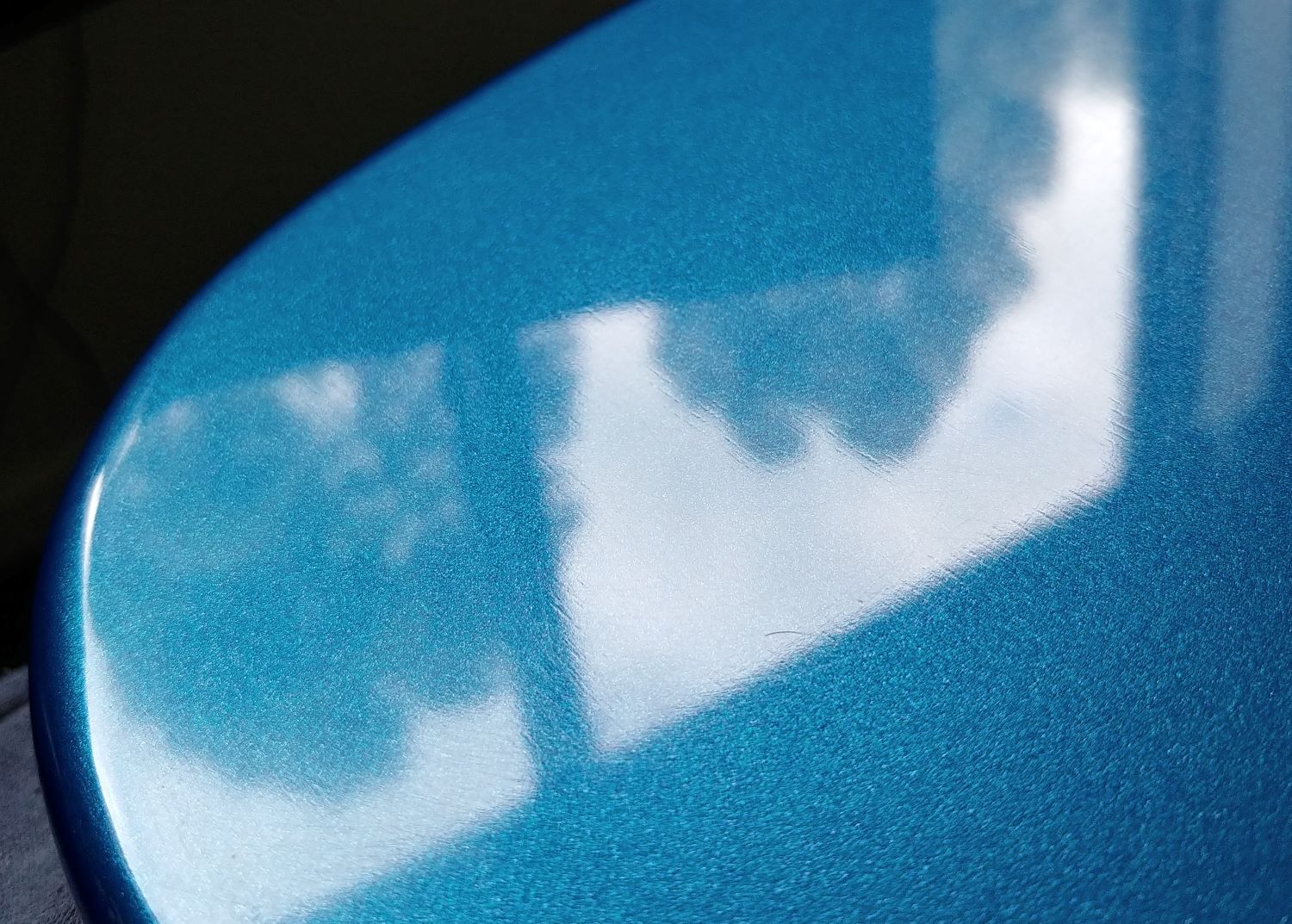

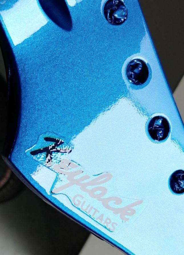

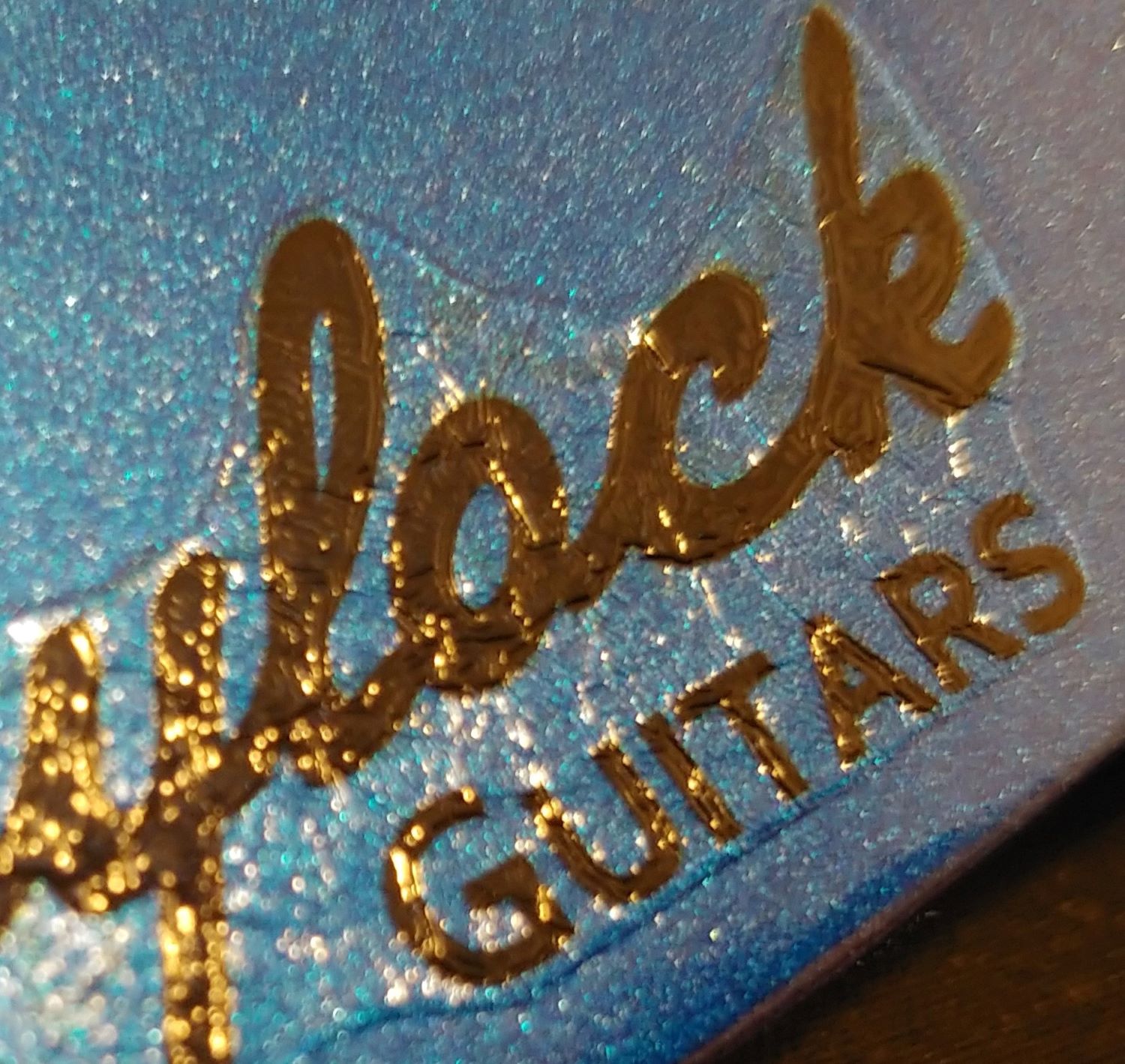

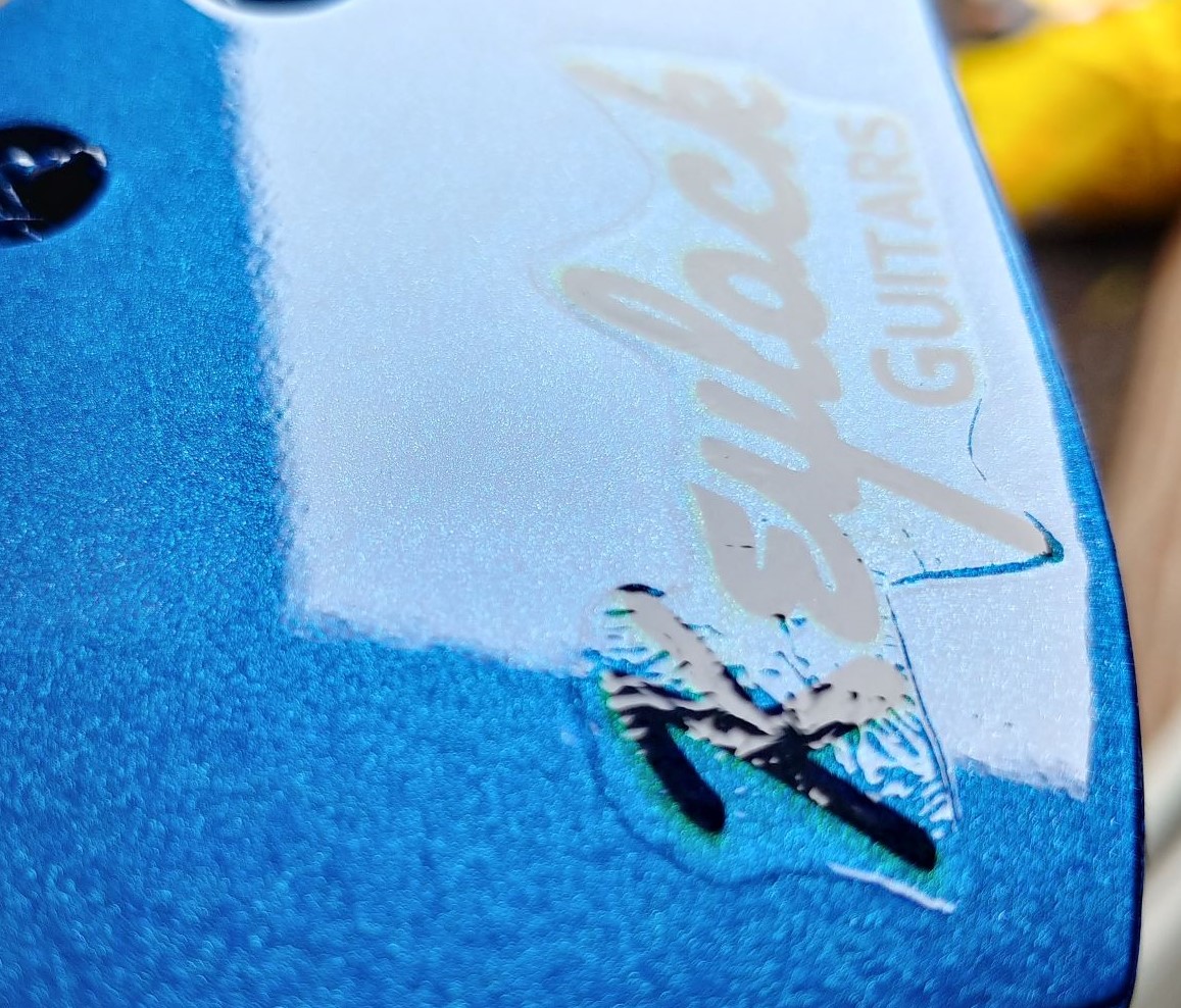

    Here are some photos after the coats of clear. You can see wrinkles from some angles, but from other angles it looks great. The edge of the decal is prominent, but I am hoping it will be less so when I block it back with W&D.

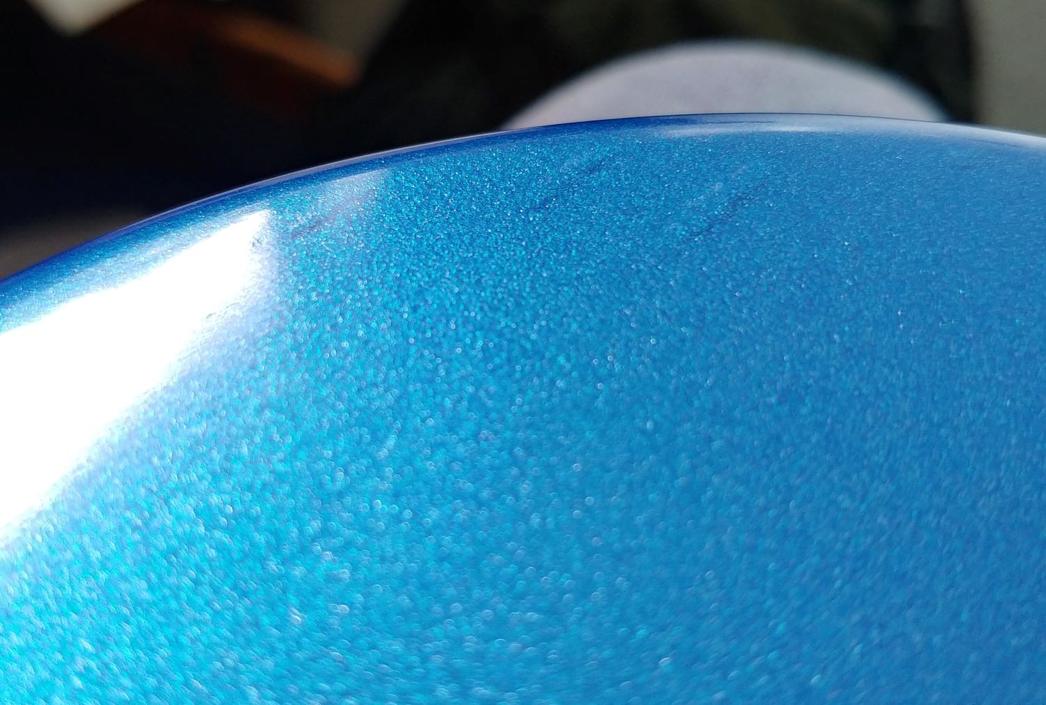

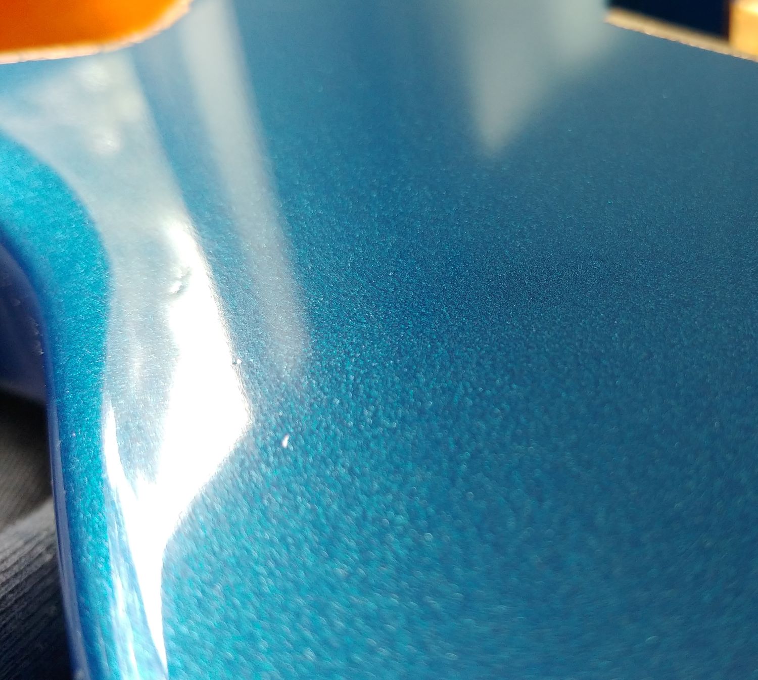

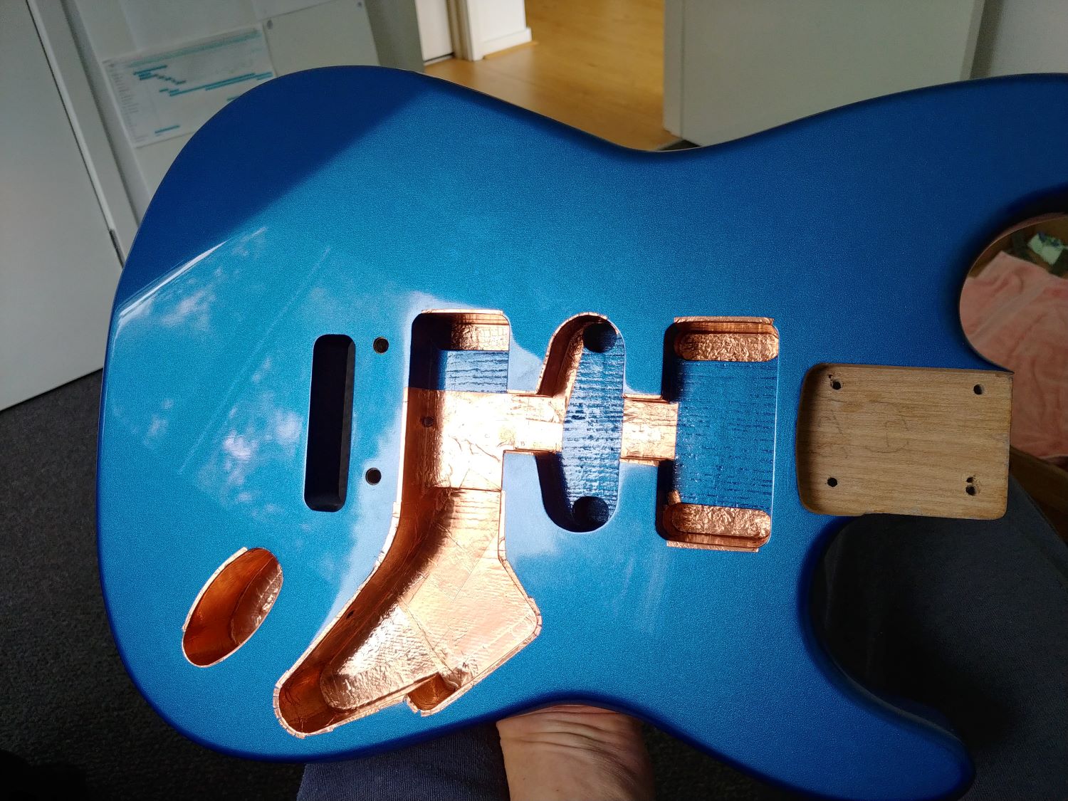

    The body came up well. Overall it looks flat, reflects well and looks good. However there are several imperfections and if you look close you can see scratched, pin holes and the grain pushing through yet again. I don't mind the grain though. You have to look close to see it and it reminds you of what is underneath. The finish feels super smooth after polishing.
    Here is the body before polishing. You can see plenty of orange peel and grain showing through.

    This is an overall shot after polish. Looks fine I think.

    Here are a few imperfections. I don't want to try to W&D them out because I am worried I will go through the clear. Besides you have to look close to notice them.
Name:	Body after polish 3 shrunk.jpg
    These marks are interesting. I put the body down on a the cardboard box it came in. Even though it had been several days since clearing, the paint was still soft enough to make a mark. Even though the clear is blocked flat and polished the mark still shows, so it must be in the colour coat. I don't mind it though.

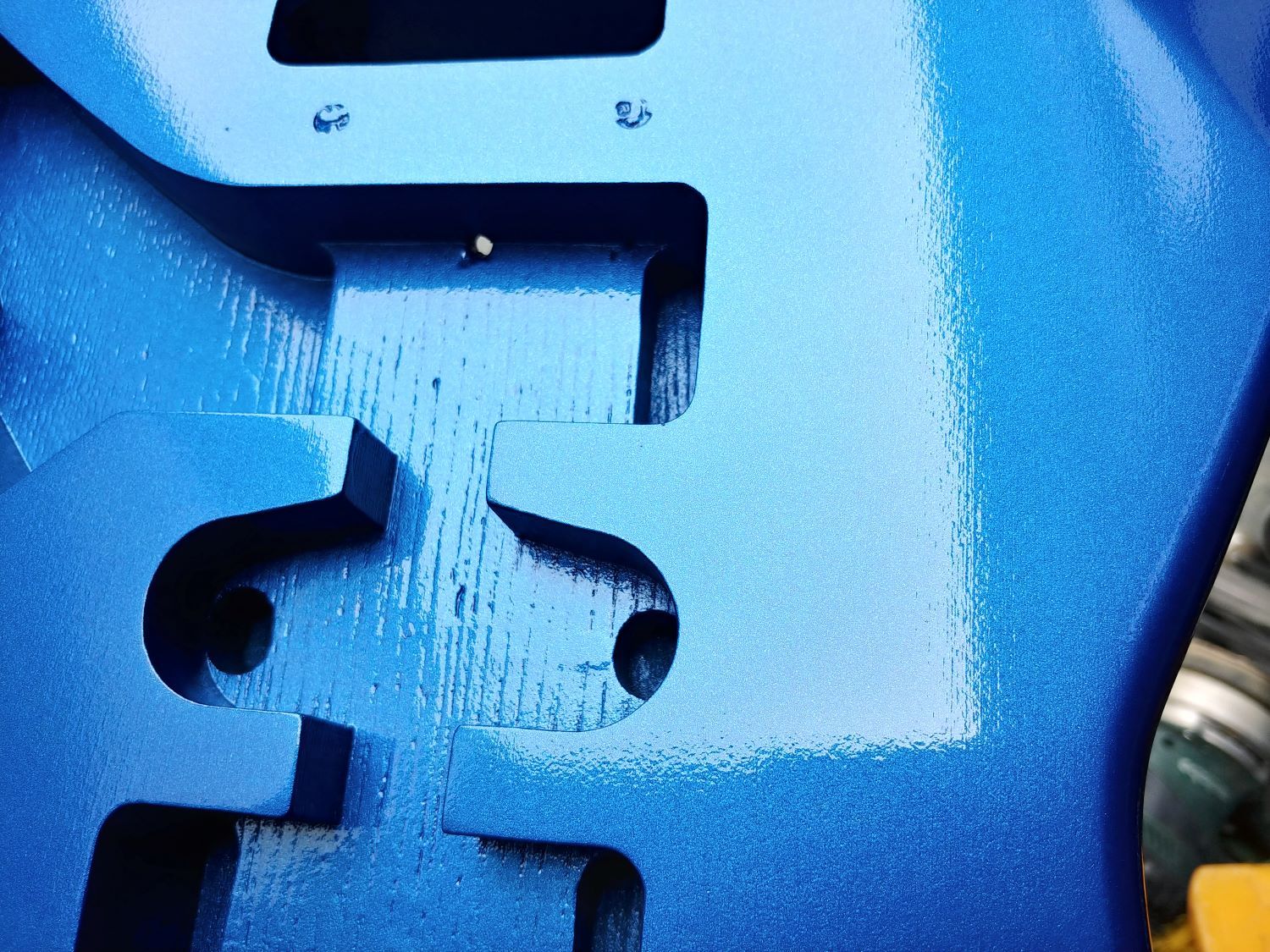

    And here you can see the grain showing through. I left it for about 5 days before sanding. After sanding it was perfectly flat and since then the grain has pushed through a bit. Again I don't mind it because you have to look close to see it, and it reminds me that it is wood underneath.
