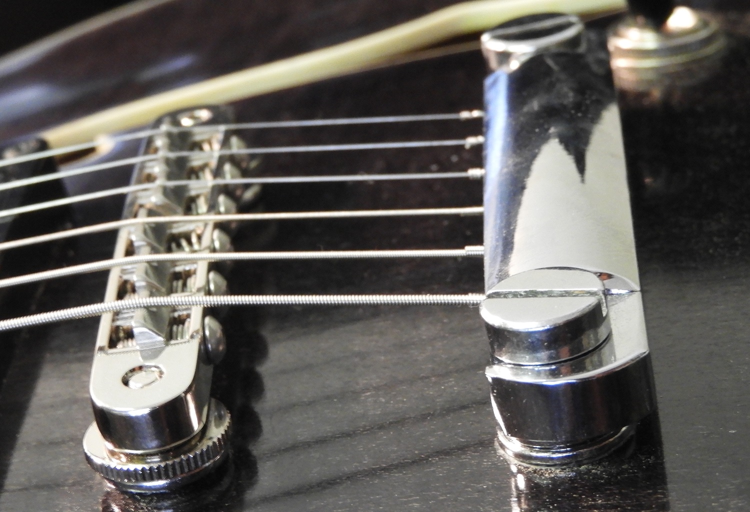

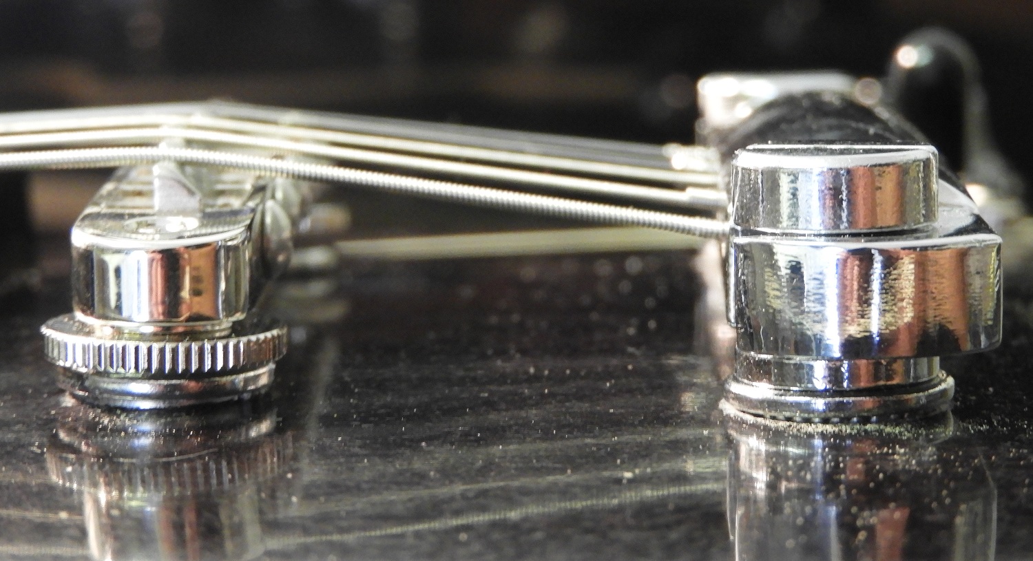

    Can you measure the height from the base to toe top of the highest saddle? I need to try and find a lower bridge to make my ES3 playable. I did the bridge base filing thing for my ES-1 (yes the neck angle is really too shallow on that as well) but that's not good enough for the ES3. If it's less than 12mm then that's better than what I've got. 10mm would be nice!

    The Goldo bridge has the standard Gibson US post hole size with 4mm threads on the bottom to screw into the inserts. It's easy enough to get the converters that have an 8mm lower thread for use with most Asian-made guitars and the Pit Bull kits.
    I've bought a bit of ebony so I may well make myself a low floating bridge if this Goldo low-profile bridge is too tall to work properly. I've looked on the Goldo website but they haven't got any dimension drawings. Just saying 9.7mm height is very vague and could just be the main body height. But saying that, as Gregs pic has the 8mm wide posts in view, it does look to be around 10mm in overall height, which is promising. I need to go and do some more measuring on the ES-3 and see if that' good enough. I haven't been able to look at it since last year as I was so disappointed with it.

    Simon - I have done the measurements and agree with Goldo that the height of the bridge is 9.7mm. That is if the bridge is sitting on a flat surface and measuring the height to the highest saddles (middle two). I also got a measurement of 10.7 from the top of the knurled adjuster to the top of the string on the 4th saddle.
    You could also save 1 to 2 mm by using bushes without the rim. But I guess you would need to be real careful not the scratch the finish when doing adjustments.
    Maybe you could slip across the channel and get half a dpzen for us. hihi
    XP - You will notice in the photos that the break angle from the bridge to the tail piece is fairly shallow. From my limited knowledge I would think that that looks close to as shallow as recommended by the experts. I have no string buzz so that angle is fine.
    I am extremely happy with the tone and playability of the ES now. Even with the standard kit pups for the moment.
    Goldo does have matching tail pieces but they look pretty standard in size and shape. Not "low profile". I did order one but they didn't have any in stock. It was replaced with a Gotoh GE101Z . Holes in the ES kit were very tight (distance apart) The PB stock tailpiiece originally fitted with a bit of effort but he Gotoh was a fraction wider and I chickened out halfway through really having to force screwing it down. So now have the PB tailpiece back in.
