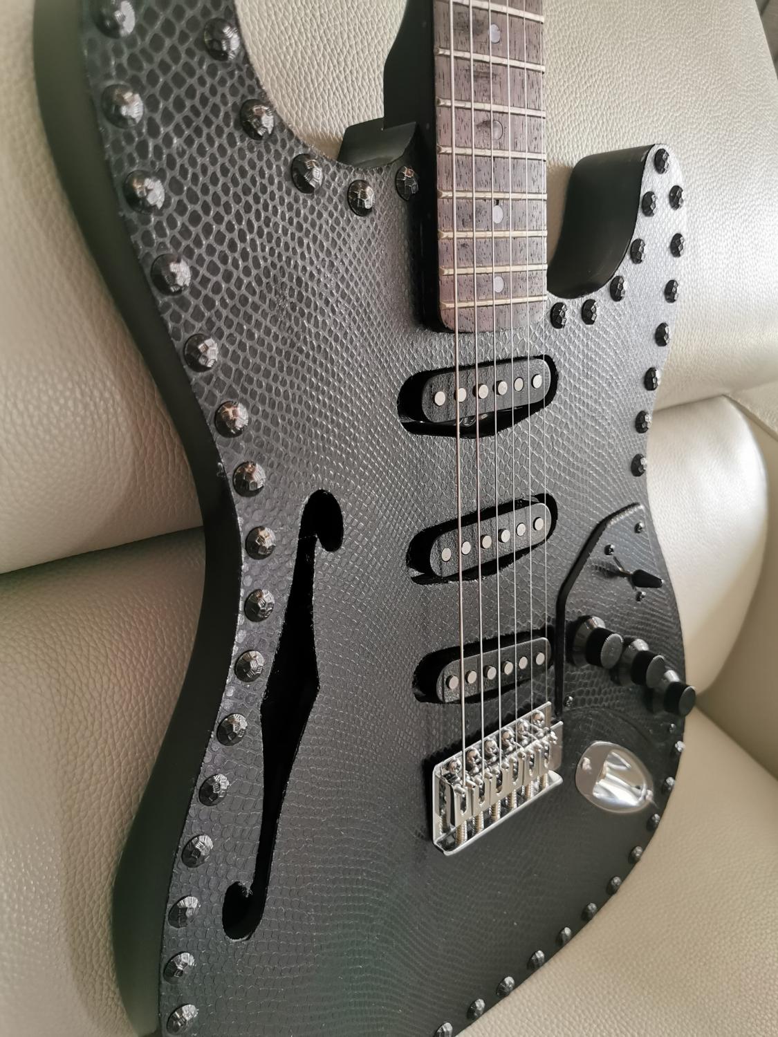

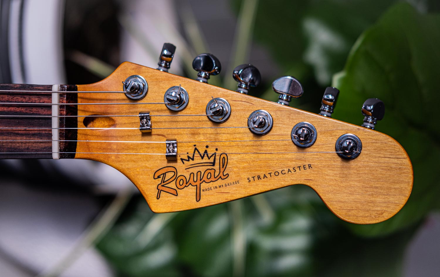

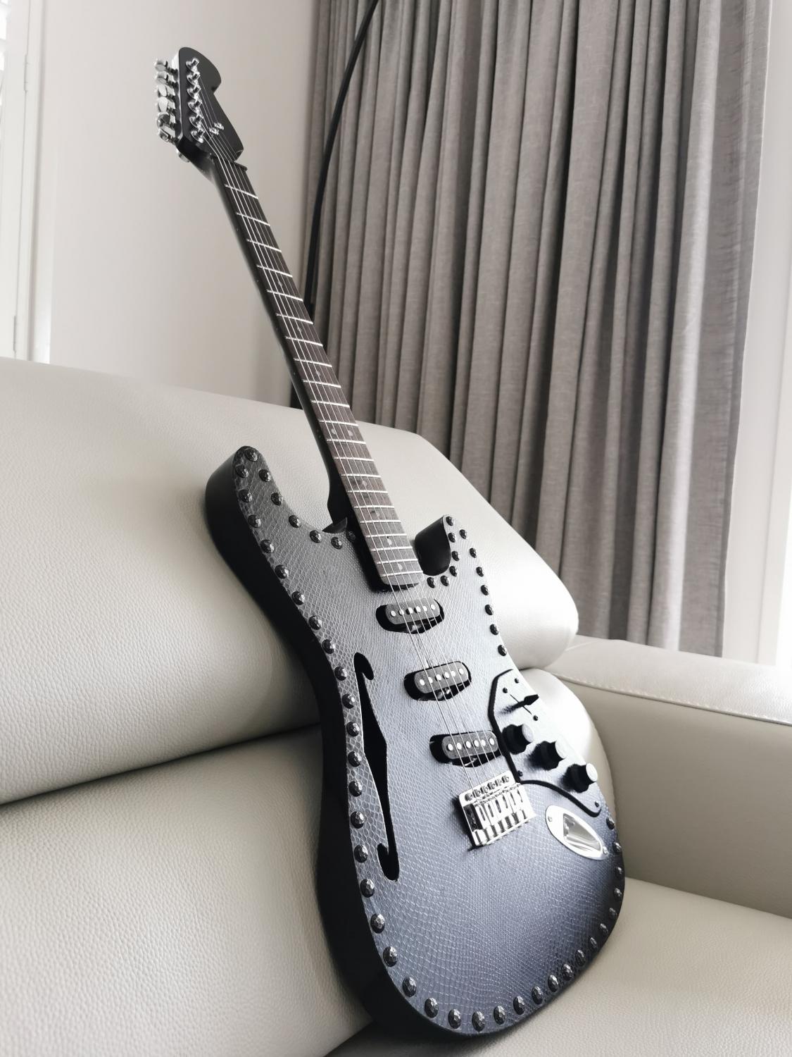

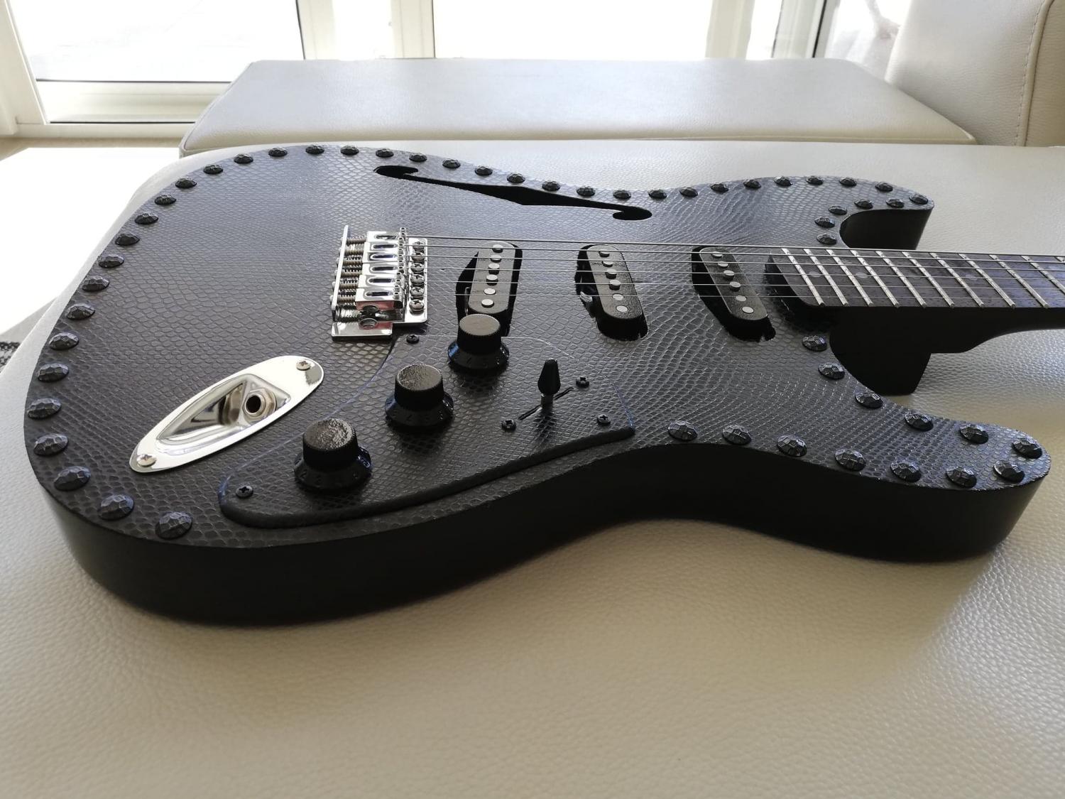

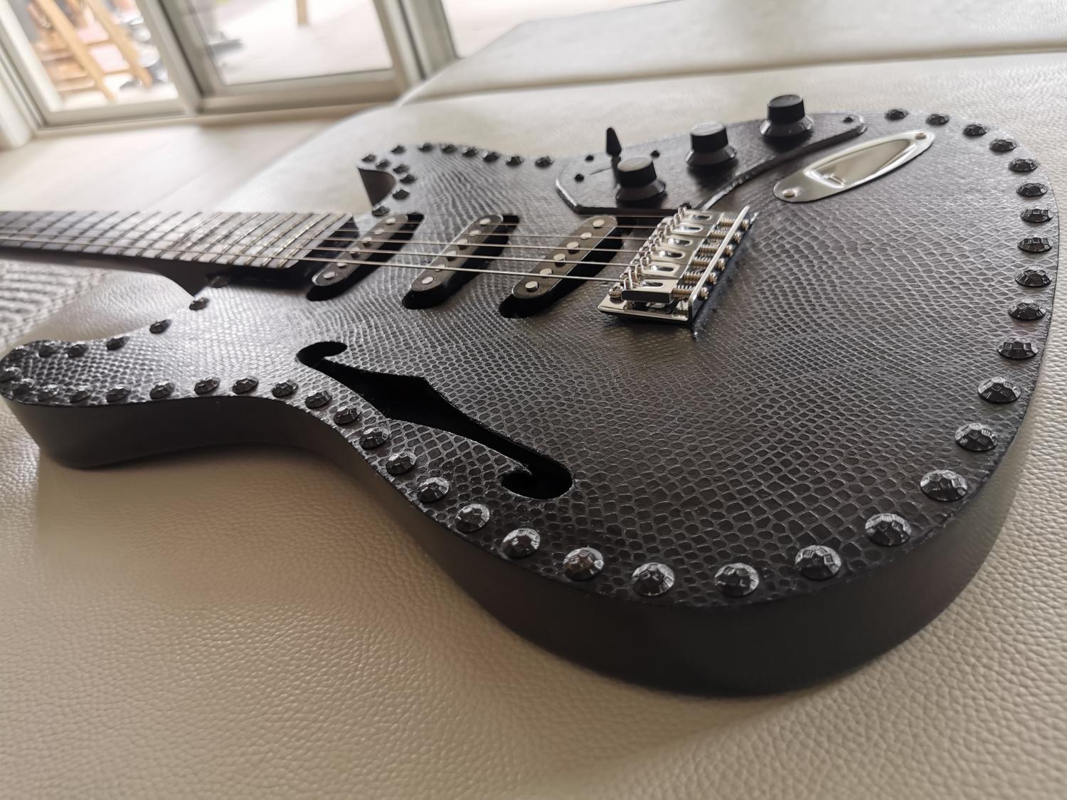

    This is my second build, a thinline strat kit.
    Thanks again to Adam and PBG for their great products and awesome service.
    Body - alder/maple
    Neck - maple/maple
    Finish - snakeskin (embossed leather) & copper rivets (front), black Keda dye & tru-oil (back/neck)
    Hardware - standard kit hardware, Grover mini locking tuners, Corian nut
    Electronics - Alexander Pribora "Custom Hot", Gotoh pots & Sprague orange cap, 1V/1T/1Blender, treble bleed mod
    Kit was a joy to build.
    Kit neck and fretwork is great (with a little elbow grease), action is 0.2mm at 1st fret and 0.5mm at 12th fret, super-smooth super-fast and no dreaded fret buzz.
    Personally, I like to leave the back cavity cover off and let the trem mechanism show - I think it's a nice detail, not unlike the complication of a watch.
    Thanks for looking

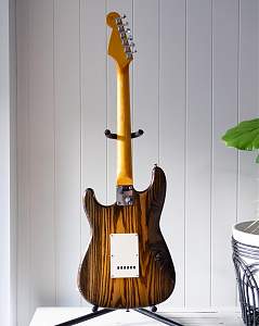

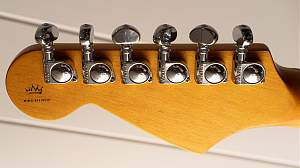

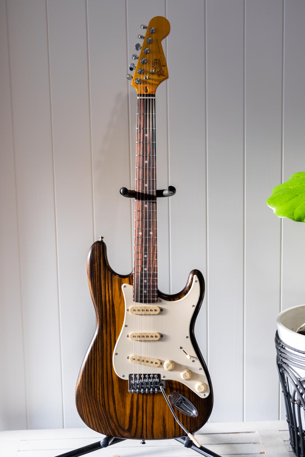

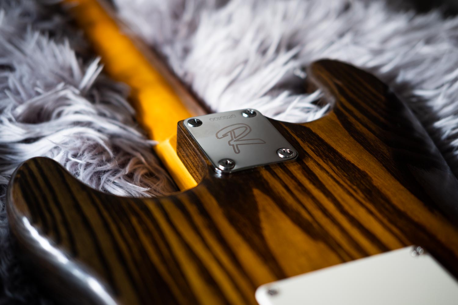

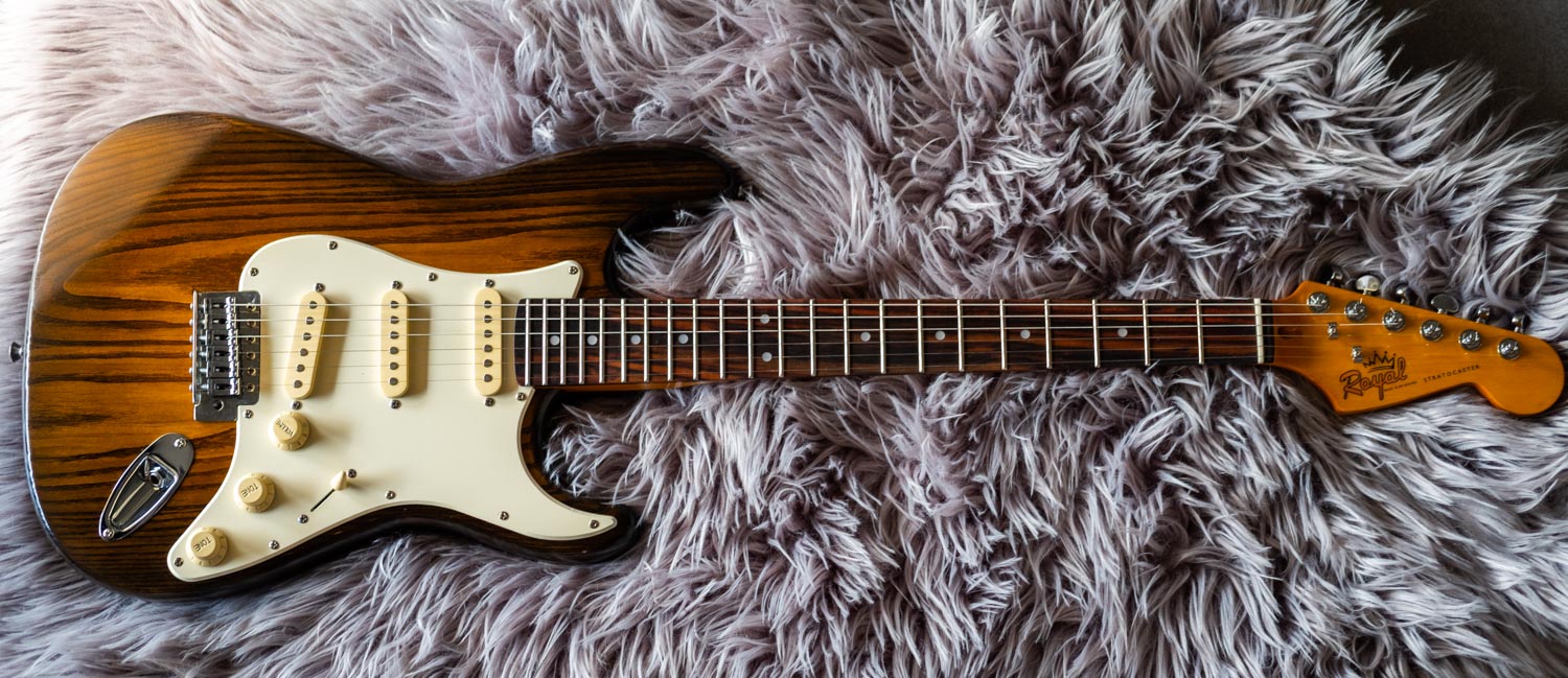

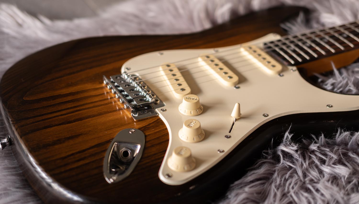

    Hi guys,
    Just finished my first build, a GST-1.
    Ash body, Jatoba Fretboard, locking tuners, bone nut, everything else was standard. I wanted to keep the grain and go for a kind of natural look but with some character, ended up with this!
    I will maybe look at upgrading the pickups down the track, but for now it plays well and was a very enjoyable build. Off to order another kit now
    Cheers
    Mitch
