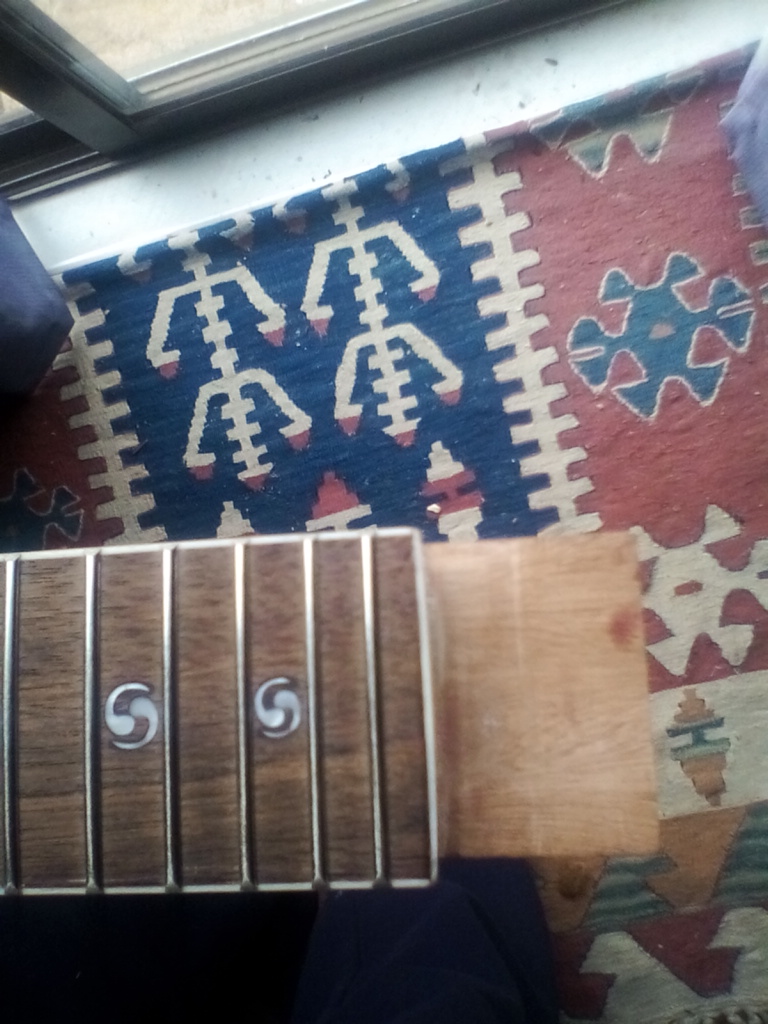

    Change of plans, I ended taking 6mm off the end of the fretboard and regluing the binding, the new covered humbuckers had a slightly larger footprint and didn't quite fit, now I have ample clearance.
    I've also added a MOP inlay to the heel.

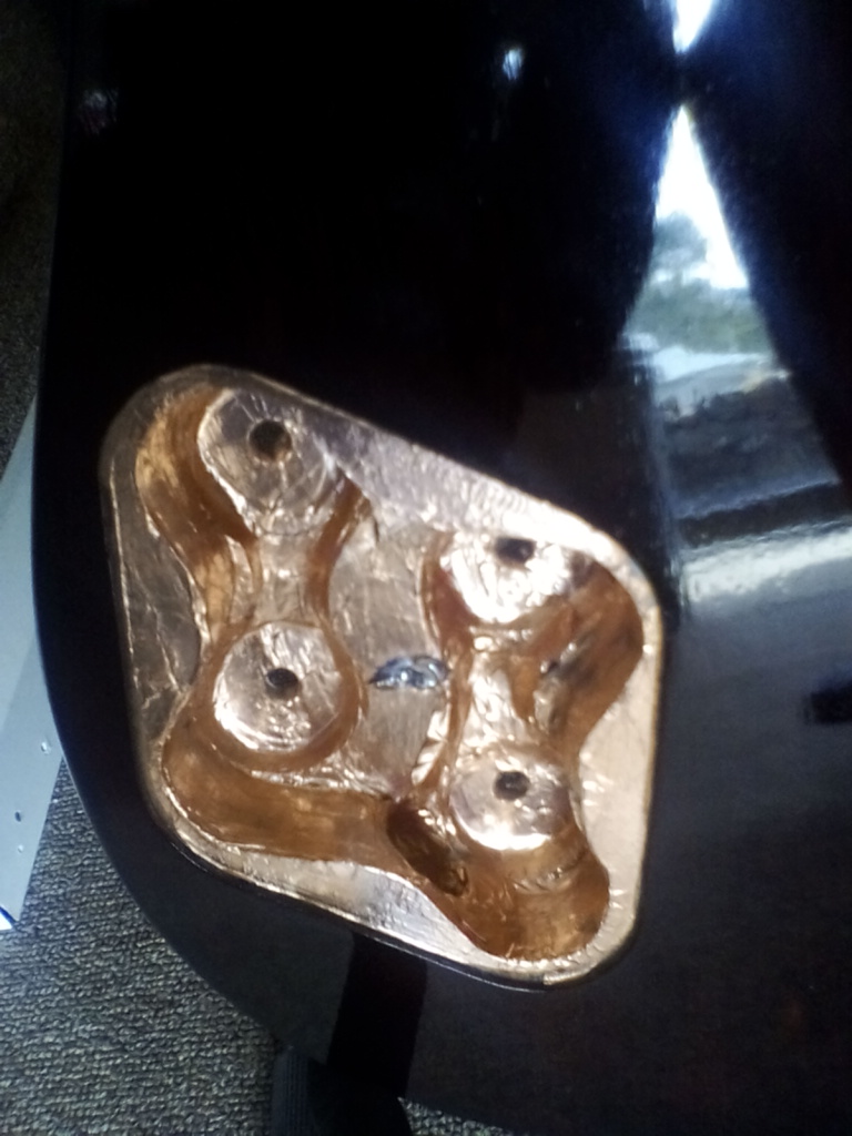

    My wiring set up is a little complex, it's a LP, Jimmy Page setup with a split ground circuit, it should be silent.
    I'm using gotoh push pulls, artist bull buckets, orange drops.022, and a gotoh ³ way . Swtchcraft jack.bridge ground is soldered to the copper sheilding.
