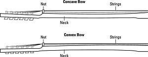

    Hello ! I currently have a small problem: I am currently drilling the holes to screw the handle and it turns out that when I put the biggest rope, it touches even when I adjust the height to the maximum (I do not have still screwed the neck) after comparing with my stratum I wondered if the handle was not too thick? If not, do you know what it could be? Thank you !

    It's a bit difficult to tell from the photos where abouts is your string contacting? Is it sitting on the frets?

    When I try to have no sound from 0 to 5 and sound(with freeze) for the rest
    I would raise the two tremolo posts up by a few mm.
    Also, make sure that the neck has a slight concave bow in it (like the top picture), and not a convex one (bottom picture).
    But you are also not going to get a true picture of how the guitar is set up until you fit all the strings and get the correct tension on the neck. That will add more of a concave curve to the neck and help raise the strings away from the frets.
    You should now be at the stage where you can screw the neck on properly rather than clamp it.
    After rise the tremolo spots, nobody change ! :/
    I don't have the special straightedge and I don't really know how to check the neck without it ! :/
