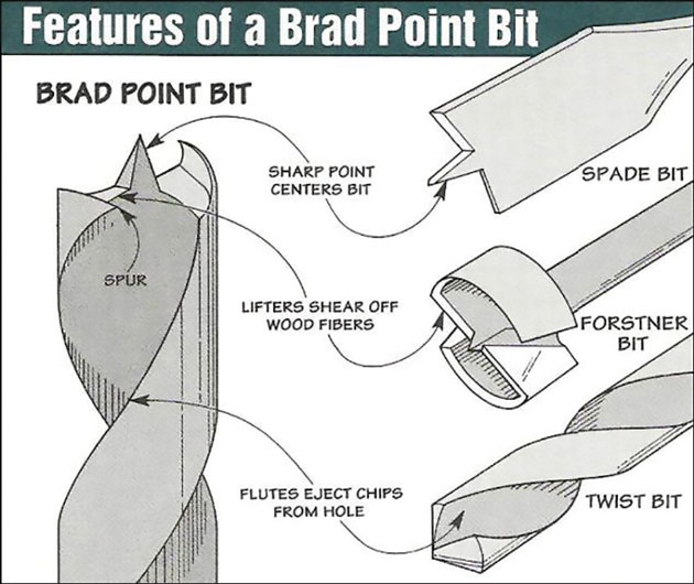

    If you can find them try getting a set of Brad Point drill bits as well as the normal ones:
    https://www.amazon.fr/ENT-Ensemble-r...s+1mm+perceuse
    These cut better and cleaner, the standard drills can wander/move from your mark as you try to drill.
