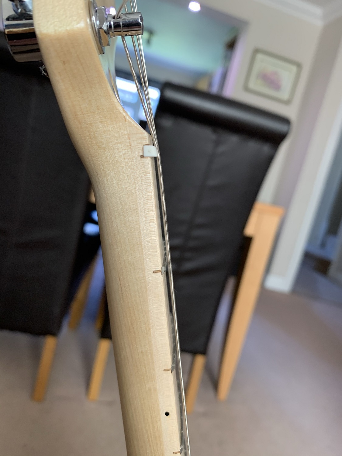

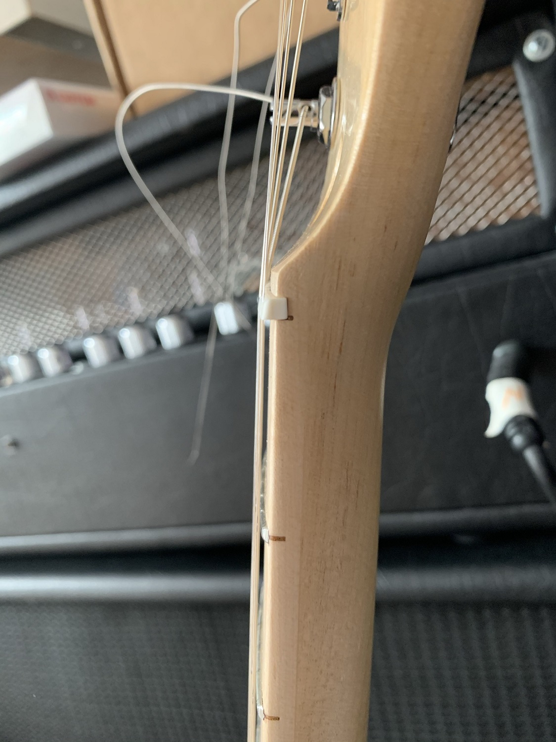

    I used the copper tape that came with the kit (DingoTone?). I must have ticked the box twice because I ended up with two lots in the package and I needed all of it. After cutting my self the first time I used the handle of an old tooth brush the flatten it (maybe it needs to be metal). But some while casually fiddling with it during conference calls on Friday I cut myself some more! (never learn)
    Yes, the wound strings need to come down. But I'm not sure there is enough height for that. I have some feel gauge so I'll measure it. Looking at the pics the nut slot seems too wide for the nut and there's this add channel at the front of the slot which is preventing it from sitting flat.

    It almost looks like the nut position has been cut for a zero-fret, and then routed for a nut. I had a touch of that on the GST-1. But either the nut is slightly too narrow for the slot, so it's being pulled forwards, or else the base of the slot has been cut at an angle. Or it could be a bit of both. But it does rather look like the slot is at a very slight angle. You can level the base with a needle file if you wish.
    It does look like all the string slots could come down slightly, though they are better than on a lot of guitars I've seen.
    Yeah, I wonder if I can fill the slot at the front and then make a new nut from the blanks I’ve got on route that will fit the slot properly.
  10. #169
    If you've got your nut files coming, then yes, it's just a question of cutting down to size, filing and sanding (wear a mask as bone isn't a nice dust to inhale). You don't want to file the fretboard side of the slot at all, or you'll affect the intonation, albeit very slightly. Just do enough to remove any glue from the front face of the slot, and concentrate any filing on the floor of the slot, (and the rear if you must). Better the blank is a bit wider than the slot, so you can then sand the blank down to fit the slot after the slot has been filed.

    Yeah, that's a pretty ordinary job of cutting the nut slot for sure.
    I have a 3mm jeweller's screwdriver that I filed into a "chisel" (more of a scraper really) that's perfect for removing glue from the bottom of strat/tele nut slots. It also works on the sides without the danger of widening or distorting the slot as can happen with a file. The sides are easily scraped with a hobby knife blade as well.
