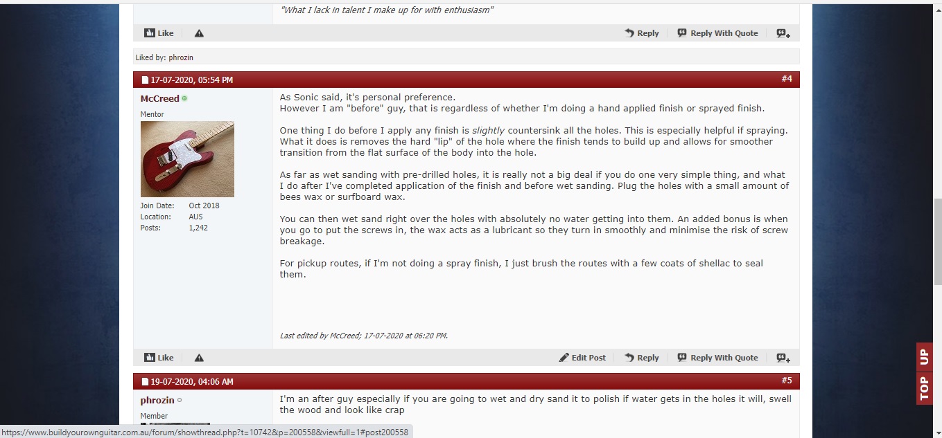

    Aaaaand then i've gone and marked it all when I've drilled the holes.
    This is one reason why I'm a big advocate for drilling holes pre-finish.
    I know, I know... people go on about the wet sanding/water in the holes etc, but my reply is always "bee's wax"!
    Drill the holes; apply the finish; plug the holes w/ bee's wax; wet sand/polish; done.
    The wax is extracted when you turn a screw in, and what's left behind acts as a lubricant for smooth turning screws.

    Hamburg, Germany
    333
    Great idea, actually! But how is staining with the holes filled with wax? If you get a tiny bit of wax on the surface, it surely won't take any more stain?
    Or do you do it even pre sanding?
    You don't fill the holes until you're ready to wet sand. So the finish has already been applied and cured.
    EDIT TO ADD:
    Here's a screenshot of a post I made recently re: hole drilling and my process -
