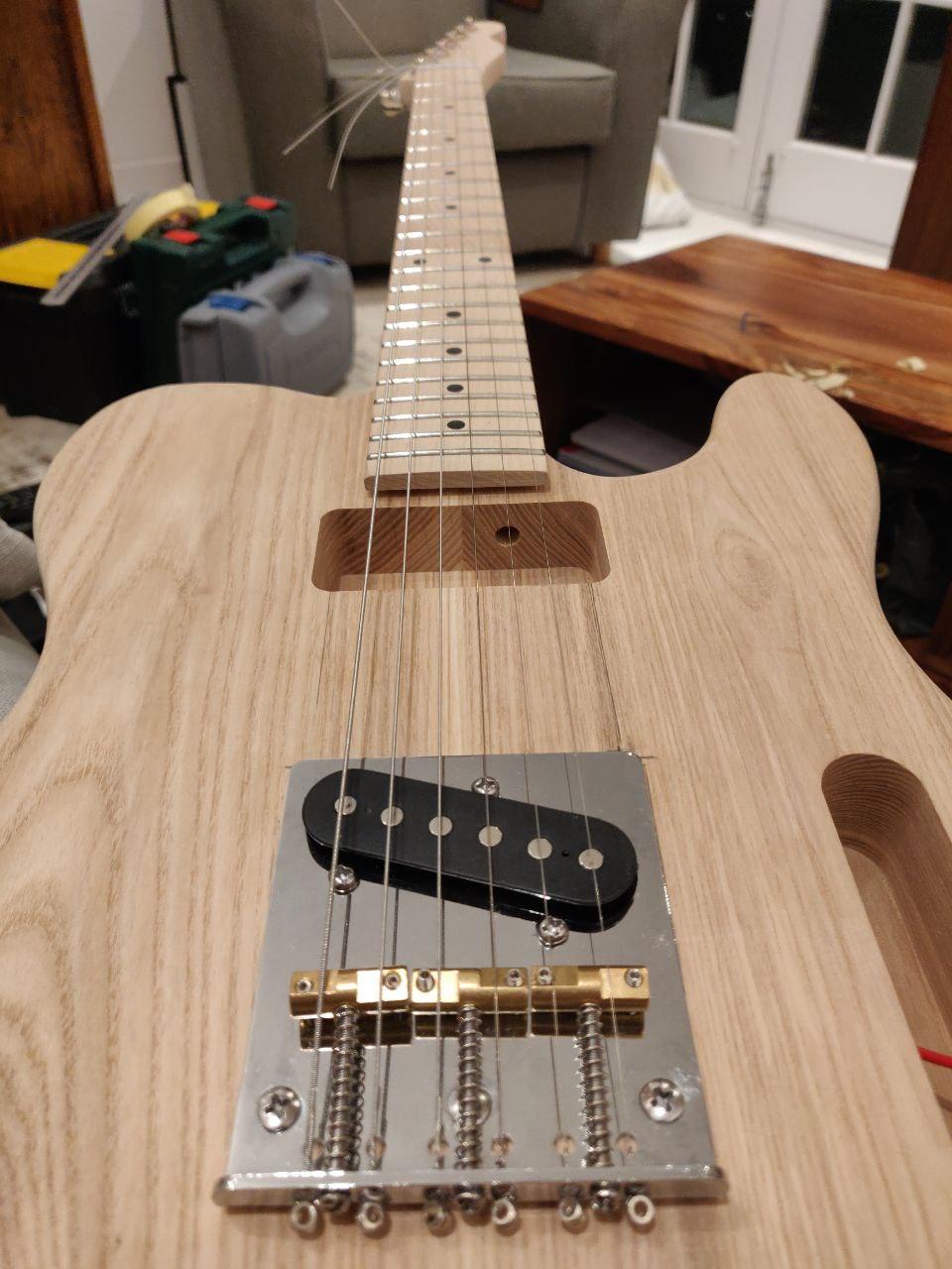

    All of the strings are perfectly centred over the slugs -- the bass E looks a bit off in the photo, but that's just parallax.
    For the amusement of those more able than I am, and the possible education of fellow newbies, here's what I did to get it all straight this time.
    Following Simon's advice earlier on, I had kept the centre hole and only dowelled the side ones. So, I screwed the bridge in place with that hole and lined it up with the line I had drawn along the nut side of the bridge when I did this previously and messed up:

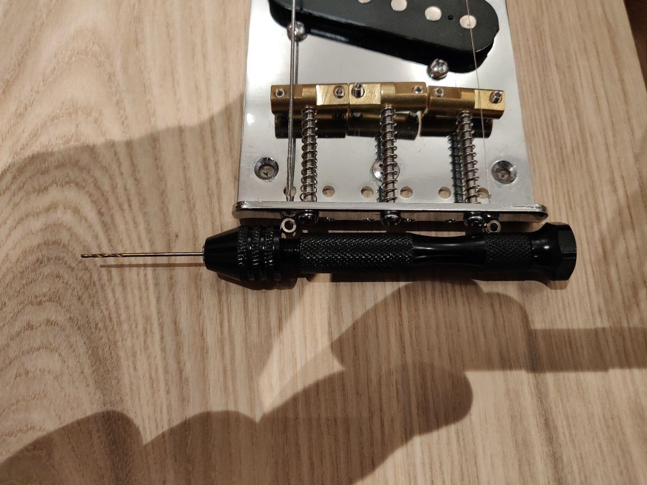

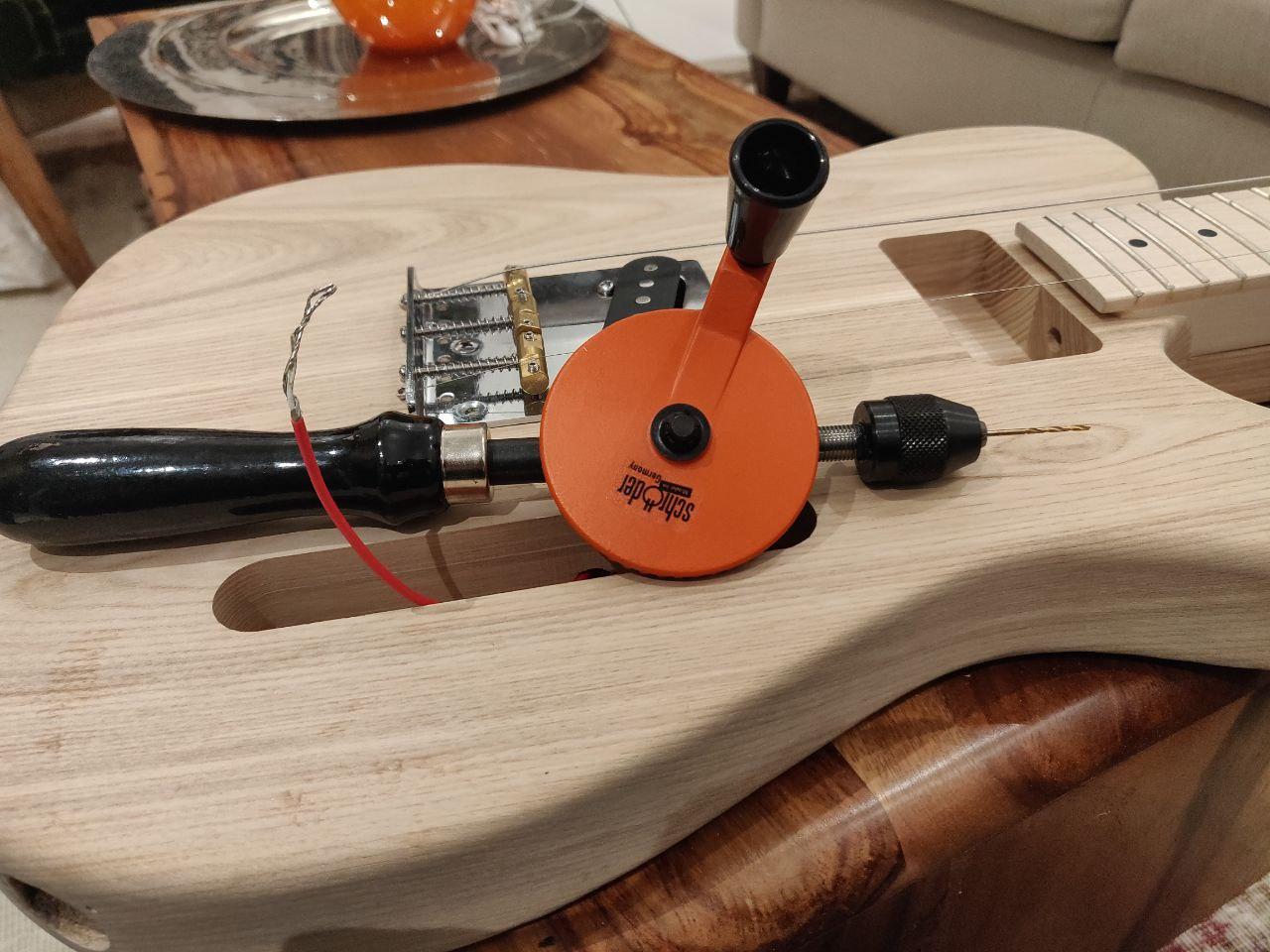

    So, I tightened the screw as much as I could while leaving a little play so that I could pivot it to set it straight, put the bass and top Es on again, and started the drilling again. This time, it was all manual tools. Firstly, I marked the centres as well as I could with the 0.5mm drill bit, then put that bit in my new £7 pin vice...

    The vice showed its discount nature when I tried to use it with the 1mm bit, though, and kept slipping. No matter, on to my other new toy:
    It was pretty pricey for a hand drill, at just short of £28, but worth every penny. Really solid, no play in it -- it just works perfectly. Very very happy with it. Amazon UK link for anyone who's interested (though in the light of the problems I've been having so far, perhaps I'm not the best person to be giving tool recommendations).
    So anyway, I used that to work my way up in half mil increments doing each hole alternately until one of the holes was 3mm diameter, then put the screw into that one, and finished the other and put the screw in that one too. And it all worked perfectly.
    As I was a bit concerned that, with all of the dowelling and drilling and redowelling and whatever, the bridge might not be very strongly attached, I decided to string the guitar up fully with the baling wire that came with the kit, and get it in tune so that it was at full tension. If the whole thing was going to fly off I'd rather it happened before I spent time finishing everything. I did so (as per the photo at the top) and left it for three days. The only issue was that the top string parted ways with its ball end (ouch) when it was somewhere around a C, so the nice Ernie Ball one was brought into service.
    Not a creak for three days, and when I dismantled everything today, all looked well:

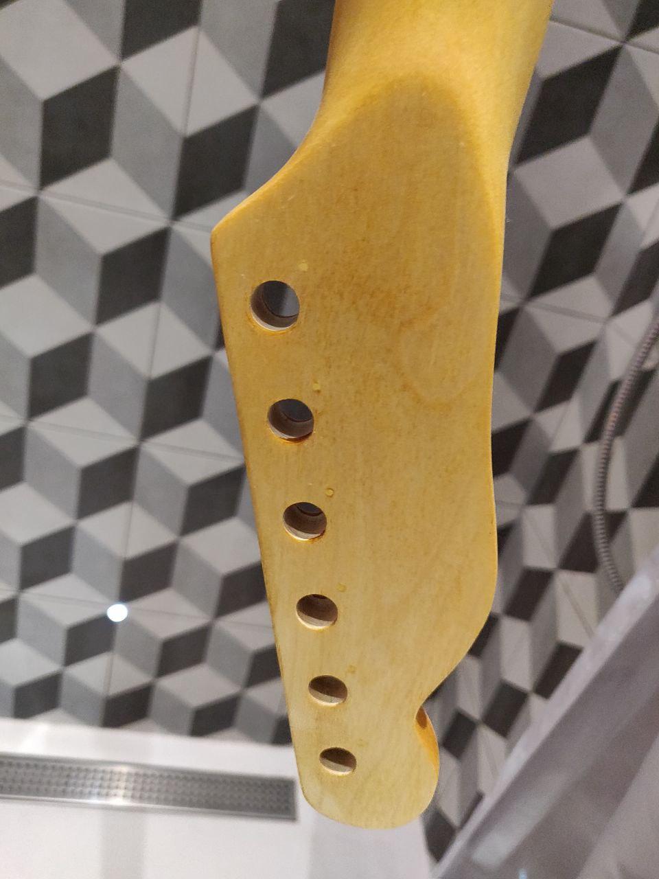

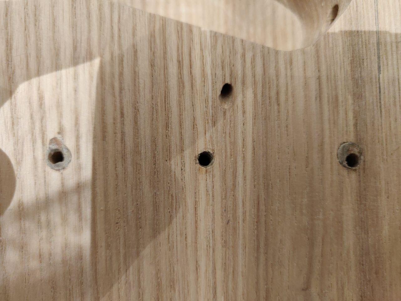

    In between bouts of feeling sorry for myself, I've managed to sand down the neck and body, then fill the old tuner screw holes with Osmo maple/birch filler (the one that auditioned best):

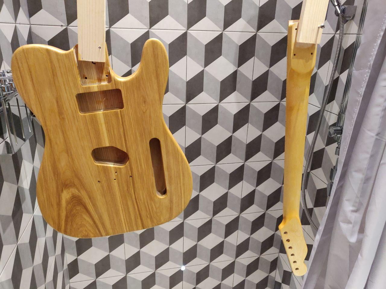

    Next, time to put on some finish. Three coats so far, Wudtone's Honey for the body, and their Aged Vintage Yellow for the neck:
