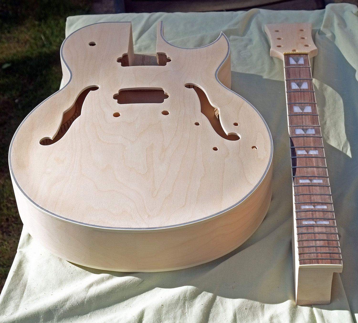

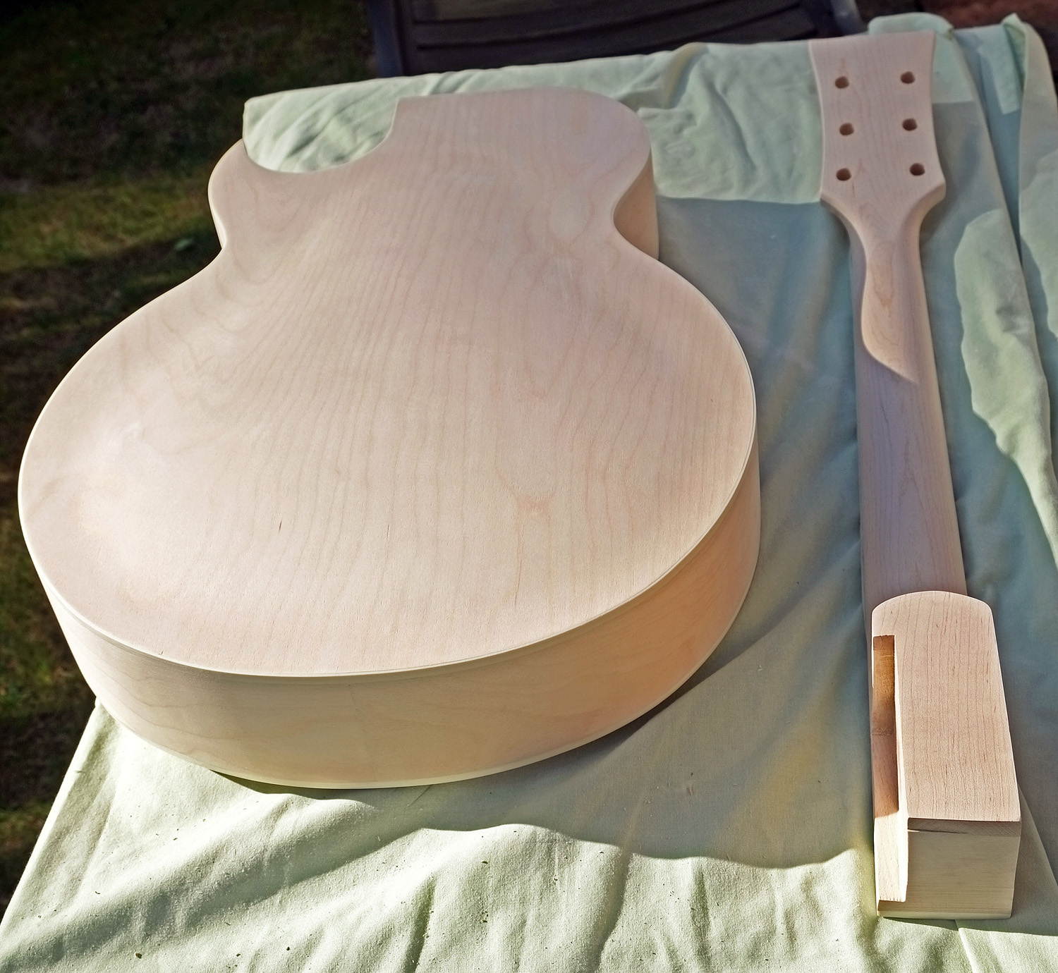

    So here's the basic guitar body and neck after its initial sanding:
Name:	175 day 1 top small.jpg
Name:	175 day 1 bottom small.jpg

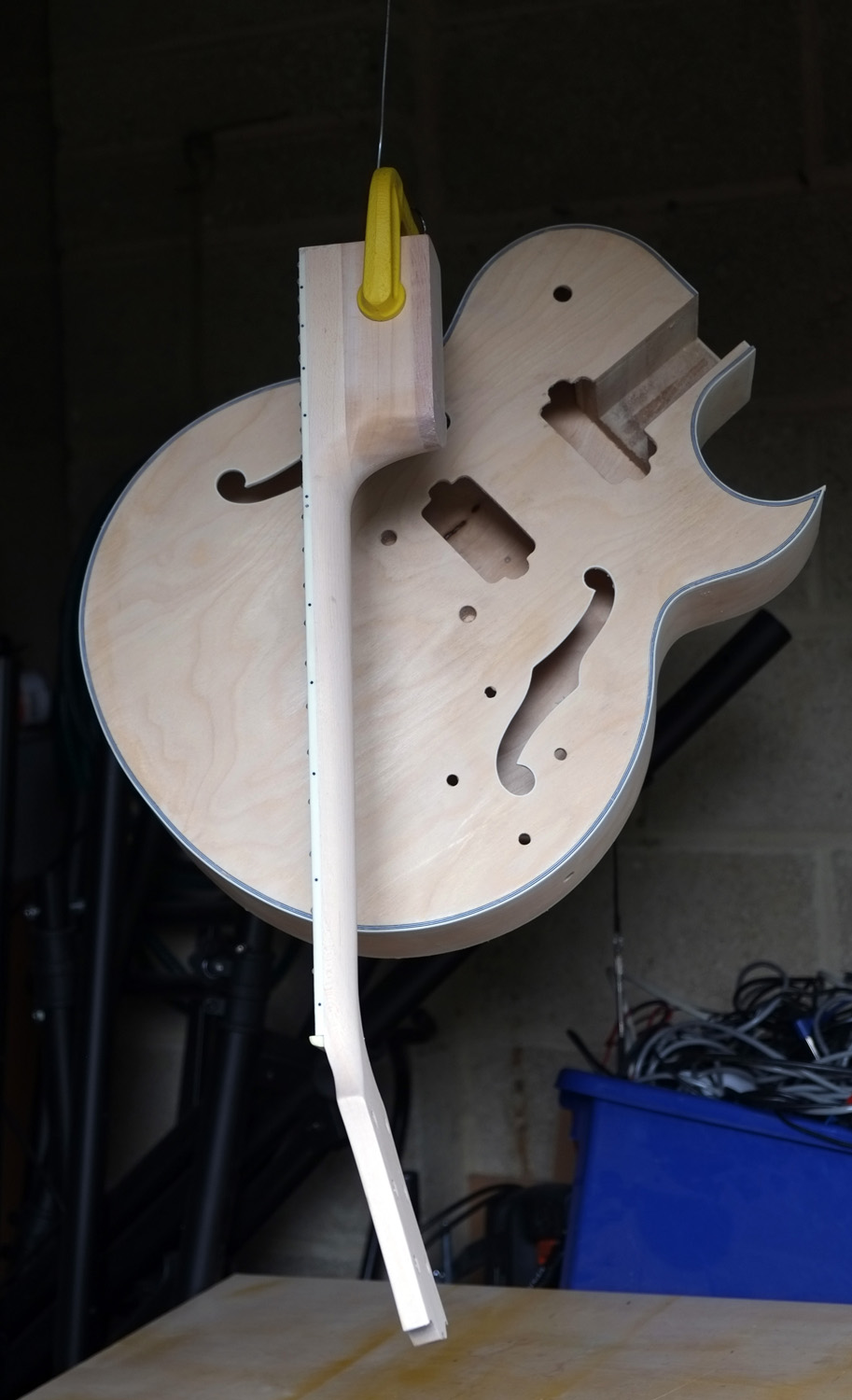

    Day 2. Before I went any further, I knew I'd have to shape the headstock. I tried to think of an original design but I'm not so good at that these days, so I drew a loose approximation to a Gibson one, then got the router out, followed by the Dremel drum sander and ended up with something fairly symmetrical and pleasing to my eye:
Name:	175 day 2 headstock shaped small.jpg
