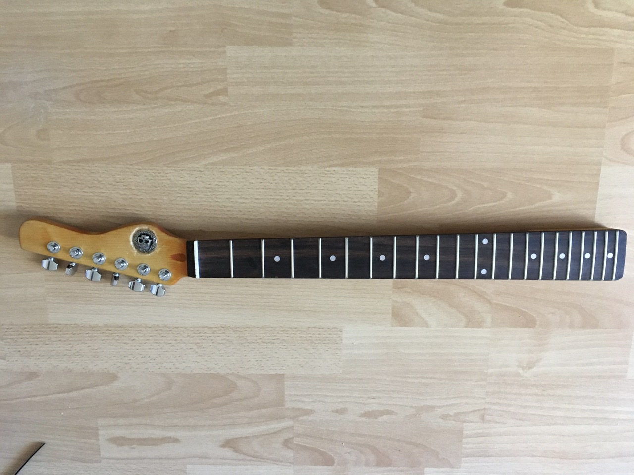

    In the meantime, I have worked on the neck, fitting my bling, which is epoxied at the front and screwed in from the back. It won’t be going anywhere. I’ve also installed the tuners. I haven’t set the heights properly yet (they are variable height) to get my break angle over the neck properly done.
    The neck is looking like this.
    Attachment 40060
    And the tuners specifically like this
    Attachment 40061

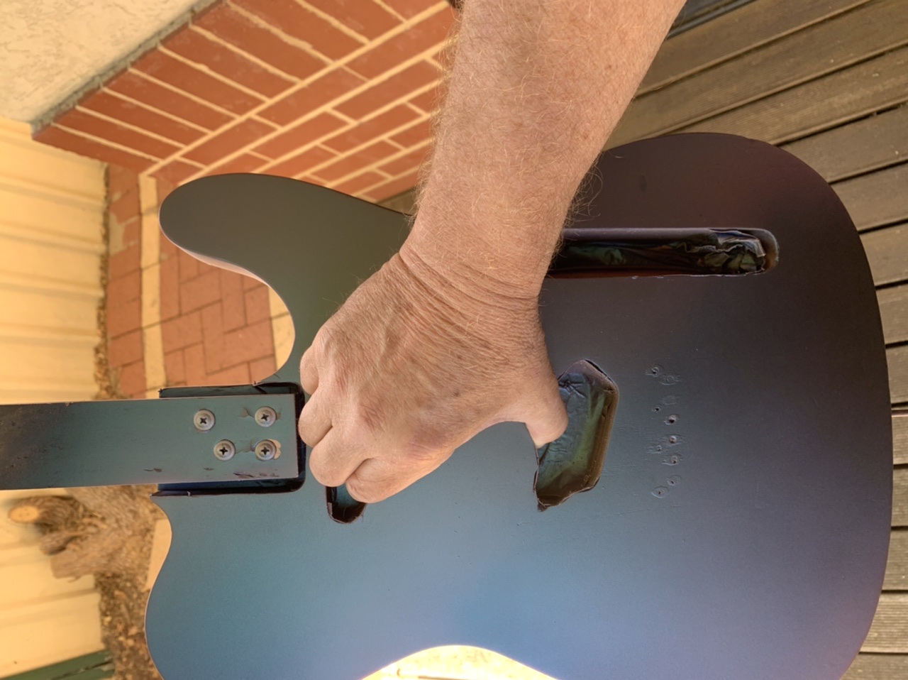

    In the meantime, I had another can of the colourshift paint, so I decided to give it another coat to do a richer finish.
    It now looks like this.
    Attachment 40062
    Except for the tiny detail that, it dropped onto the floor (and some pedals stored on the floor, conveniently directly under the drying guitar).
    The result was this.
    Attachment 40063
    Soo.....damn.
    I have more of the base coat and will order another can of the colourshift. That will take 10 days or so to get here, so...when the body is properly dry, I will sand back the affected areas and reapply the black base coat....then spray and spray again to go back to what it should look like.
    I’m pretty happy with the colour now though, so I have something to aim for.

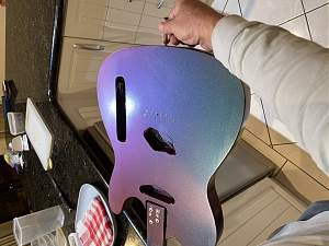

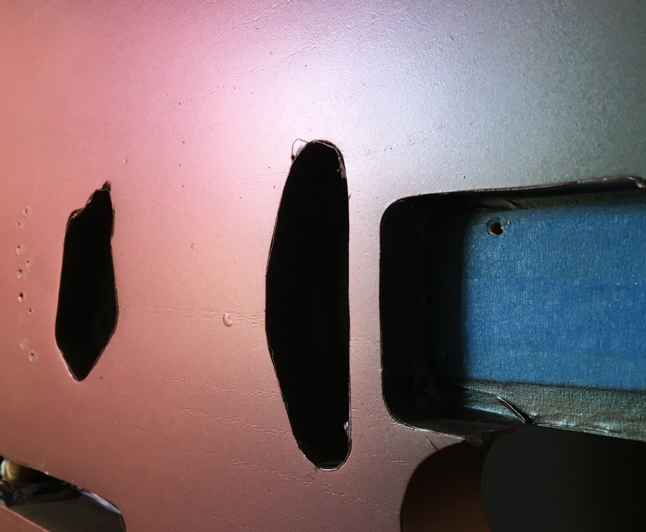

    Just walking into the workroom and seeing the light fall on the guitar like this
    Attachment 40070
    Maybe this will work out.the colourshift is certainly working.

    Quote Originally Posted by Eponymous View Post
    Yeh, you can see the pink in the light and brown in the shade. Trust me, the effect will be more dramatic when you get the clear on. You will have more depth, of it's a pearl shift the pearl effect will be more visible, if it's a flake colour shift, the flake will pop more, and assuming it's a gloss clear you are using there is also the way the light plays off the shine. To give you an idea, check out some of the Createx YouTube vids. they often show you examples of different basses before and after clear.

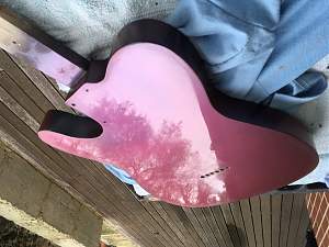

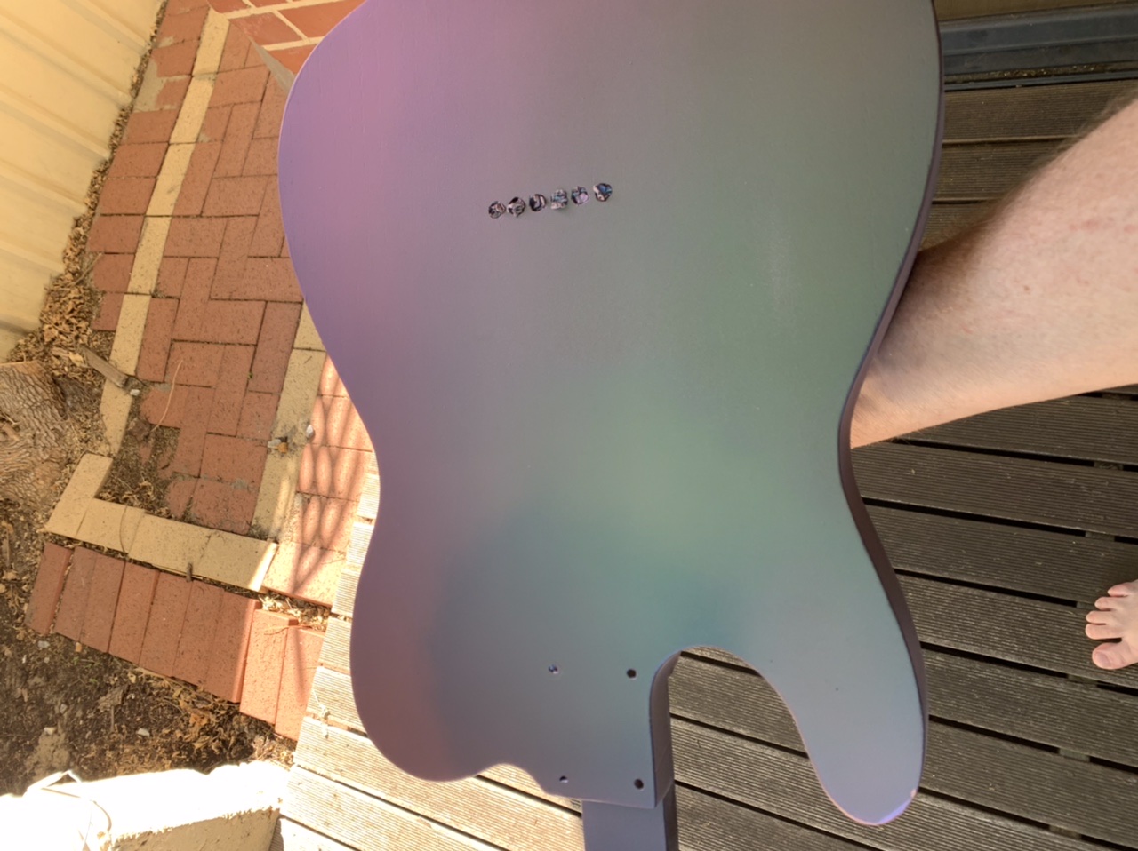

    The repair
    After a week down south, I’m back to start the repair job..well...finish, maybe.
    After the drop incident, I sanded back the affected areas, put some wood filler in to bring it level, then sanded back and painted the black base coat.
    It looks like this.
    Attachment 40283
    I have a new topcoat can and hopefully, it will all blend in...maybe.
    Should have that finished this afternoon.

    Don’t let the perfect be the enemy of the good

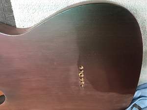

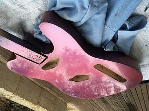

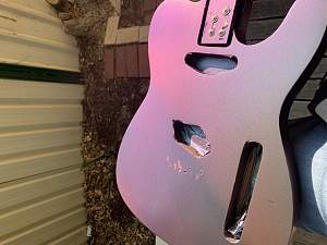

    So, painting is now done. You can still see the back repair but the front seems to be relatively ok.
    The back was a smaller repair area but it still shows up. Mostly, it will be covered by the backplate for the neck screws (and it is also the back, so meh), so I am going to leave it as it is.
    Will be using spray polyurethane on Wednesday. Aiming for about 6 coats..that is going to take me into the weekend.
    But, it looks ok, to my eye.
