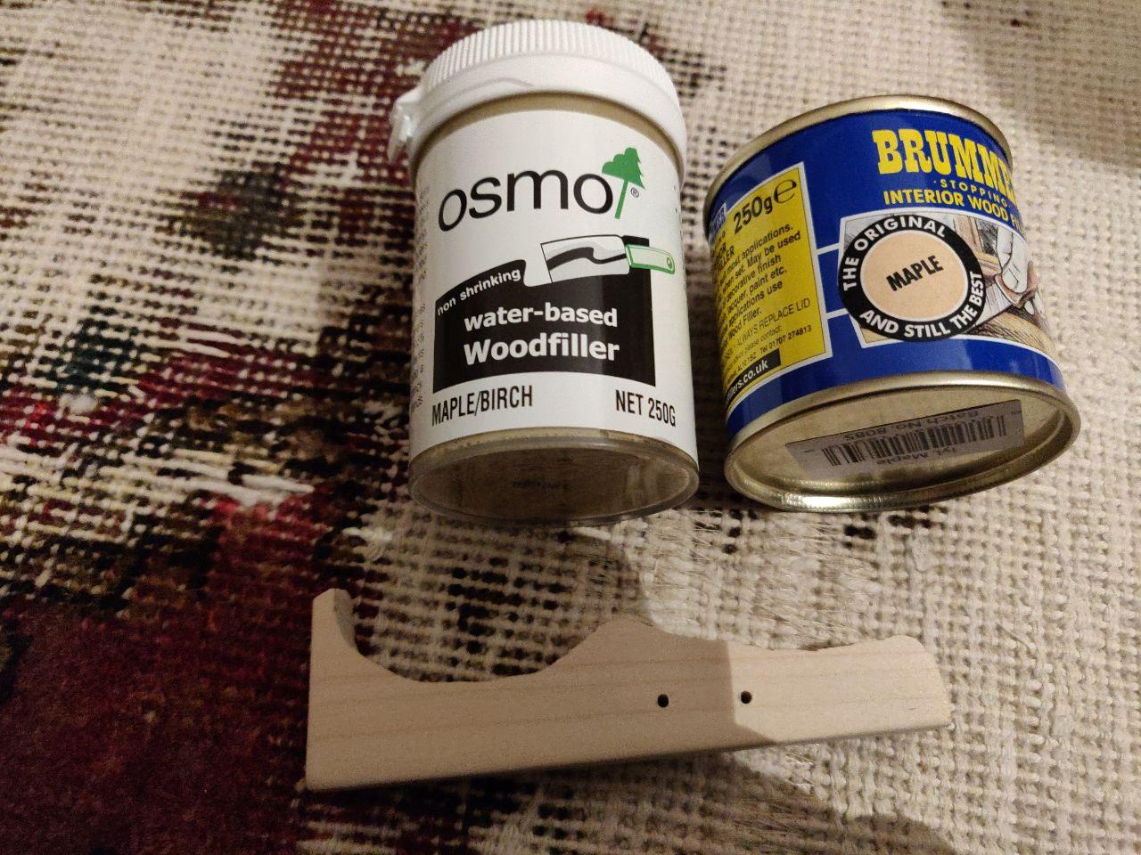

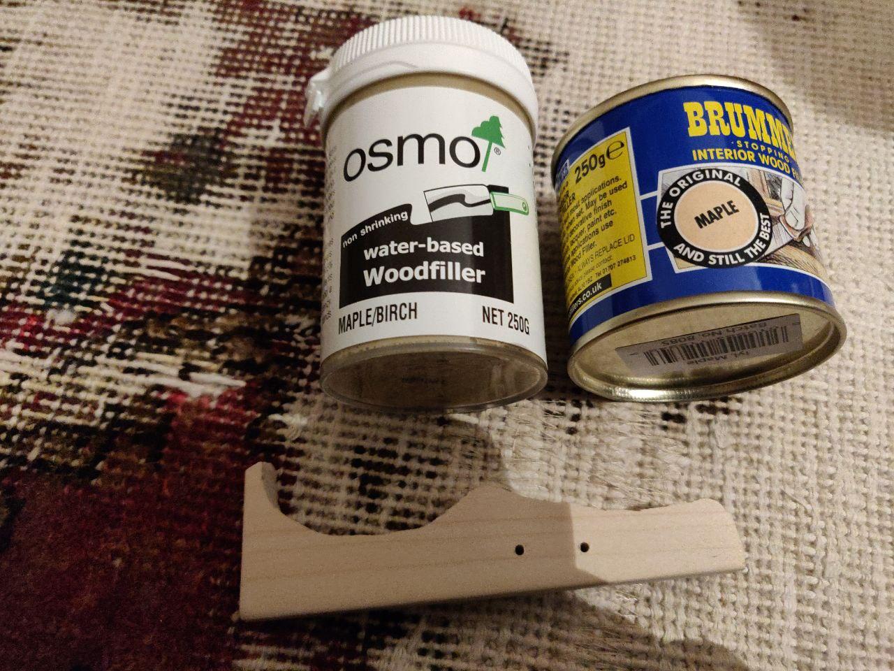

    This evening's woodfiller auditions:
    They both smell truly vile. My other half just came into the room where I'd used them and asked whether I'd just used the loo and if so, what on earth I'd eaten for lunch.

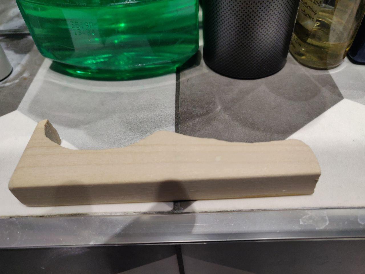

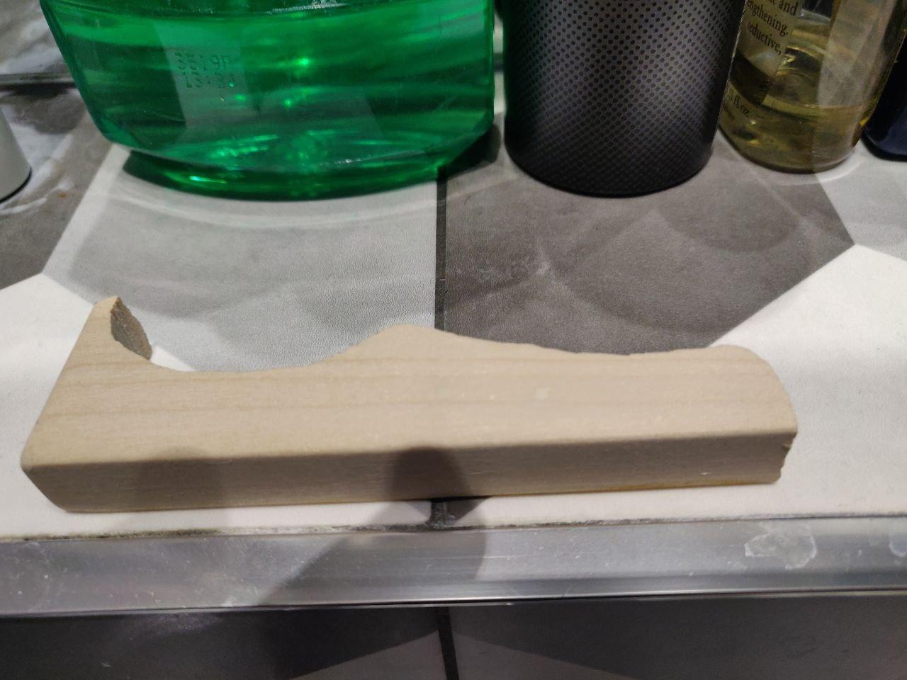

    So, after drying, both fillers are pretty much invisible, with the Osmo doing best:
    (It's visible if you look very very closely.)
    Early indications with the finish on are less good, though -- both are showing up but the Brummer less so. Will wait for the finish to dry before coming to a conclusion, though.
    Unfortunately, how the filler takes the finish (absorbs it) is always going to be the deciding factor in the end result. (as you've discovered)
    Another alternative might be trying a "furniture repair crayon". (I think Simon mentioned this earlier)
    The ones to use would be the "synthetic" wax type, NOT the bees wax type. They come in a range of colours for timber matching.
    I haven't used them personally but I've read numerous threads about them. As I understand it, because they are synthetic, they will take a coating (lacquer, poly etc) but because they are "wax" it doesn't soak in to the filler and change it's colour.
    I will reiterate that I have not used this method, only read about and seen videos about it. Could be worth a try.
    Then again, this could be the beginning of that rabbit hole I mentioned a few post back
    I don't know if TimberMate is available in the UK, but that's one brand that makes the synthetic crayons.
    You can get Timbermate, but it's normally very expensive. But you can certainly get touch-up crayons easily n the UK from Amazon (I've got some somewhere but never used them), though I'm not sure about whether mine are beeswax or synthetic.
