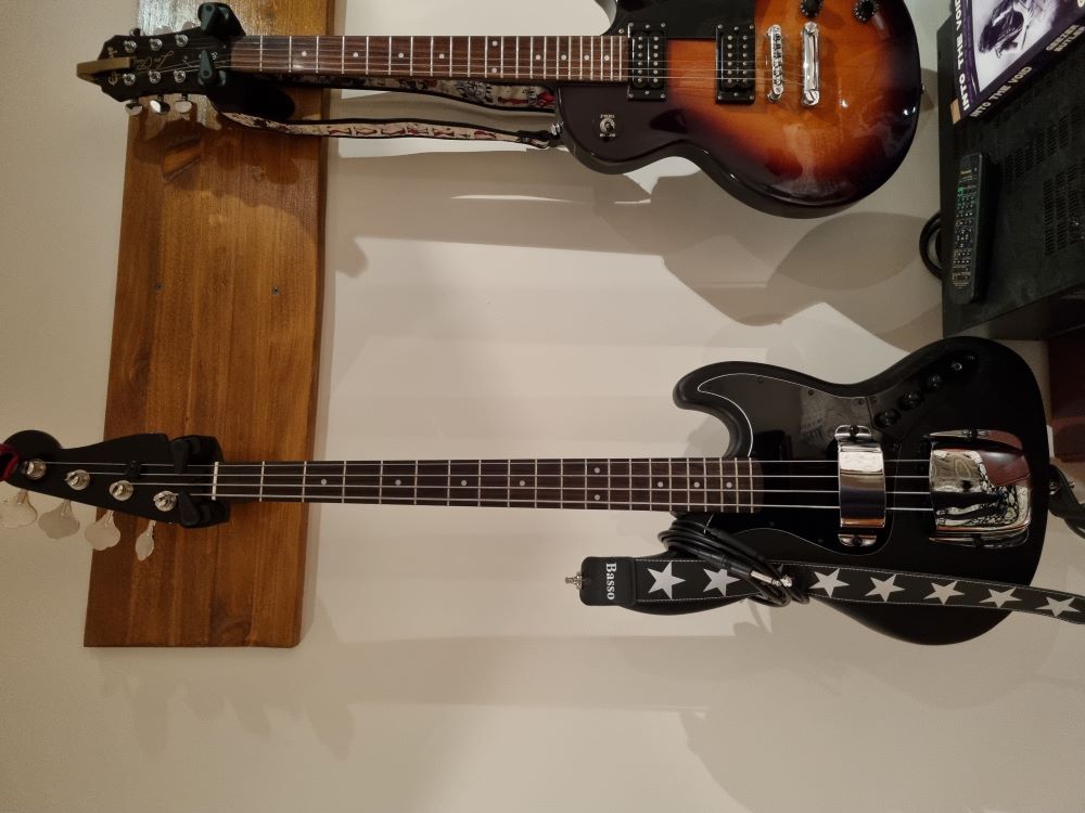

ID:	44724 up and running a little finishing off to complete, logo and a few touch ups, but she is a goer.

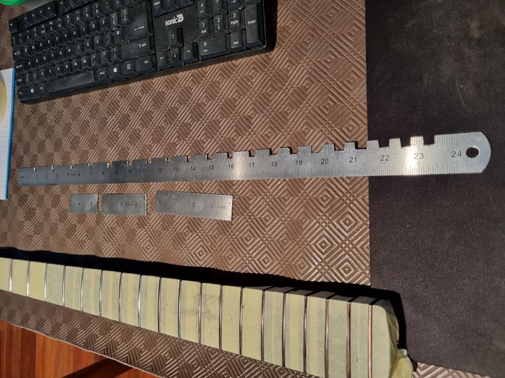

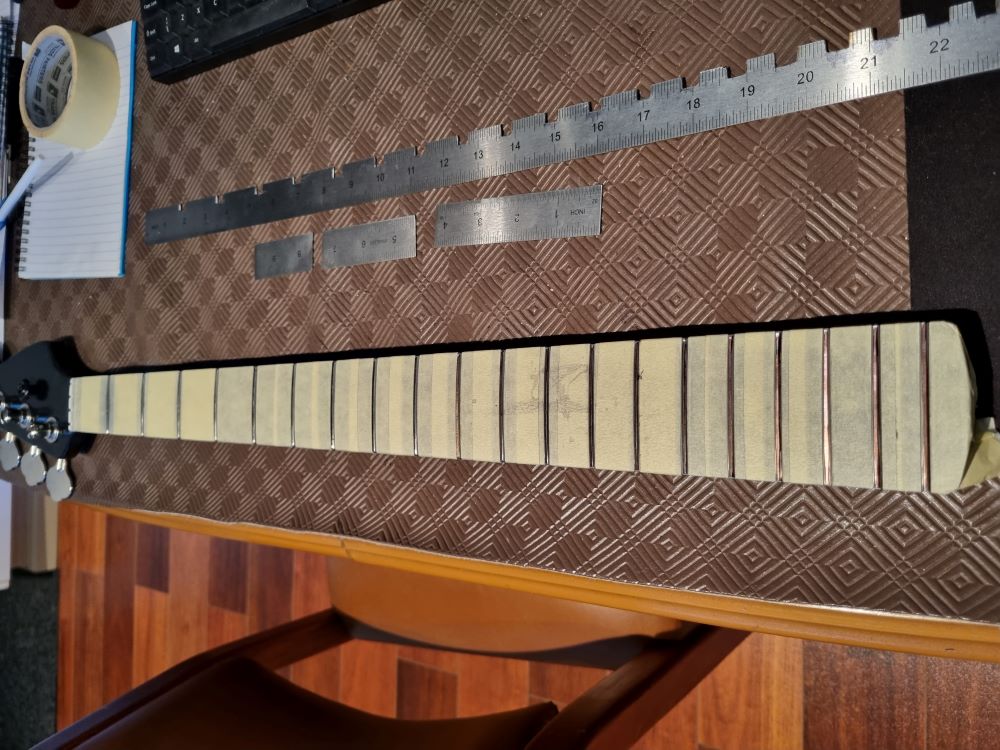

ID:	44727 Ive chosen to make a couple of tools for the neck straightening and fret levelling, reasonably happy with the results, the 2 aluminium tubes are dead flat and I used double sided tape to adhere 240grit sandpaper and went ahead levelling the frets. Quite a few high ones, permanent marker and carefully watched after every sweep over the frets. The rockers I created from a smaller stainless steel ruler. So far so good, now just have round off and polish.

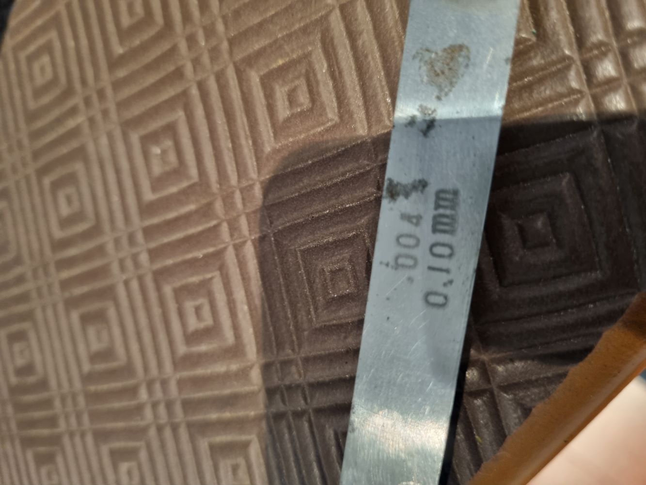

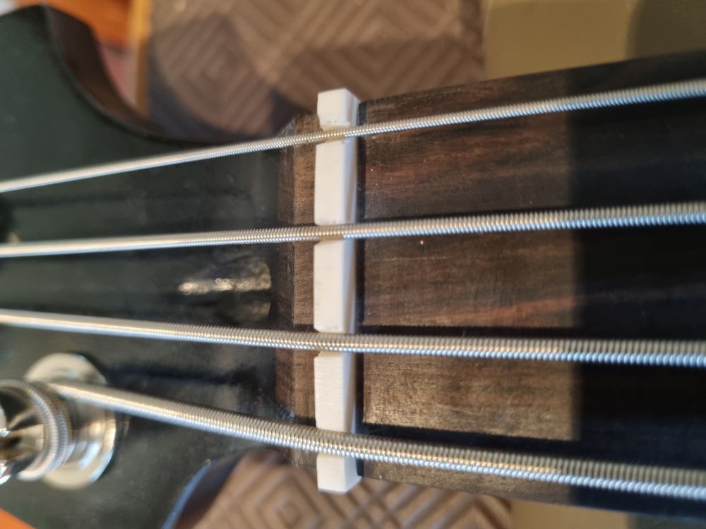

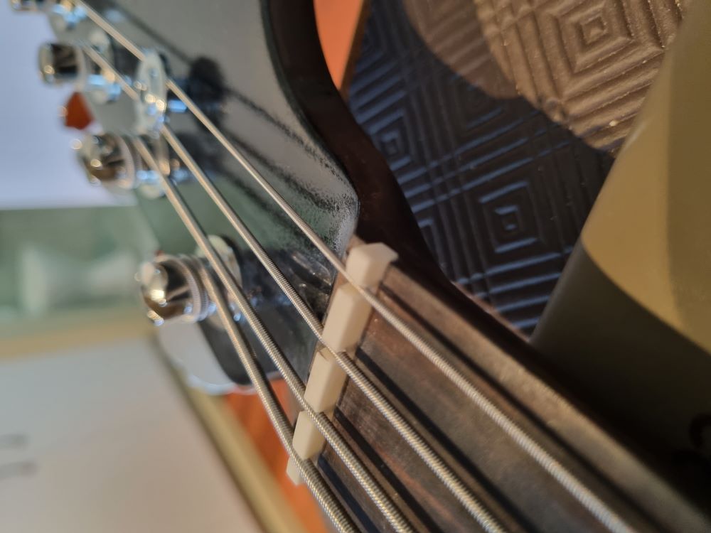

ID:	44802 Ok so after much deliberation a bit of guess work and a few tips from fellow members I decided to go ahead and slot my first bone nut. As can been seen from the photos, ive gone in and slotted before shaping, I did this on purpose as I thought this would make it easier to shape once the strings were setup to height. I used the feeler gauge .004 for the 3rd fret to first fret height check, I know some want to take it lower at that point .0035 I think but ive settled on where they are at this point. Intonation is good, no fret buzzing so I think im clear there. I used a varied amount of files and blow pipe cleaners, the gauging is a little hit and miss but my pin file collection took care of getting the slot bottoms round to accept the strings, I angle the files so to try and get the angles to the tuners acceptable as well as keeping an eye on the face of the nut so to get the strings to sit above the frets at the feeler gauge depth. This is my first attempt at slotting and shaping a bone nut, seems to be ok at this point, I will fine tune my process and likely do another.
