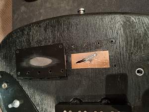

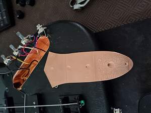

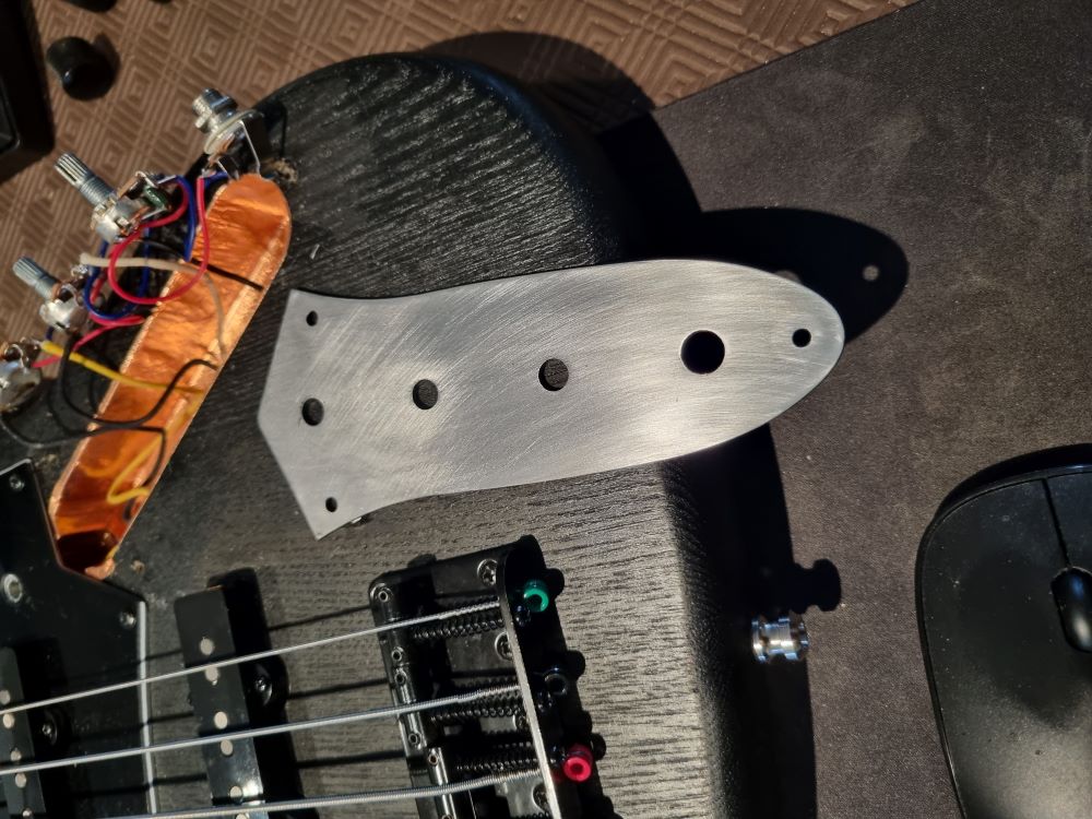

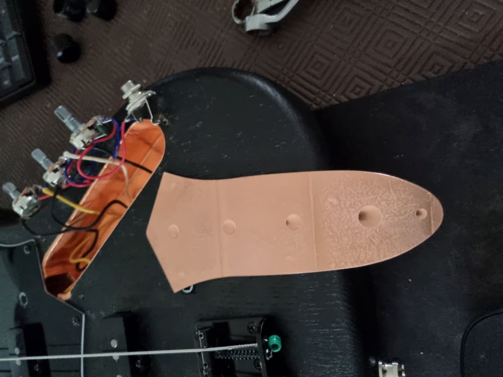

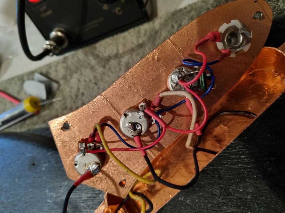

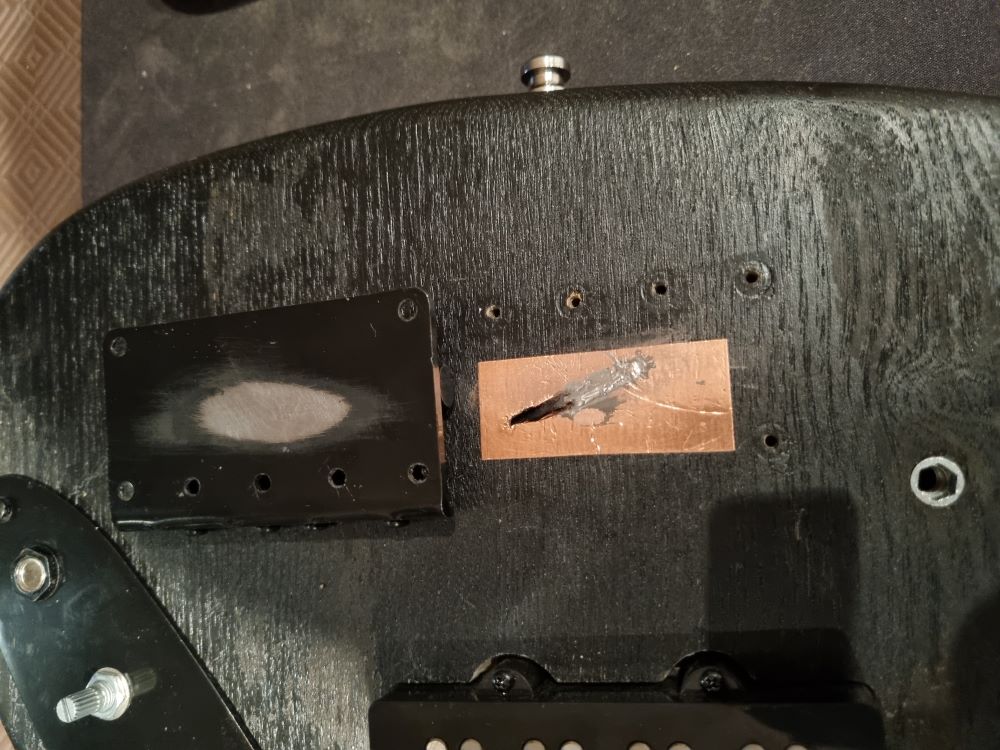

ID:	44712 Did a complete resolder and completed the faraday cage, I have full working system all volume and tone responding very well.[ATTACH=CONFIG]44713[

    Im fairly sure there was a few problems going on with the soldering, very little solder on the tabs, a couple more wires broke away while I was moving the panel around in position for soldering. I went a little extra and used heat shrink to cover any possible shorts. I used the multimeter and checked continuity all is good.
