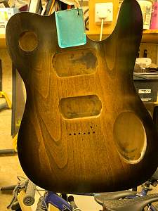

Page 11 of 19 FirstFirst ... 9 10 11 12 13 ... LastLast

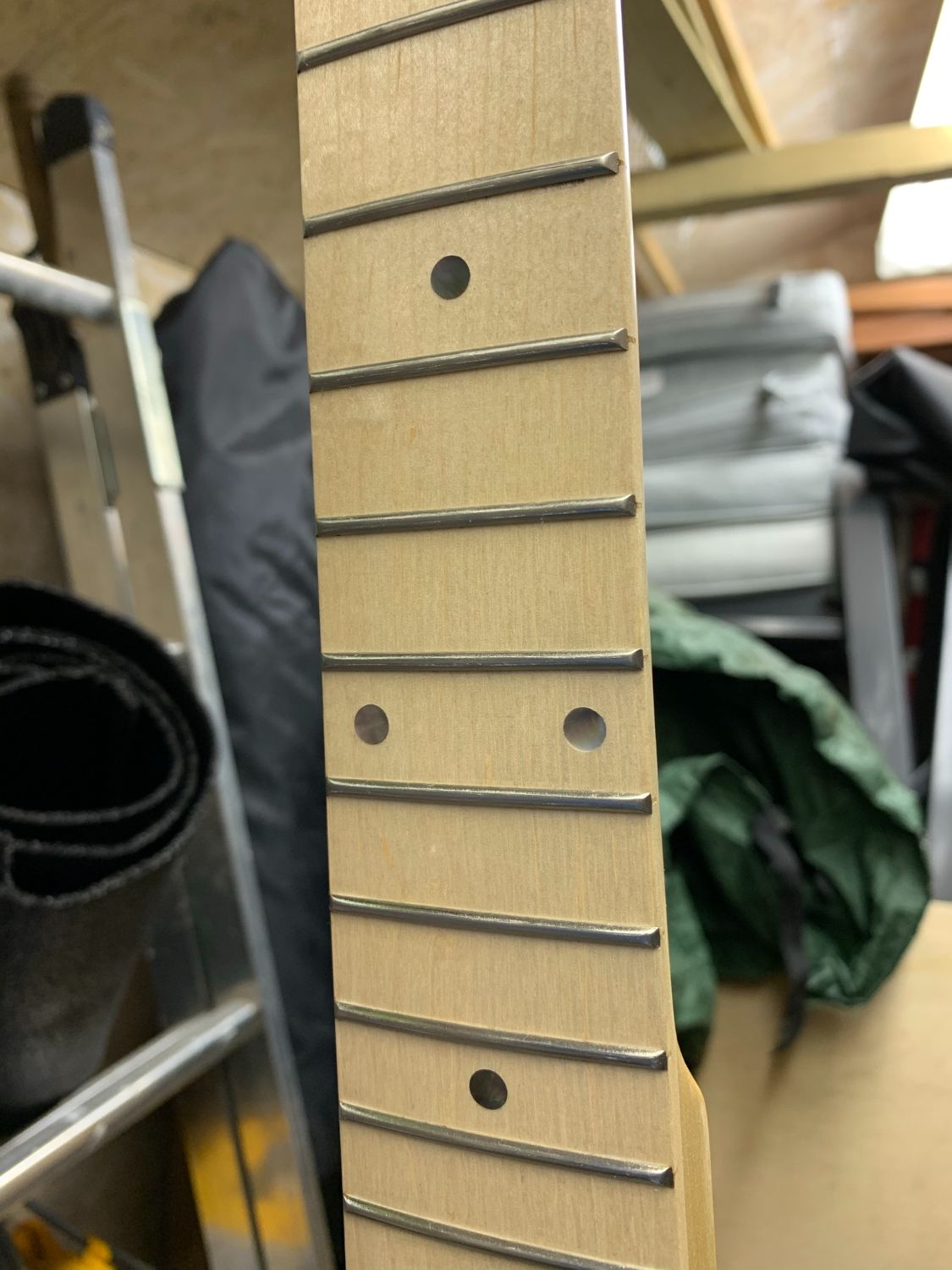

    Yes - fret board is done too - I applied a really light coat to start with.
  2. #102
    That's good. I read about people not clear coating maple fretboards and just waxing it or something... it worries me every time .

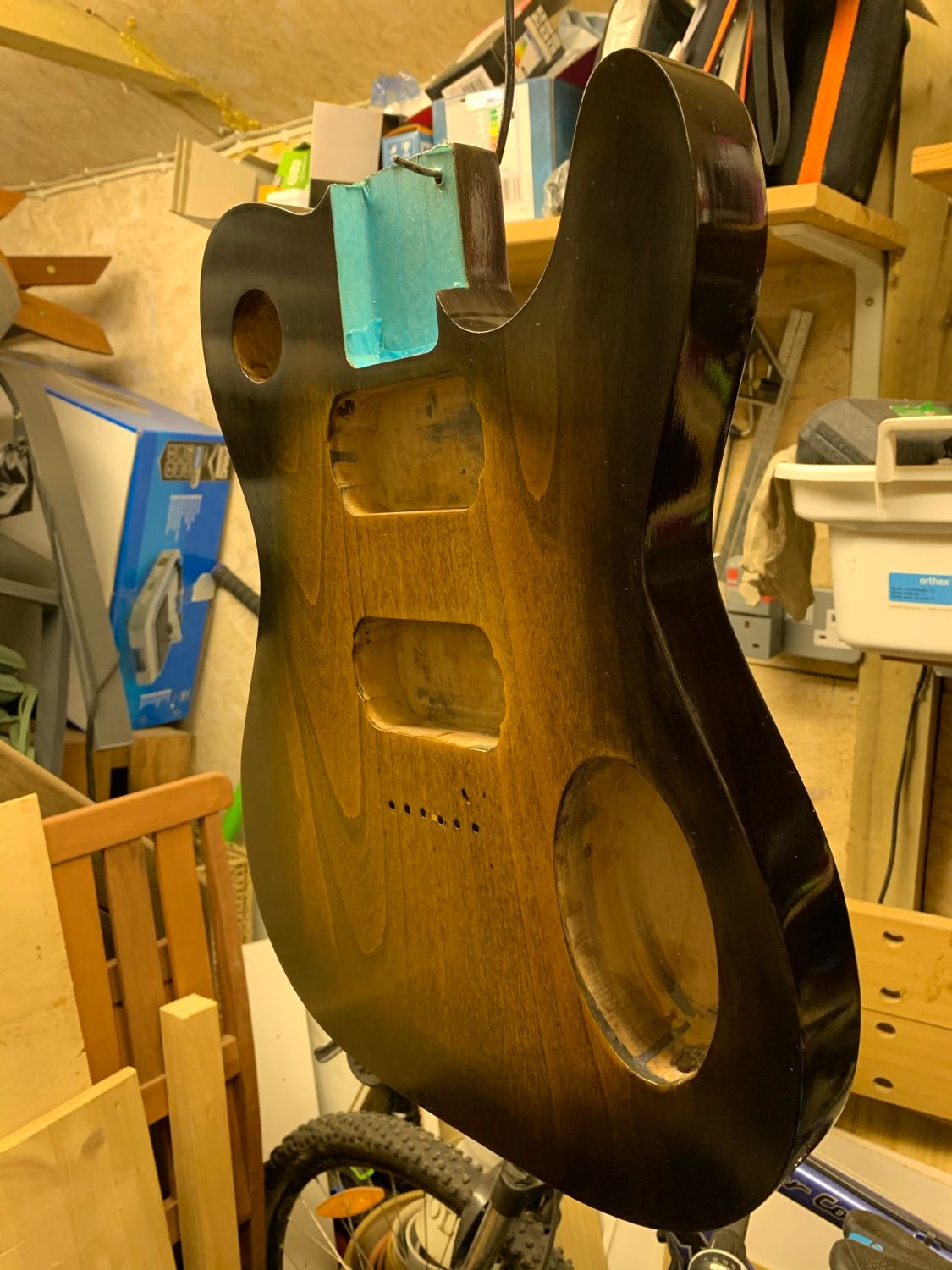

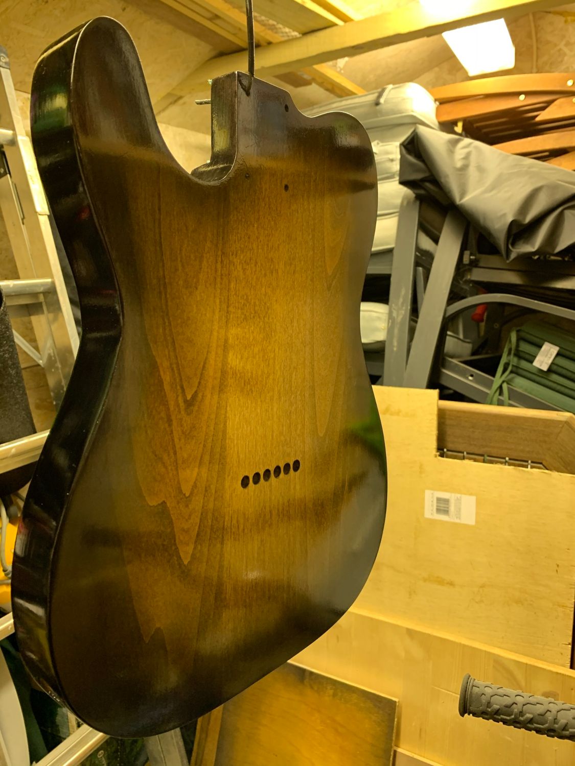

    34 coats... and it's going... okay - the back is looking better than the top. I had a couple of "dirty" coats on the top that I've not been able to recover from. In certain lights you can see runs where I've clearly put it on too thickly. I've lightly sanded every five or so coats with either P800 or a synthetic sanding pad. The pad seems to scuff it up removing any debris whilst the P800 is better at removing the runs.

    I'm hoping the runs are going to be hard to see after the final buff and polish. If not then the headstock my say "built in 2021" on the front and "refinished in 2022" on the back.
    I should get to 50 coats before the weekend - how long should I leave it before finish sanding and buffing? Is there any reason to wet sand? Or can I go dry? I'm concerned about swelling...
    I've also been looking at Menzerna buffing compounds to use with my RO sander.

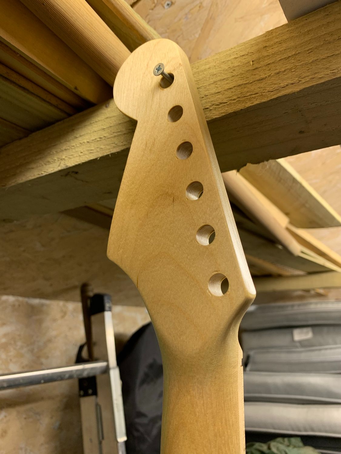

    Meanwhile in necksville - I've put four coats of truoil over the whole neck. And so far, I'm pleased with the outcome. It feels smooth and it has a nice colour to it. Next I'll add the decals and build up the oil a little more on the headstock to add a bit more a sheen.

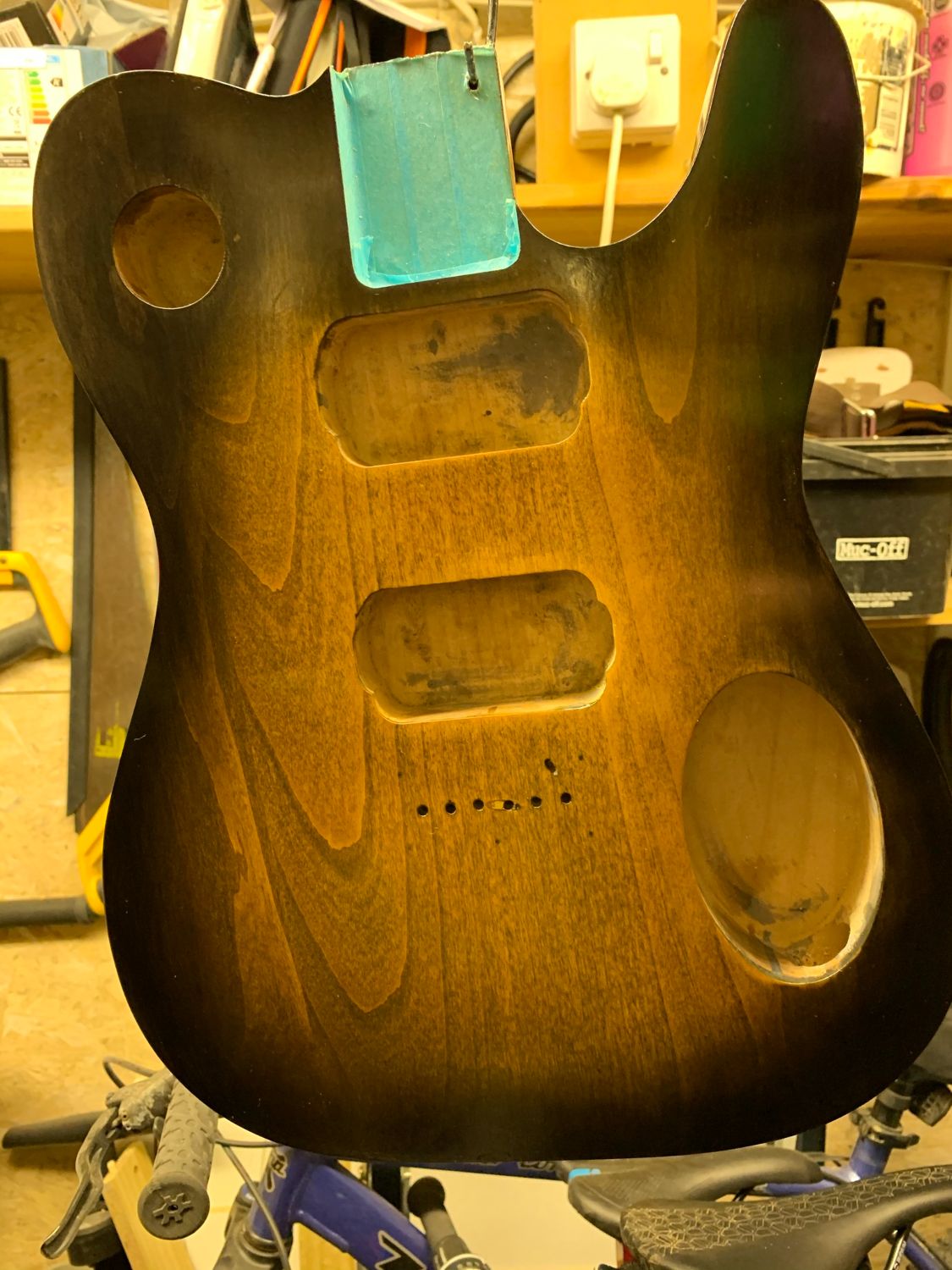

    Here’s an example of the finish defect. As you can it’s quite hard to capture in a photo but it’s definitely there. I’m wondering if it has something to do with my mix going stale?
    It could be from a batch thickening up if it's been mixed for a while, or may be just too much applied at once. Hard to say for sure.
    However that is the kind of defect that the strip sanding technique I mentioned is perfect for.
    If you use a nice thin strip, you can work just the edges of that mark. It shouldn't take much, maybe just a couple of pulls. If you try to remove the whole mark by block sanding, you can end up creating a low spot.
    Decal looks great!
