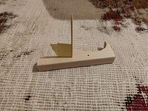

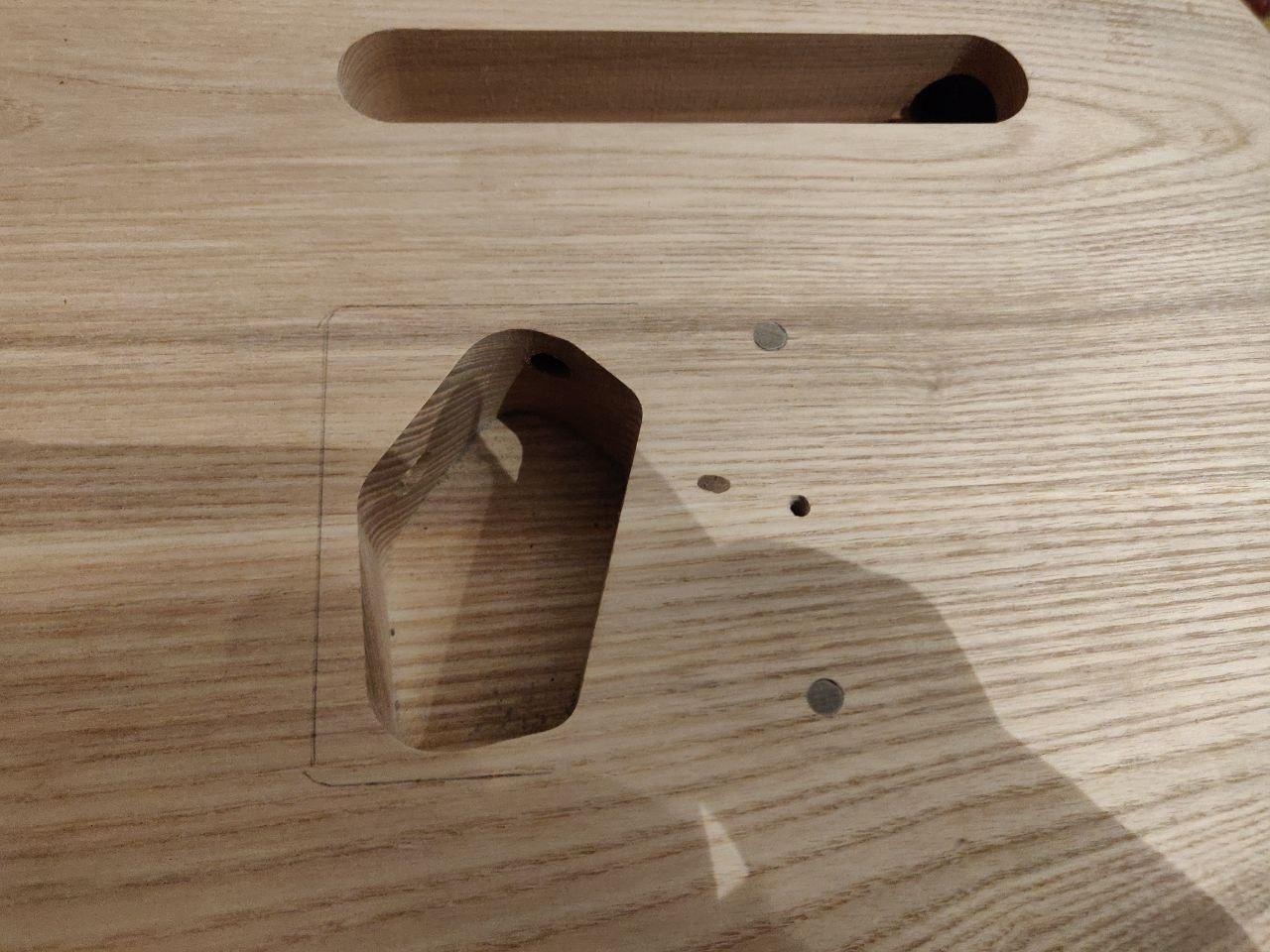

    Depth...
    and diameter...

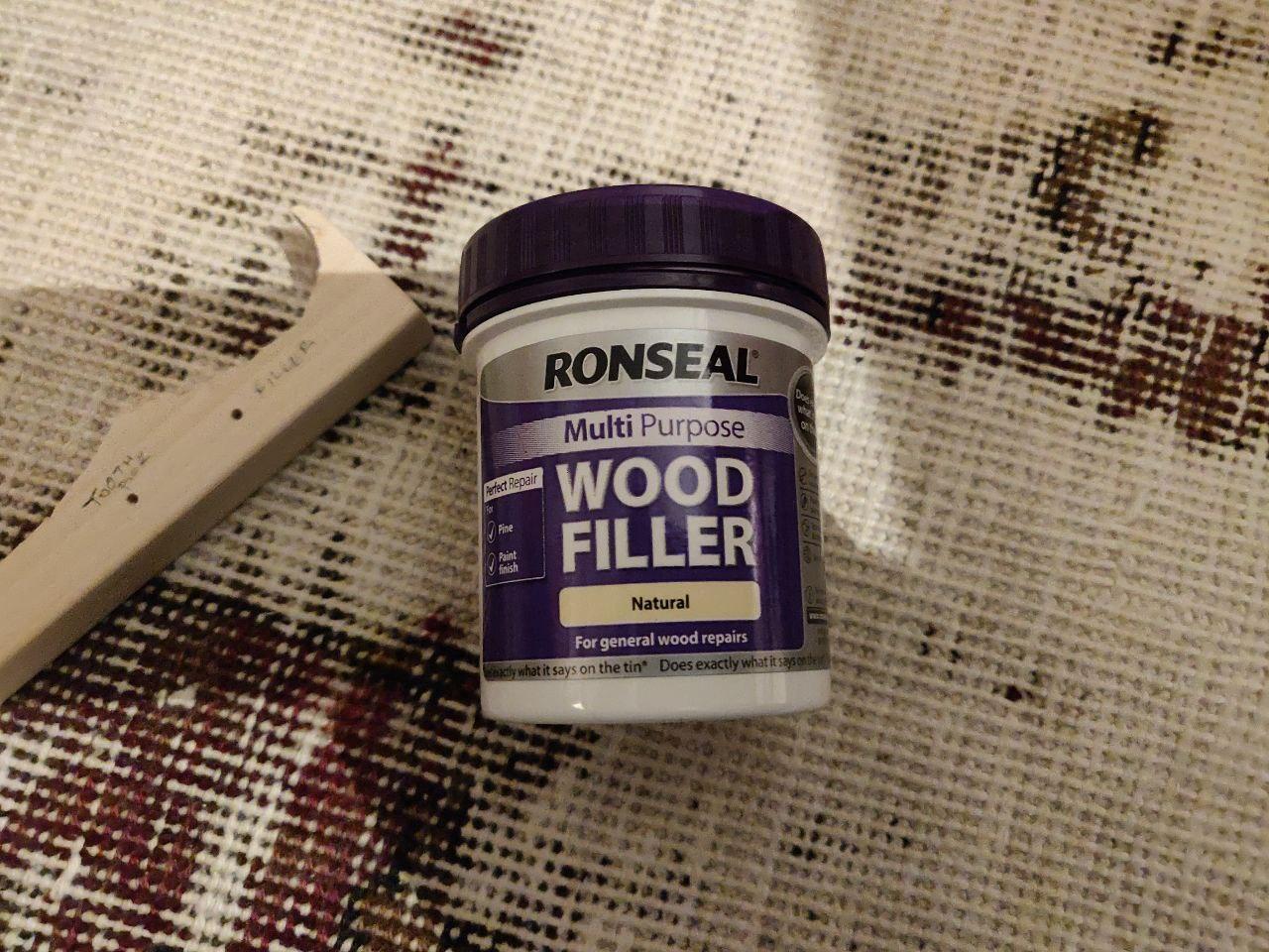

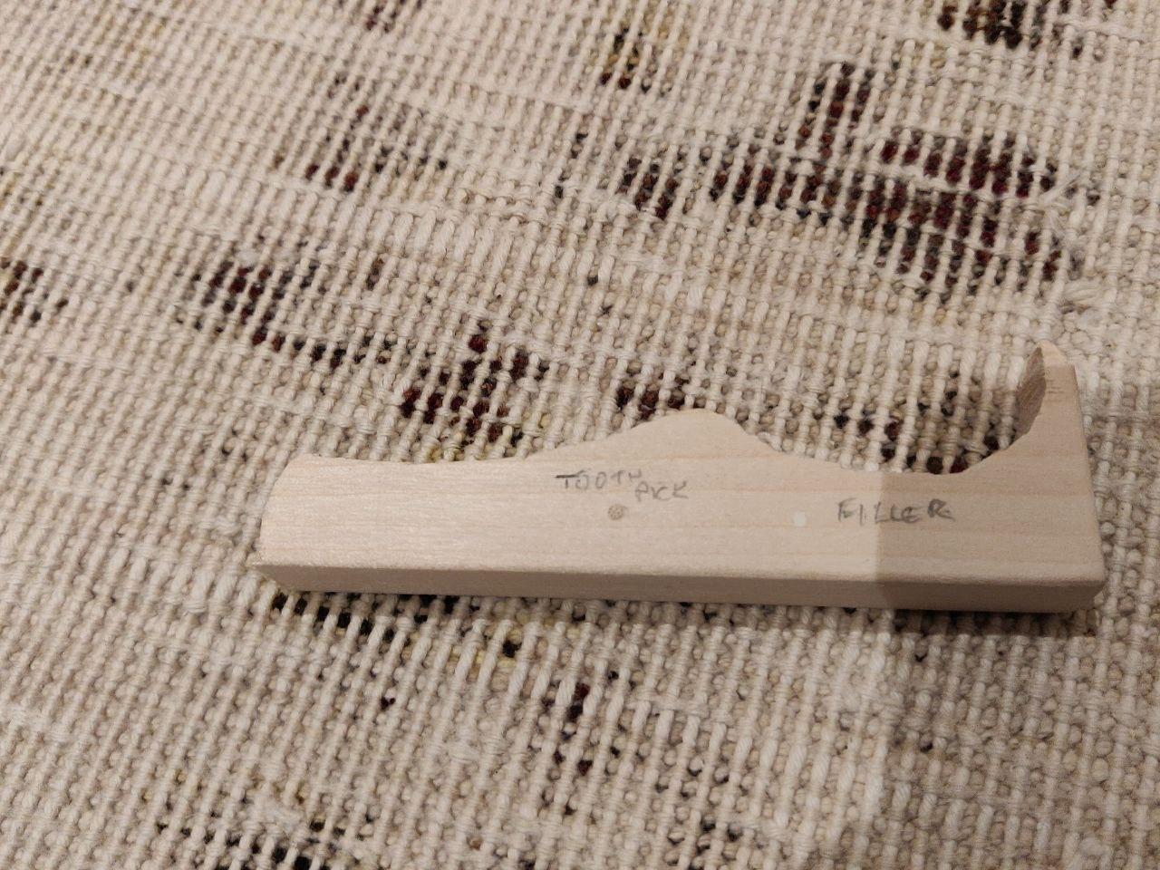

    ...look OK. So using this filler:

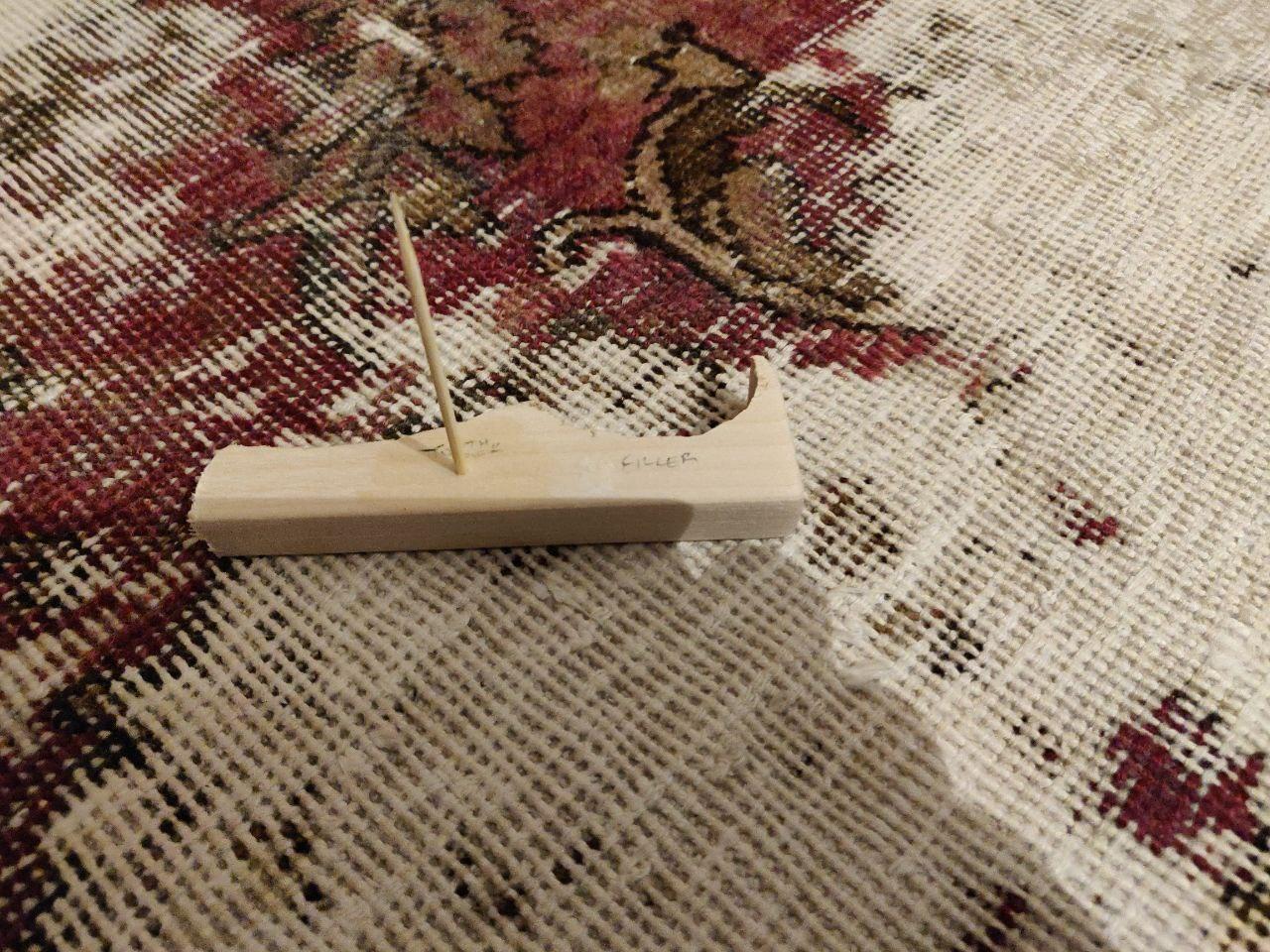

    ...and a toothpick we get this:

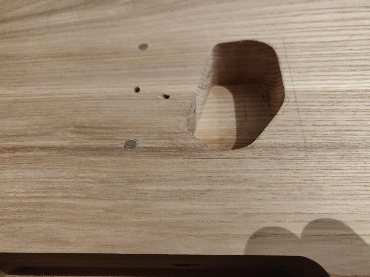

    Leave for a couple of hours to let the filler dry, then clip off the excess toothpick and sand a little:
    Toothpick looks a little dark, filler a little light (which is a pity, because it was a good match then wet). Will see how it looks with some finish on it; there's still the option of trying a darker filler if required.

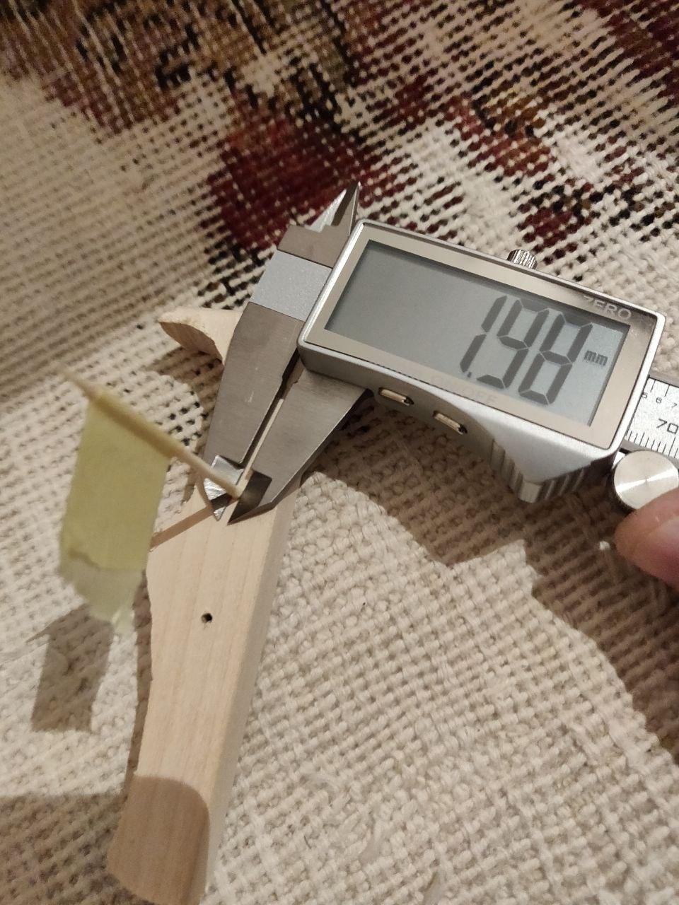

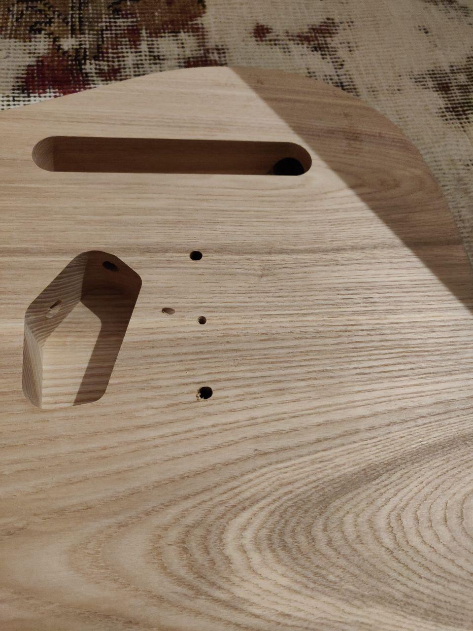

    Also dowelled up the bridge screw holes. This was more work that I'd anticipated. The holes appear to be a little too big for the 3mm dowel to fit tightly:

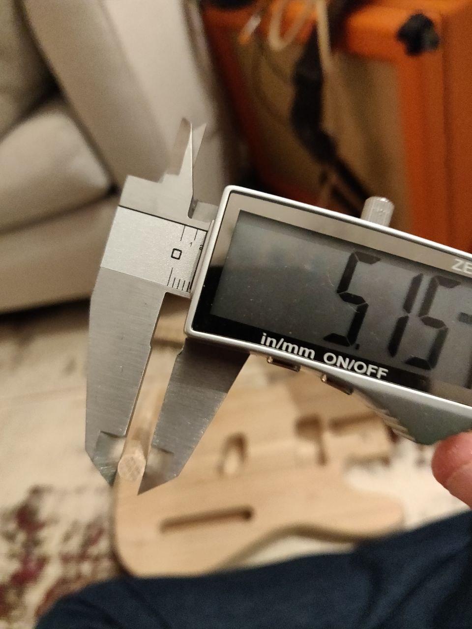

    ...and the next-largest I could find was just over 5mm:

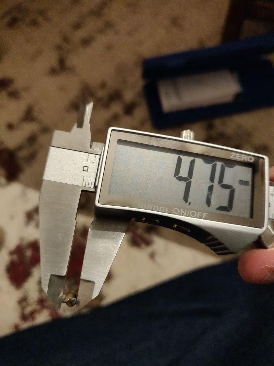

    Which is annoyingly larger than my 5mm drill bit:
    (That last photo was hard to take, and I see that it looks like the bit was at an angle when measured -- the reading on the caliper is the real width of the cutting edge, though.)

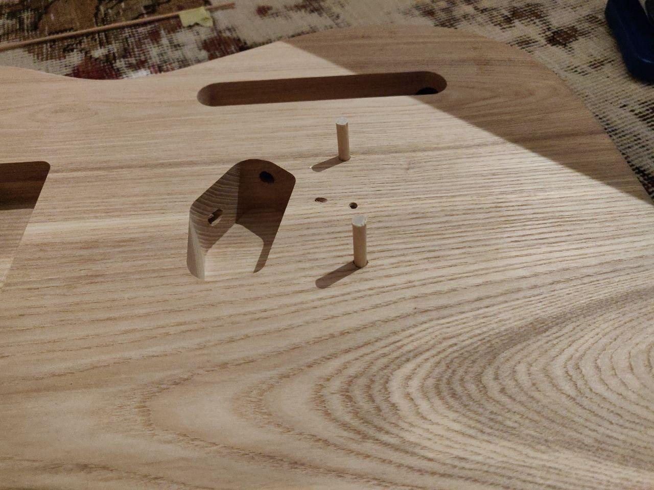

    Well, needs must: drilled the holes using the 5mm bit:
    ...and cut dowels to length:

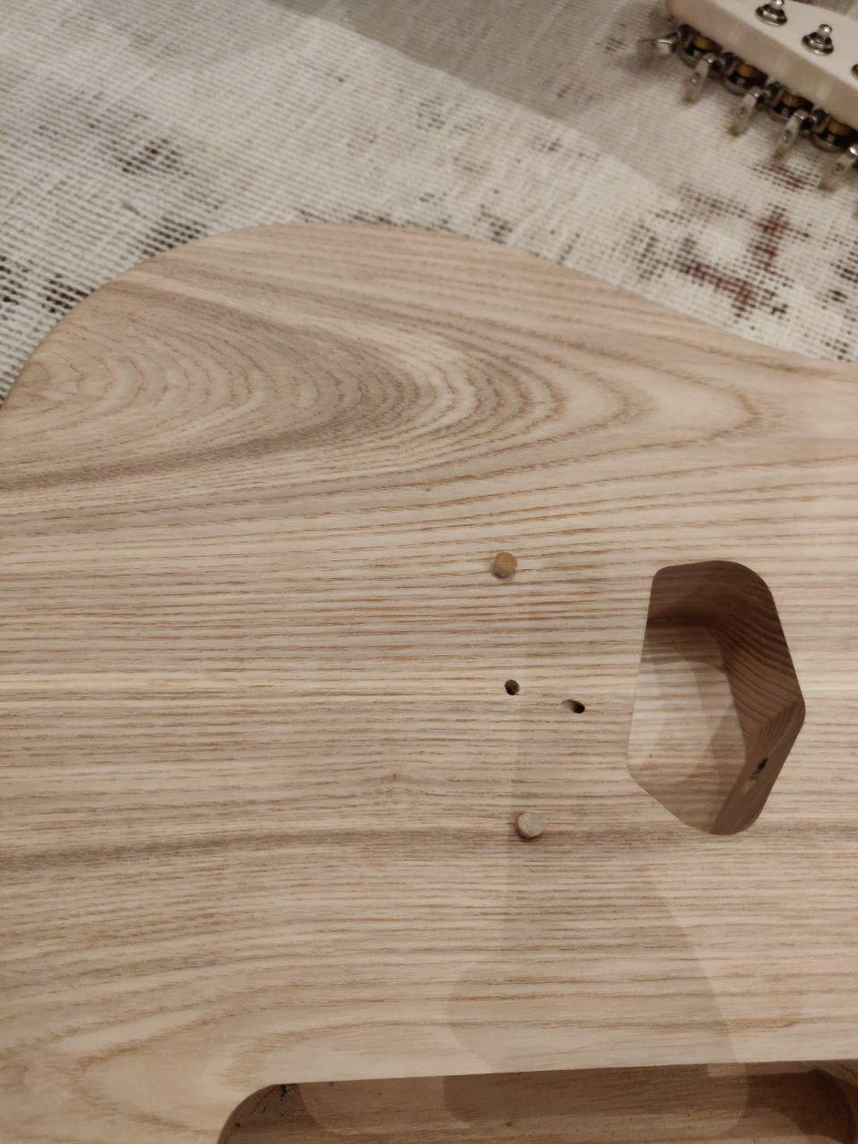

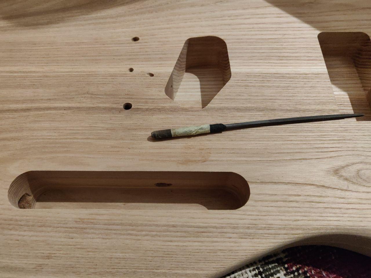

    Next step, a metric shit-ton of sanding so as to be able to fit 5.1mm dowels into 4.75mm holes. Sanded inside the holes with roll of sandpaper on the handle of a modelling file:
    ...plus a bit of careful sanding of the dowels, trying to keep them as close to round as possible. After what felt like a week of sanding, and two blistered thumbs, they went in with encouragement from a mallet (I'd deliberately cut them a few mm long):
    A spot of normal sanding, and they're done!

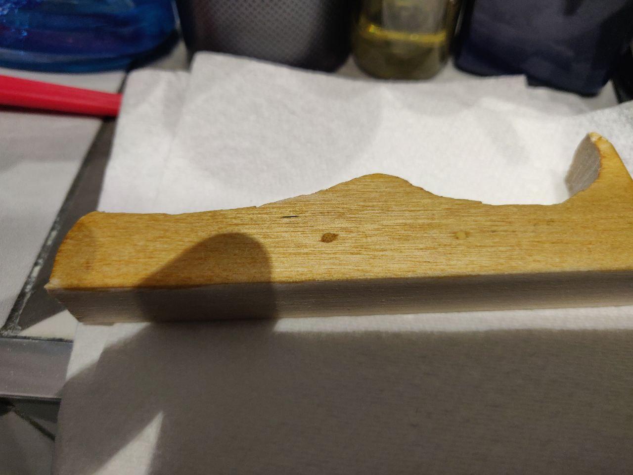

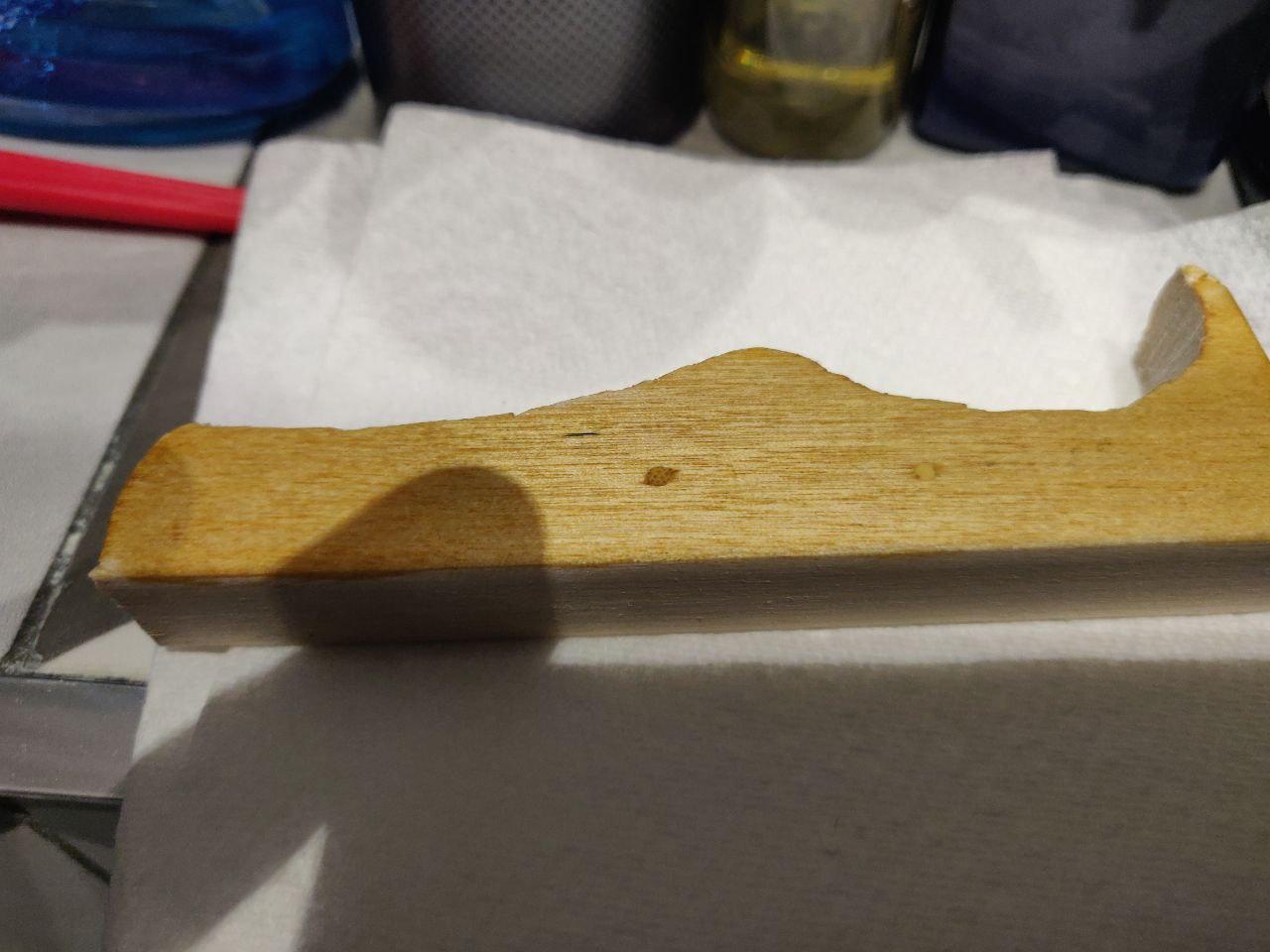

    One coat of finishing oil on the offcut with the filled holes, and the wood filler (on the right) is looking OK -- not perfect, as (of course) the oil is highlighting the edge, and there's no grain inside it, but the colour is matching and given that it's 2mm across I suspect it won't be a huge issue. The toothpick (on the left) is too dark.
    (If there were only one hole, I reckon either would work, as the toothpick could be mistaken for a knot in the wood. But with six in a straight line, it needs to match pretty well to not look weird.)

  9. #109
    Jan 2020
    London, UK
    116

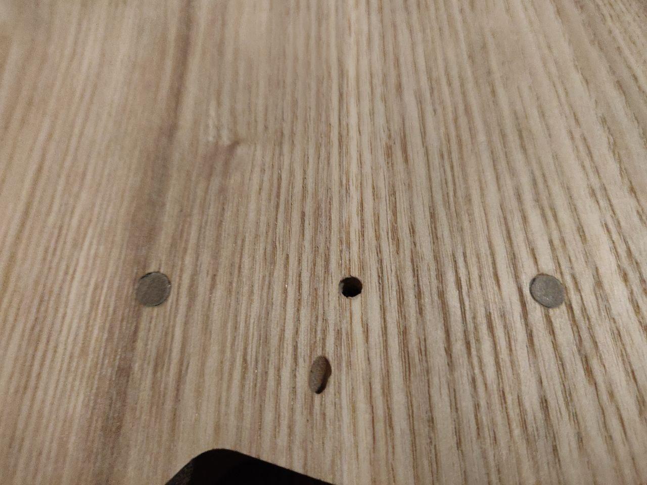

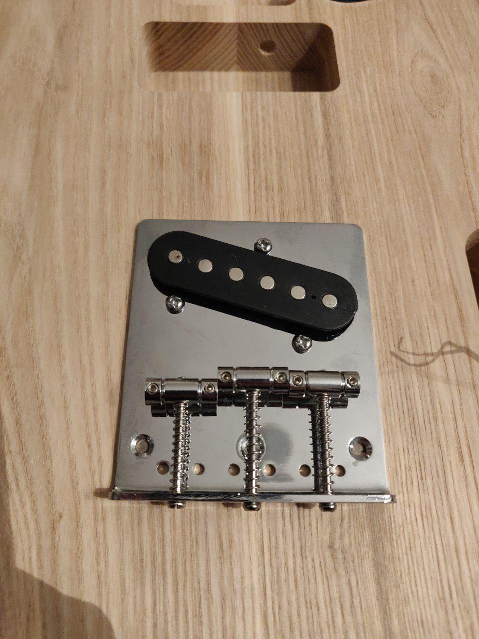

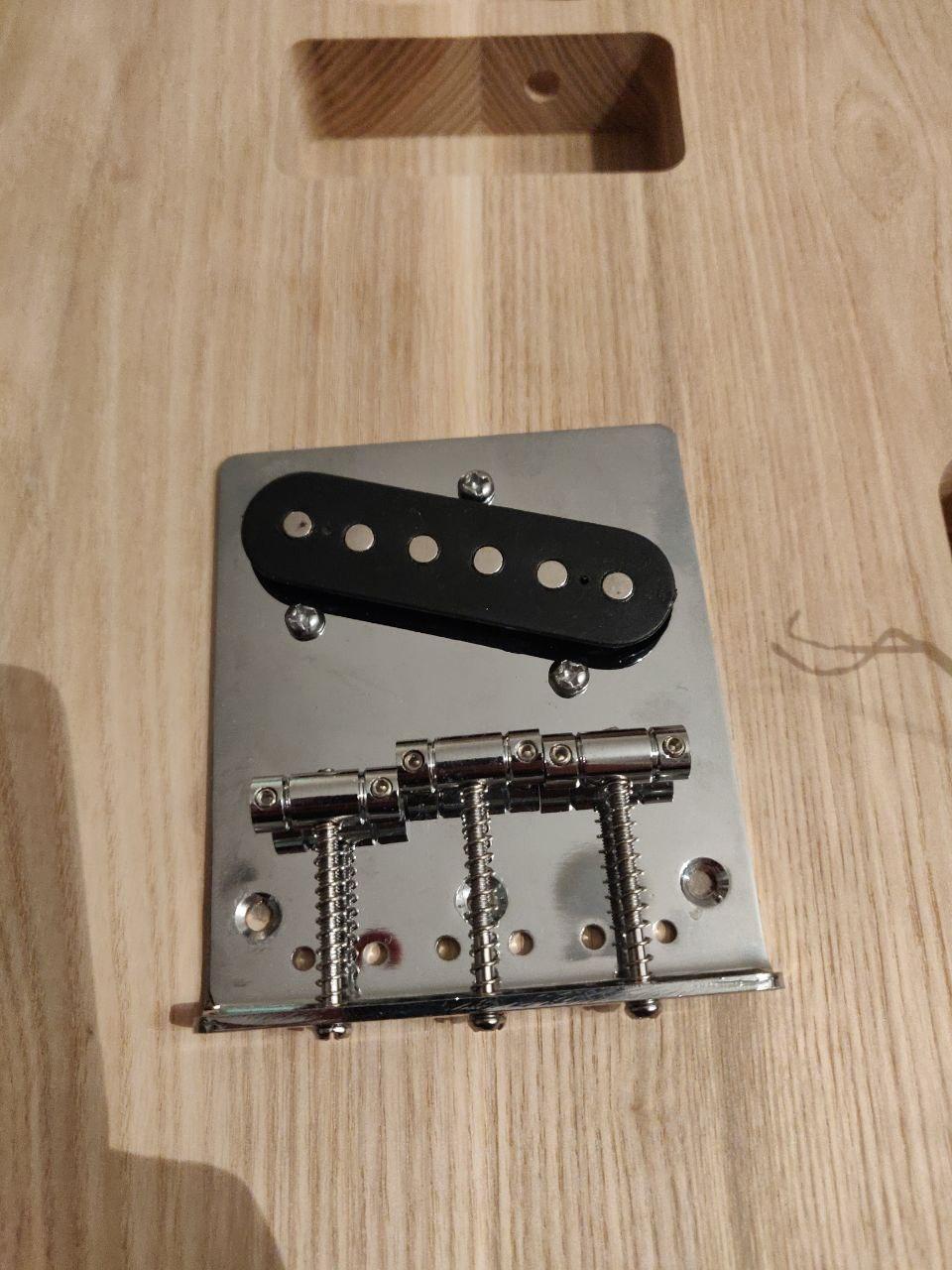

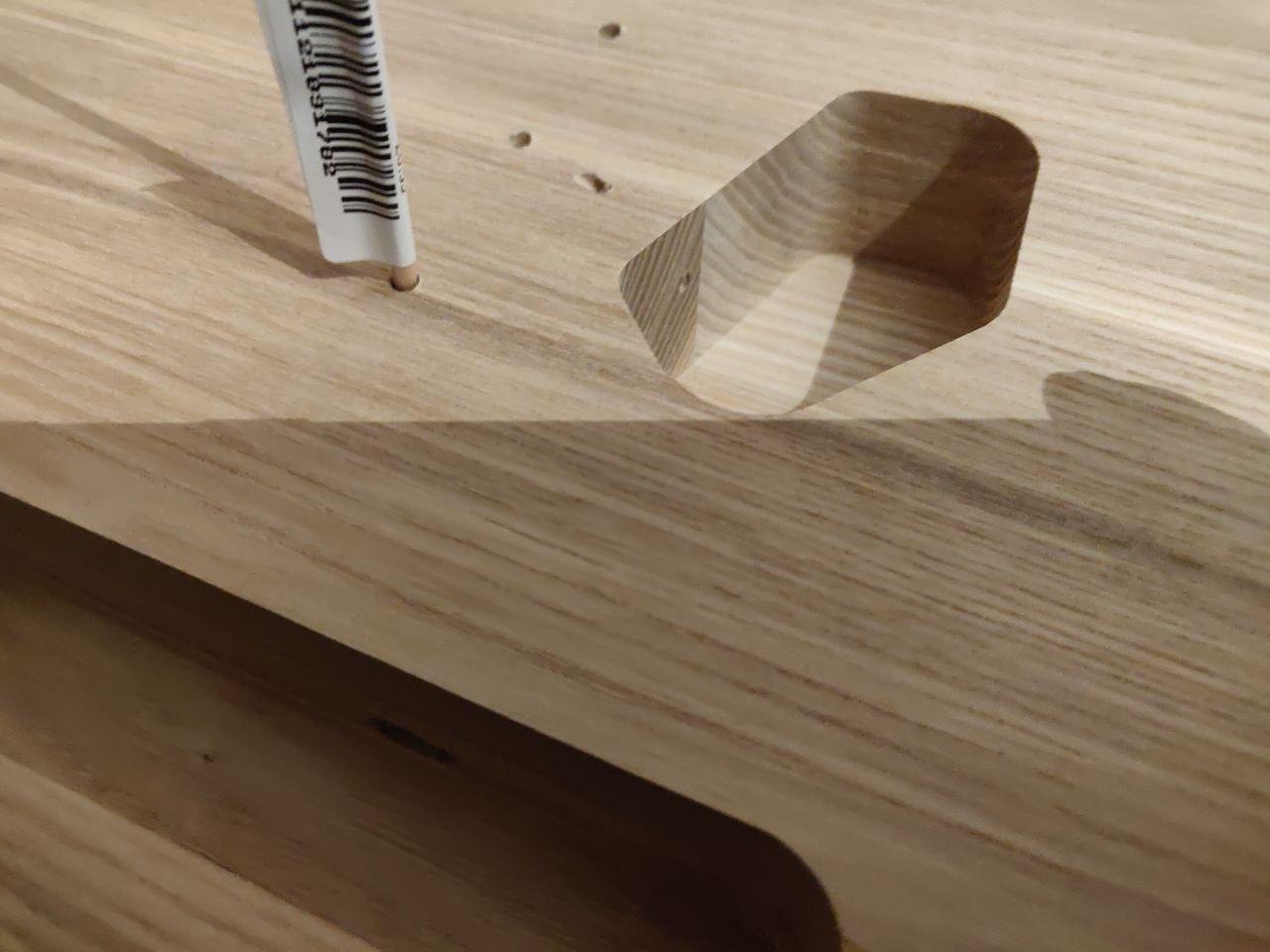

    Time to rout out the bridge pickup cavity a bit. First, put the bridge in place, with the centre screw hole (the only undowelled one) aligned...

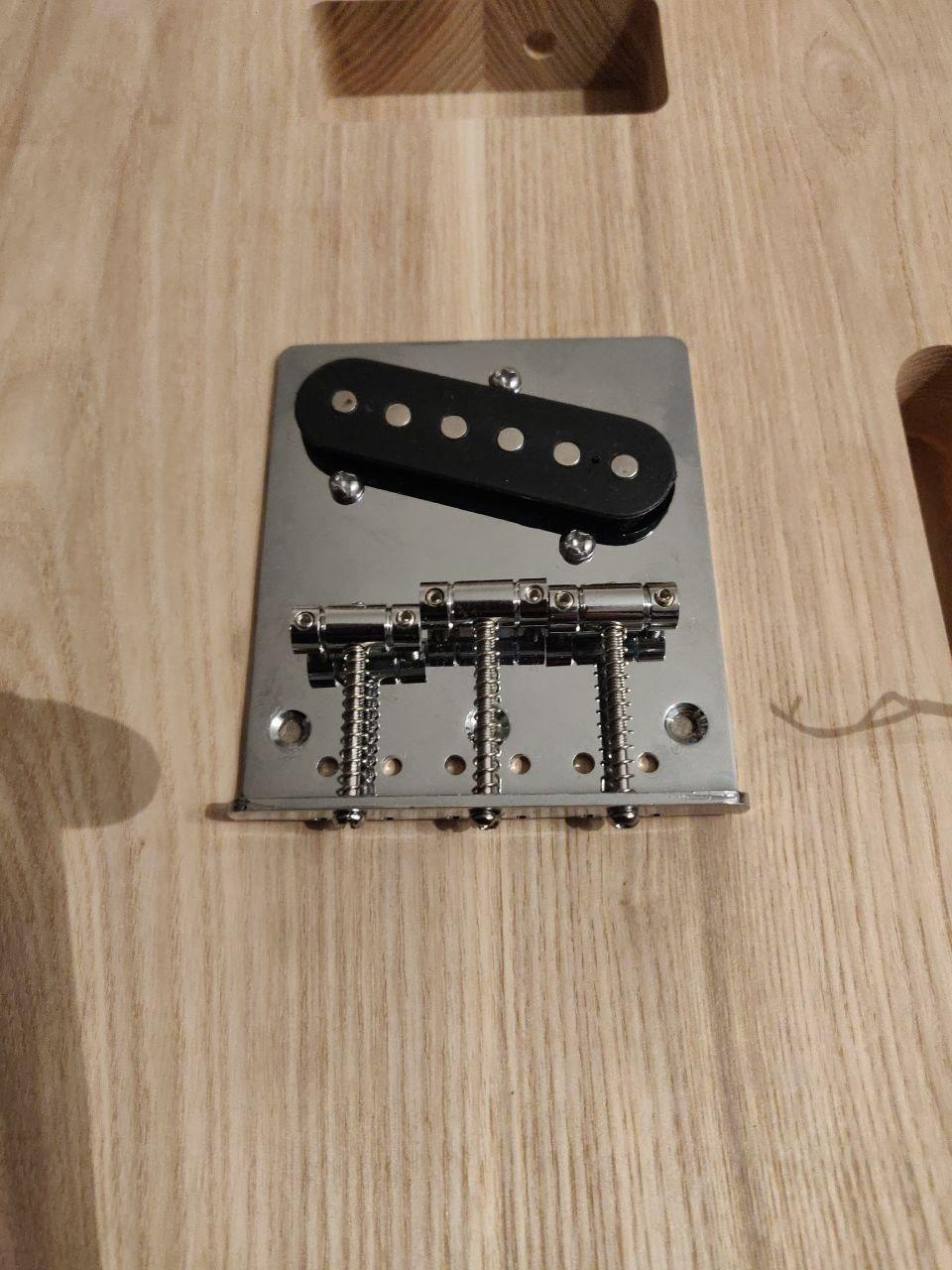

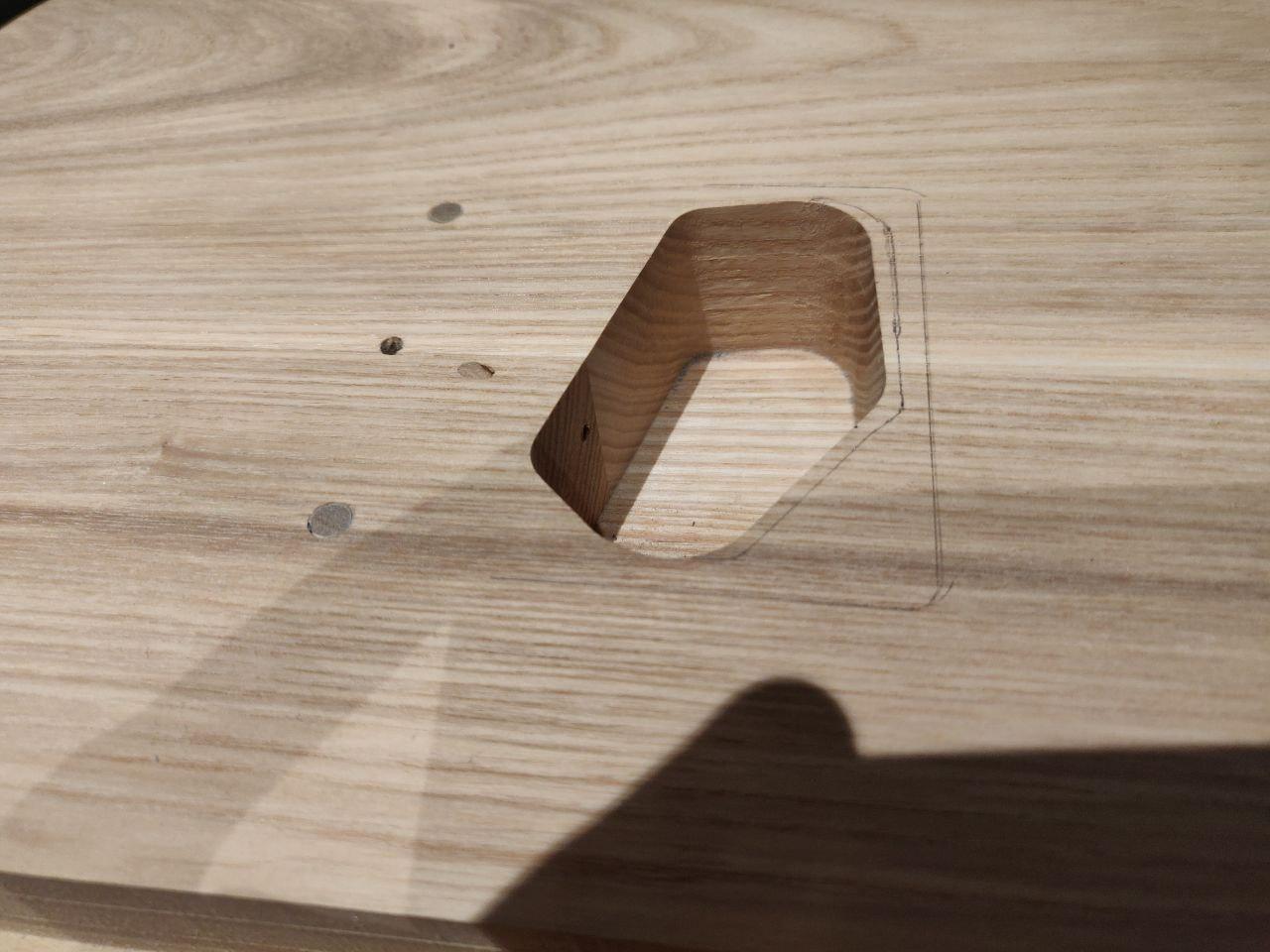

    ...in order to draw a line around it, to make sure I don't get carried away and rout out something that isn't hidden under the bridge:
    Sketch out what feels like a sensible maximum:
    ...and rout it out with the Dremel tool:

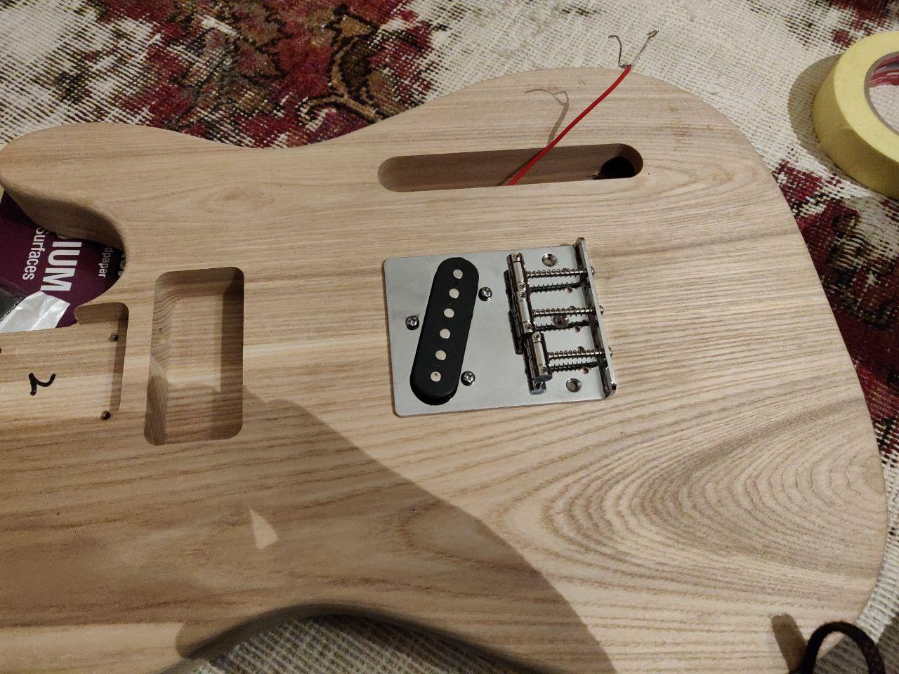

    Now, with the centre screw hole in place, I can easily position it such that by eye it looks straight:
    ...or too long on the bass side:
    ...or too long on the treble side:
    No more time today, but now I know that the next step is to put the neck back on, attach the bridge with the centre screw with enough play so that I can rotate it, put on bottom and top E strings, and work out where the side screw holes should be. Drill them, and (if all goes well) I'm back in business.
