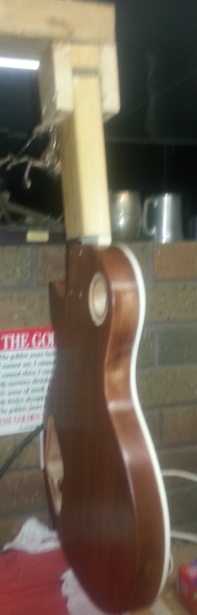

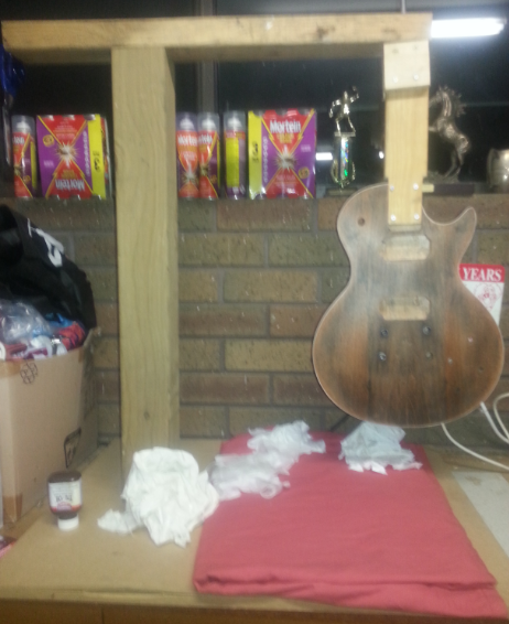

    Anyway, here is a pic of this thing I just built to help with drying, applying stains and finishes. It's 360 rotation and will will work for all my future builds. Works for me in the fact it's portable. (Please note I have no experience with woodworking but I gave it a go haha).

    Hi Buddy, like the look of the finishing rotisserie. Reminds me of a kebab shop haha.
    Be careful not to apply too much as hanging vertically will naturally cause runs if coats have been overloaded. Suggest at least 6 or maybe 8 coats of TO before first sand back with 0000 steel wool or fine grade wet and dry as the layers are so thin and very easy to sand things back to bare wood without realising it. The upside is you can put another coat on after 6 - 8 hours depending on how warm the drying environment might be. On some of mine I would put a coat on in the morning before leaving for work and another upon arriving back home before settling down for an evening meal.
    Whilst there are many more coats it does take around 3 weeks at least to finish things off properly as you will need to sand it back at least 2 or maybe 3 times before the final wet sand and applying the car polish if you are chasing that super shiny glassy look. Best to leave it for at least a week or more for the very final coats to harden up ahead of the final wet sand and polish.

    Hahaha a rotisserie you say. I don't think I'll eat whats cooking though haha. The fireplace might if I don't get this one right haha.
    I have applied the oil onto the lint free rag and carefully applied it onto the guitar and neck. Seems to be working quite well and no run off.
    Ok so I read your comments and understand, several coats to go before sanding back.
    What wet and dry fine grade should I be using?
    Also the car polish. What should I use?
    I really want that super shiny finish and understand it takes time.
    It may need longer drying time. That kebab machine is in the garage and it gets down close to zero sometimes.
    Anyway, here's the rotisserie with a second coat on the body haha. Starting to shine already.
