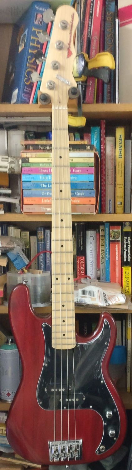

    Not perfect, but the finish is as flat, shiny and hard as I am going to get it. So, I assembled it...
    I already have the first tiny ding in it. Brite Tone is definitely harder than the first finish I put on, but it won't completely protect the bass from getting dented. That said, I do love the grain. It will, for sure, be my lightest bass. Completely assembled it came in at 6.5 lbs/3 kg. That's about like my poplar strat-ish guitar, and close to a kilo less than my swamp ash Fender P-bass. For those who thought there might be some neck-dive...you were right. It's not severe, and is about the same as my Fender. I think it helped to use the Hipshot ultralites and to make the headstock a bit smaller than a standard p-bass.
    Since the pic, I have taken the strings, pickguard and pickup off so that I can install shielding and attach the bridge ground to the wiring harness. I am also gluing in a few strips of lamination where one of the pickguard screw holes was slightly over the route.
    So there is a little more to do, including all the setup...but it is starting to look and feel like a bass ;-)

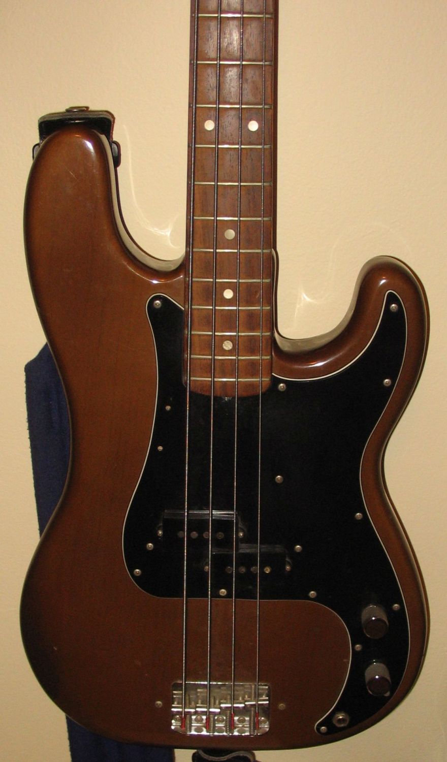

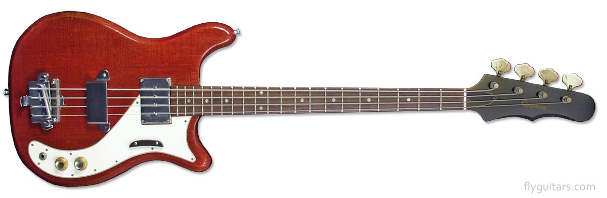

    I wanted this bass to be a sort of lighter replacement for the p-bass I bought when I was 19 and the Epiphone Newport that I had from the time I was 13 until I sold it to buy the Precision. It feels like a bit of an tribute to those two basses.

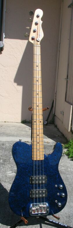

    I realize the neck is maple, but I am not unhappy with it. there is an eye in the back that has a cool chatoyance. The neck also reminds me of my ASAT bass, which has the best feeling neck of any bass I have ever put my hands on.
    If the paulownia bass serves me half as well as any of these, it'll be a great addition to the family.
