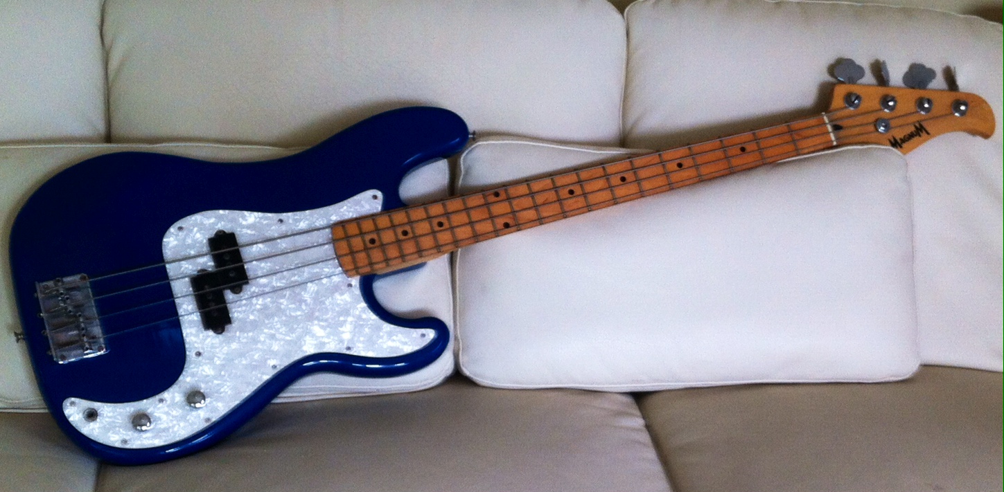

    My youngest son has a couple of cheap Korean made F style Magnum guitars that possibly date back to late 80's for the P Bass and mid 90's for the Strat.
    Stock hardware on the Bass is OK whilst rubbish on the Strat where I have replaced and/or modified many things over the past 10 - 15 years or so.
    Not much work done on the Bass other than new strings, intonation, and the pearloid pick guard several years ago. Recently discovered tone pot was frozen and also no signal so time to check things out.
    With upgrading many parts on current PBG builds I have ended up with a few spare parts and decided to use Junior's axes to try some of them out.
    For this Bass I had a choice of 2 x A500k pots and 3 x B500k pots and was surprised at the variance in resistance. Both A's read around 470k to 480k whilst the B's ranged from 508k up to 520k so I picked an A & B with the closest readings for the refurb. Also had a fresh jack hanging around which was stereo and a spare 0.047 Orange Drop Cap. Here are some shots before changes were made>

    Not surprised why there was no signal as I found a wire broken between tone and volume pots which may have possibly been part of the grounding loop too.
    Looked everywhere for basic P Bass wiring diagrams and there are S@#$loads of mods on the net but so hard to find the simple original and ended up using about 4 different ones pinching a bit from here and there and also referencing back to the parts being replaced in this guitar as that proved to be the best way to go after discovering an earthing problem on the volume knob after first attempt.
    Corrosion was evident all over the old parts and the original wires were so thin I had to scrap them all except for wires coming from PUP's. Kept the Earth wire too as it was much thicker than the rest. First tricky bit was doing the stereo jack and after studying it for a couple of minutes eventually figured out which posts to use. Would have used Mono if I had a suitable spare but makes no difference in the end.
    Here are some shots after completing and testing the circuit for a signal.
Name:	photo 6 (After).jpg
ID:	8364Click image for larger version.
Name:	photo 7 (After).jpg
    Plugged it in and sounds good for a budget end axe. Hard to recall what it sounded like before but at least it works now with no buzzing or earth shorting sounds. At least the tone knob now makes a difference whereas before it was permanently on 10.
