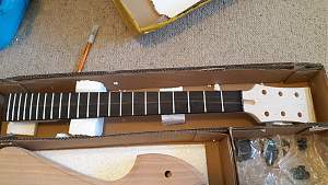

    I did talk to Adam, and I got my kit customised too. So we've got a Mahogany body, Ebony fretboard, black hardware, and no inlays (but I will be looking in to getting some Sharkfins added at a later date).
    There are a couple of little gripes I have with the kit, the neck pocket is on the large side, asking for no inlays resulted in no side dots, and the glue joins in the body are a little thick. Of course all of these can be worked around (well the glue will just be painted over so no visual damage done there) but it does add a bit more work to it.

Name:	003 Neck (Custom).jpg

    Super interested to see how this all turns out, there's been a number of MB diaries pop up lately and its always been a body style I found appealing. I shall follow intently!
    Yes! Another build with a really unique twist! I love these knes, and I cannot wait to see your dream become a reality. Looking real nice so far.
