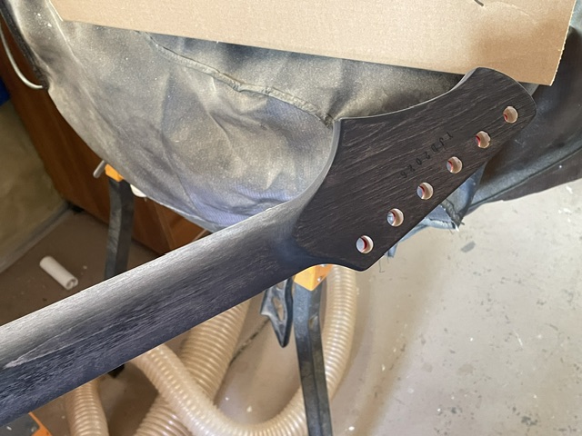

    Added a stamped "serial number" to the back of the headstock.

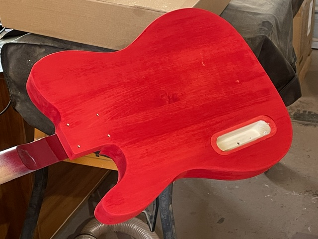

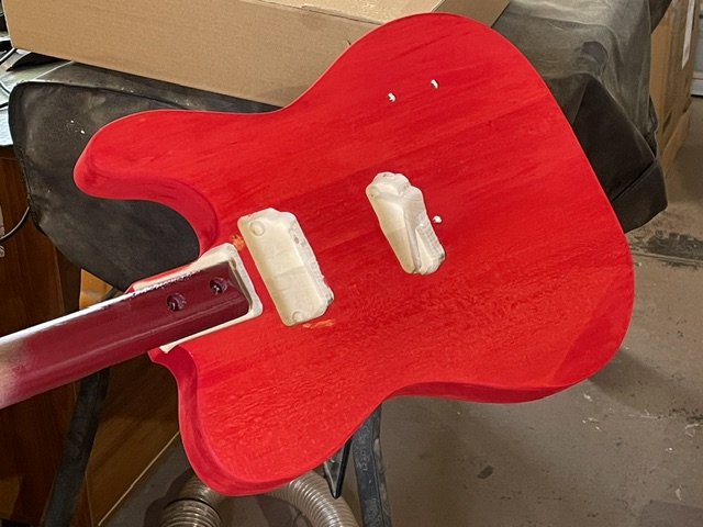

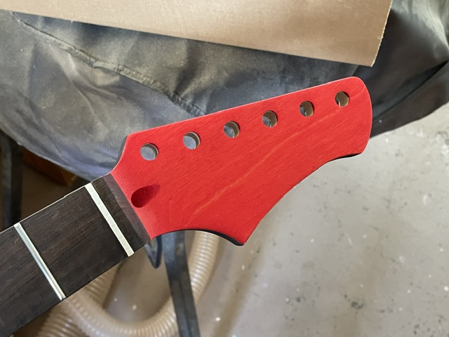

    Added a coat of Ubeaut sanding sealer, waited to dry and then denibbed with 600 g paper. The added 2 coats of Ubeaut red water-based dye diluted to about 60%. Also did the same to the headstock. The back of the neck is Feast Watson black stain.
    There were a couple of glue marks on the body which will be covered by the pickguard.
