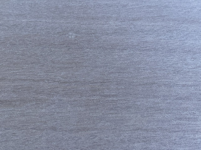

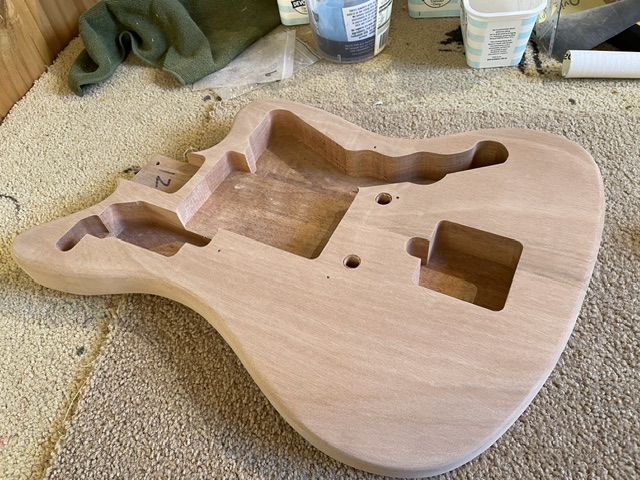

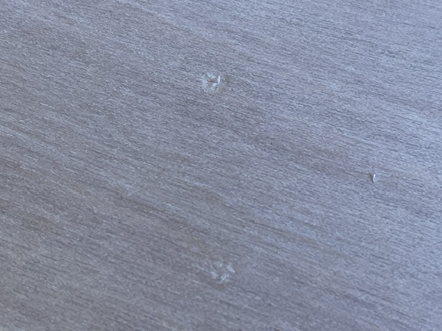

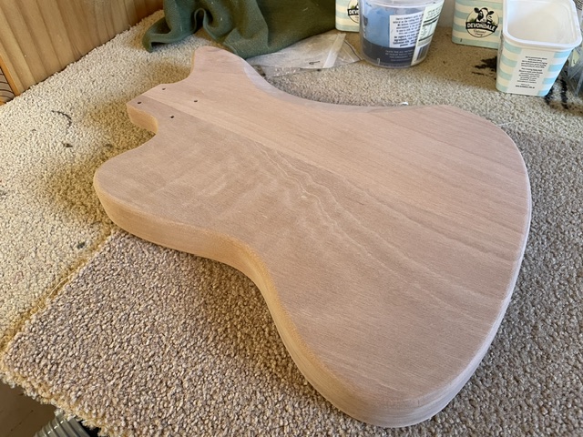

    Sanded the body from 180 g to 240 g. Also, noticed a couple of dents in the back, so used the soldering iron with a damp cloth to fix them up. I'm always amazed at how well this process works. The body also looks like it will have a nice shimmer when the clear coats are added - fingers crossed!
