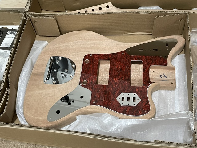

    I have been very lucky and scored an old Pitbull GJM-1 kit. Mahogany body and neck, red tortoise shell pickguard and chrome control and switch plates. I have purchased some Tonerider Hot P90's. At the moment my intention is to use a jarrah stain with a black burst. I'm a little undecided how I will do the electronics - but that is a problem for later.

    Wow! That's a beaut! Nice score!

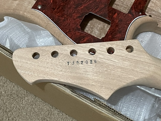

    Today I have shaped the headstock and sanded the neck up to 240 g.

    I have added a stamped "serial number" to the back of the headstock. This has been filled with Timbermate ebony wood filler and sanded back to 240g.
    Also removed the protective plastic covers on the chrome plates and gave the plates a good polish.
