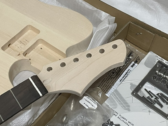

    I have also managed to get hold of a TL-1 custom where the control cavity is on the back of the body. Basswood body and maple neck with a Rosewood fretboard. I also picked up a Babicz Tele Humbucker bridge in nickel. and some Klucson nickel tuners. I'm thinking a cherry burst finish for the front and stained black for the back and neck. As a side project I have also purchased a slab of walnut which I may use to make a tele body.

    Thanks fender3x.
    I do have a spare Tonerider Birmingham!? I may not worry about the neck pup. But maybe a coil split. I have never had Kluson's before, but they are the vintage style with the oval knobs.
    As for the fur coat - it is quite cool in Perth, but not cool enough!

    I have changed the nut to a bone nut and sanded the base to a good starting height for the slots. Filed the fret ends. Adjusted the truss rod to get a flat fretboard, levelled the frets, checked the frets using a fret rocker, filed the high frets, crowned the frets using the music nomad file, sanded the frets with 600 g and 1200 g wet/dry in the groove of the crowing file, polished frets with 0000 steel wool and polished frets with a polishing wheel on a Dremel.
    Note to self: Don't do 2 necks at the same time!
    2,007
    Similar to Jag. Shaped the headstock and sanded the neck to 240 g.
