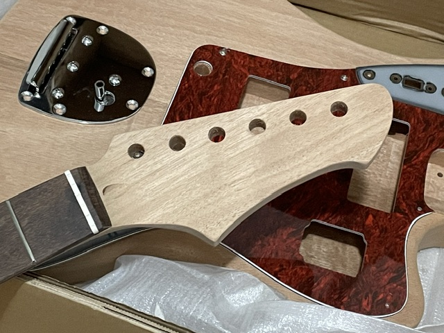

    I have been very lucky and scored an old Pitbull GJM-1 kit. Mahogany body and neck, red tortoise shell pickguard and chrome control and switch plates. I have purchased some Tonerider Hot P90's. At the moment my intention is to use a jarrah stain with a black burst. I'm a little undecided how I will do the electronics - but that is a problem for later.

    Wow! That's a beaut! Nice score!

    I have changed the nut to a bone nut and sanded the base to a good starting height for the slots. Filed the fret ends. Adjusted the truss rod to get a flat fretboard, levelled the frets, checked the frets using a fret rocker, filed the high frets, crowned the frets using the music nomad file, sanded the frets with 600 g and 1200 g wet/dry in the groove of the crowing file, polished frets with 0000 steel wool and polished frets with a polishing wheel on a Dremel.
    I may be getting better at this process!
    3,071
    You nearly have a factory going ;-)

    Yes, sometimes it does feel like it.
    Today I have shaped the headstock and sanded the neck up to 240 g.
