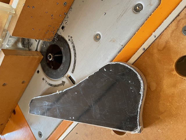

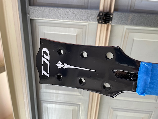

    Added my logo using a vinyl sticker cut with a Cricut machine. Then gave the headstock another coat of poly (this may be the last spraying opportunity until next spring as the temperature here is dropping to low 20's (and high humidity)).

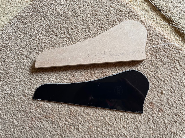

    Also created a 3-ply pickguard. I made an MDF template and then used the router table with a pattern following bit to cut the pickguard. Also added a 30 degree camber to the edge.
