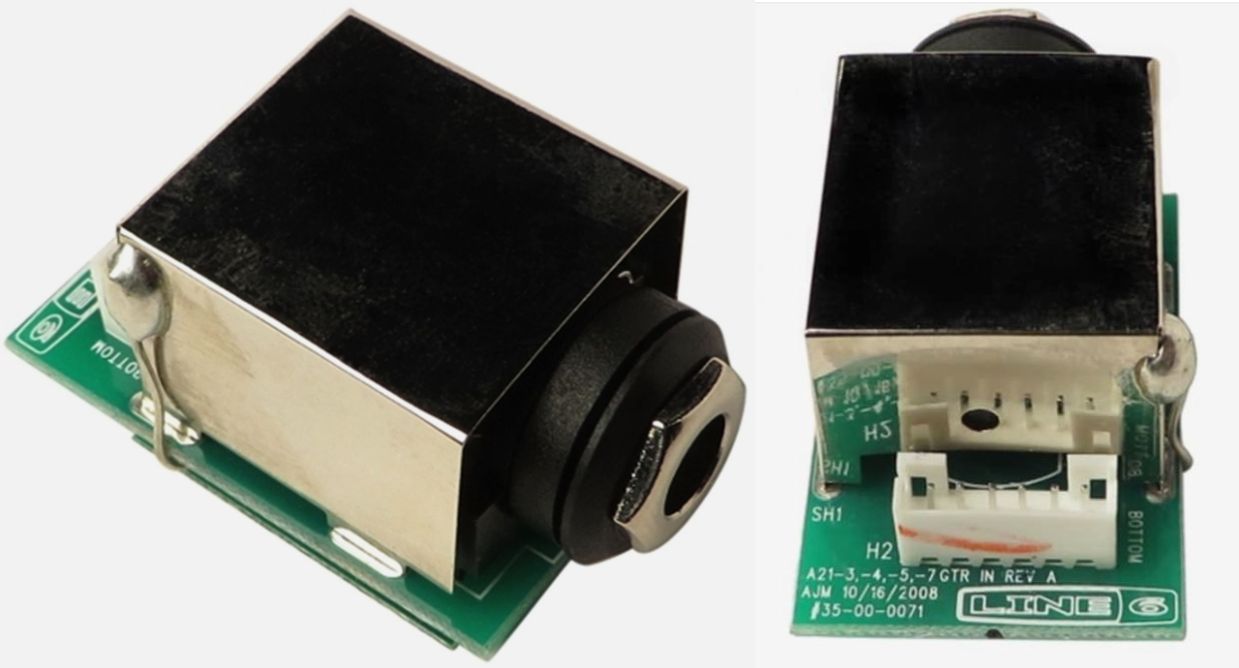

    On an old amp, the jack would look a lot like the one on your guitar. Those are relatively easy and straightforward to replace. On an amp made in the last...maybe 20 years?...it's probably mostly on a circuit board, and that includes your Line 6. I googled it, and there may be some variations depending on the time of issue, but I think it will have an input jack that looks a bit like this:
    If so you won't be able to see the tip-connector, because it's inside a housing and not meant to be disassembled. The good news is that if it's easy to get to it should be easy to replace. Here's a video of a guy doing it:
