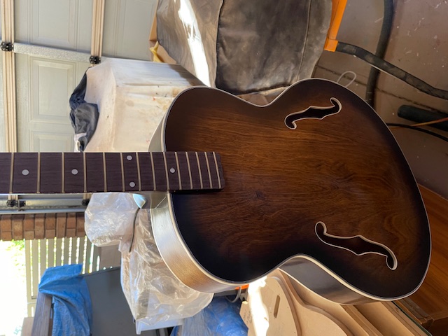

    0One lesson I did learn today - after getting dust falling onto the wet finish - is that the cavity needs to free of dust and binding shavings, otherwise the air pressure from the spray gun going into one f-hole will blow rubbish out the other f-hole! Live and learn.
    Can't see the dusty bits from here. Still looks great! I would not have thought of that as a potential issue. That probably explains why I end up learning things the hard way so often.

    Today I gave the body and neck a light sand with 1500g paper. Then gave everything a few sprayed coats of Cabots water-based satin polyurethane. Now I let it rest a bit more!

    Today I have glued on the neck.

    There was a small gap around the neck to body joint. So, I have sprayed the joint area with a few coats of finish.

    Very classic look!
